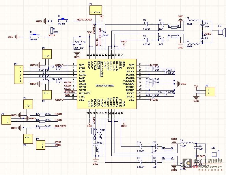

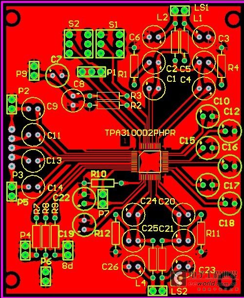

I found these - thought they might be useful to the Class D fraternity.
  • MP3100_fin.zip
This sure is an unexpected and also generous gesture ! Thank you. Do you also have a BOM/parts list ?
For those who don't know: these files can be sent to a board house and you can have the Masterkit boards made exactly the same as the ones in the pictures. This is only interesting if you have more than 1 produced. Starting costs are the same whether you have 1 produced or 100.
