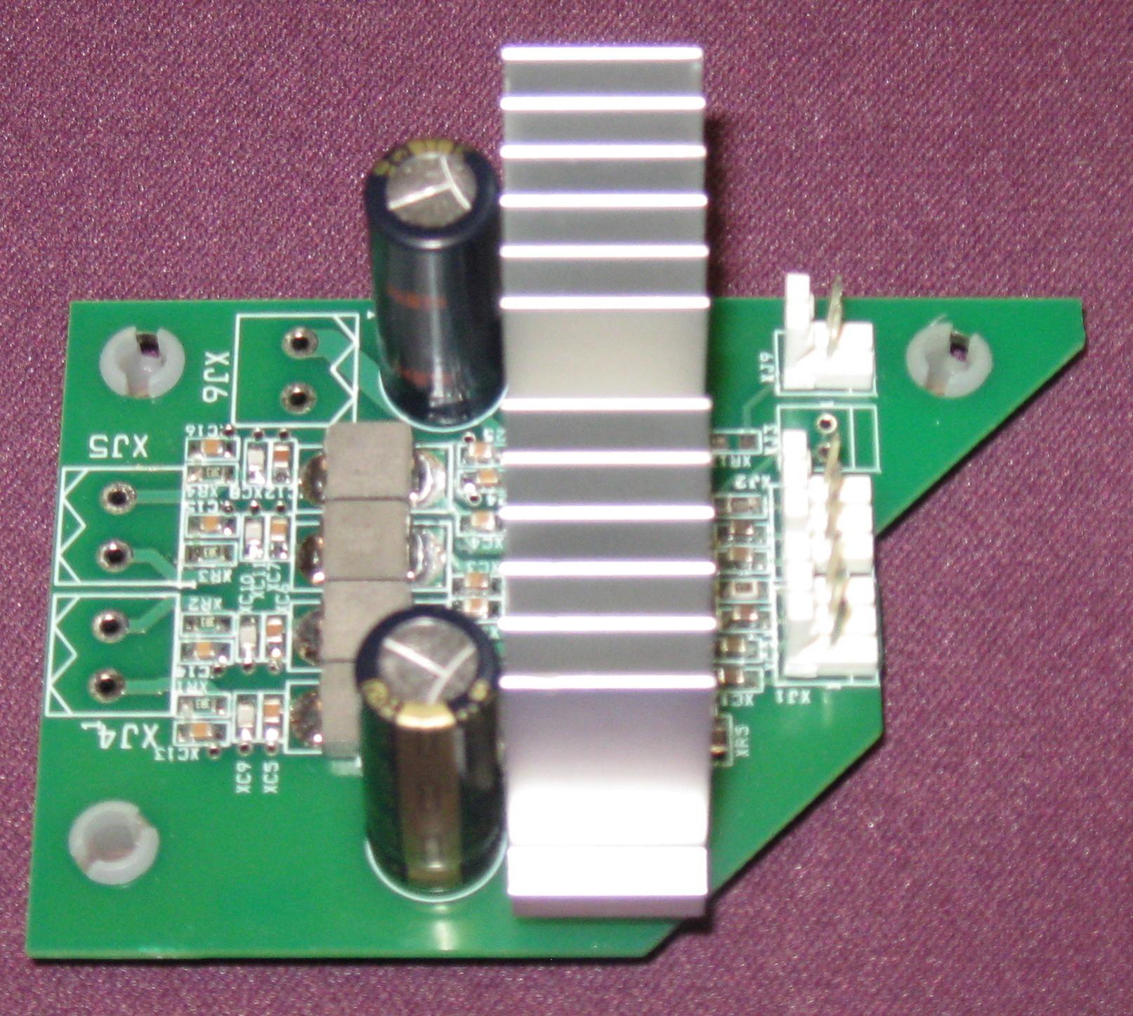

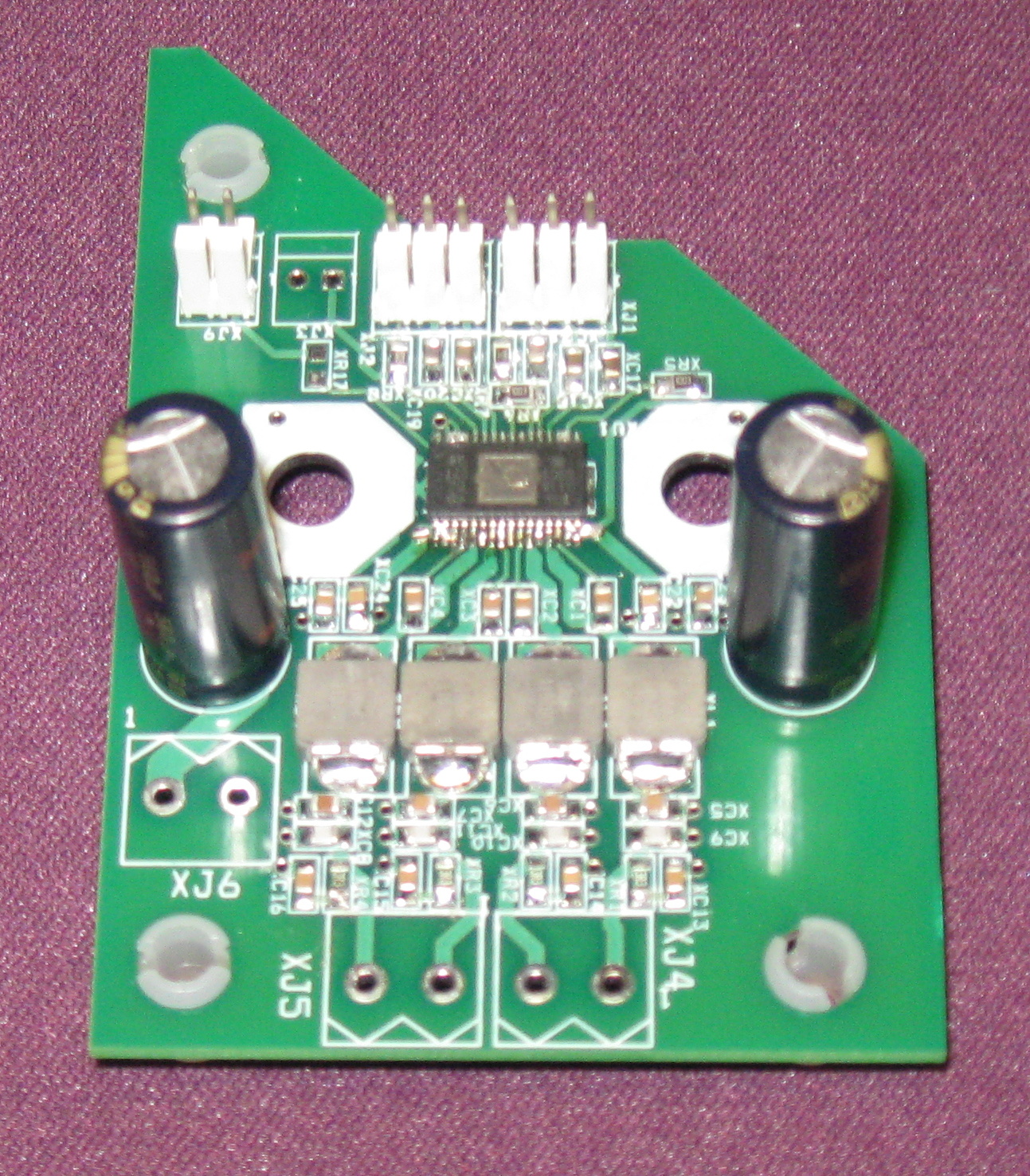

Dug,
Those little amps look great! Did you make the boards yourself? I just ordered the TPA3118D2 chips and will need to figure out how to mount it with no board. I also have the 3116D2, 3130D2 and they came today. Boy they are small! I am just reading up on SMD soldering techniques. It's a little intimidating for someone who has only made thru hole circuits in the past.
TI's circuit straight from the data sheet.
My board design, my soldering (by hand)
Small secret (not now though): I made a clamp to hold them in place before soldering.
That way the heat sink does not stress them when installed and they don't move when being soldered.
Use magnifying goggles, a very small soldering iron tip, thin solder, and liquid flux.
