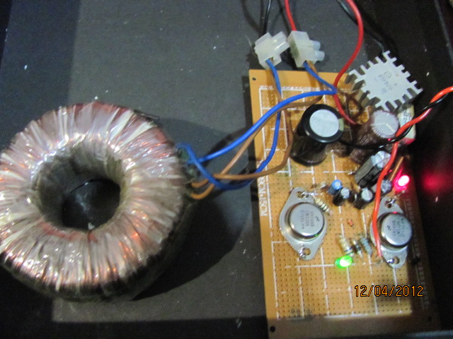

I recently build a linear regulated power supply based on this circuit from Just one thing about music - when it hits you feel no pain . I use the 3 pin regulator part 4 description and replace lm318 with lm338 . The trans is about 250 W , 22V ac out . There is a snubber of 0.47r + 47 UF at the output of the regulated supply -- this is the value based on the circuit for regulated gainclones by Carlos FM.
the sound is more tube like and holographic when compared to smps laptop power supply.
cheers

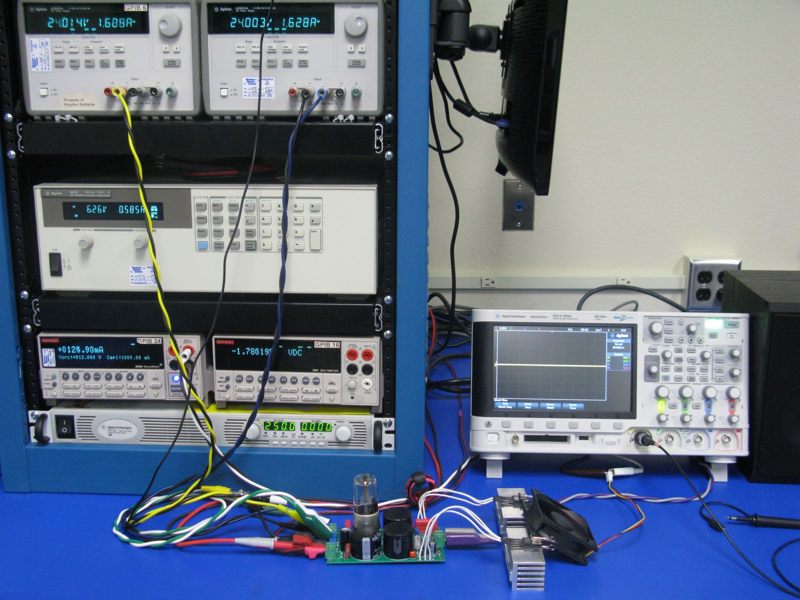

I don't design or build anything, just senior test monkey...
I tested your board to TI procedure after it was assembled.
This is what my desk looks like, with one of my own amps.
Chinese triode, obviously not a TI amp in this picture.
Actually, this is my High Voltage test station, not AP2722.
Your board would have tested at a different workstation.
