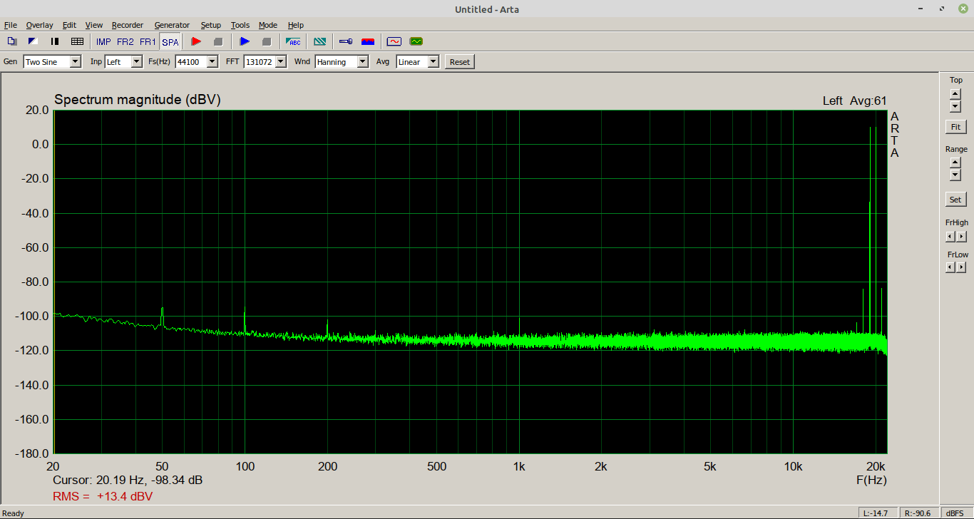

That’s still 28dB worse. And what’s the power level of the amp at 1%THD+N/4R?So I measured my A/B latFET amp for comparison. I would say it is in the ballpark of the purify. Whereas the resolution limits of my measuring setup become visible...
Let’s not forget that the Purifi is a 450w amp at 1% THD+N/4R
In a true academic overkill design better results would likely be possible. Like bridge-paralleling dozens of ADA4870-based ultra-high loop-gain composites ;-)Why? No class A or AB amps perform better than the Purifi’s.
I agreed if you say that no high-power class A or class AB amps are measured better than Purifi. But, if I only want say 5W or less. I think one can do better than Purifi. Not sure if it will be cheaper than Purifi, however.Why? No class A or AB amps perform better than the Purifi’s.

I haven't seen any 5W or less amps that measure better. And if they did, somewhere else between the digital storage medium and the amplifier would likely become the weak link.I agreed if you say that no high-power class A or class AB amps are measured better than Purifi. But, if I only want say 5W or less. I think one can do better than Purifi. Not sure if it will be cheaper than Purifi, however.
