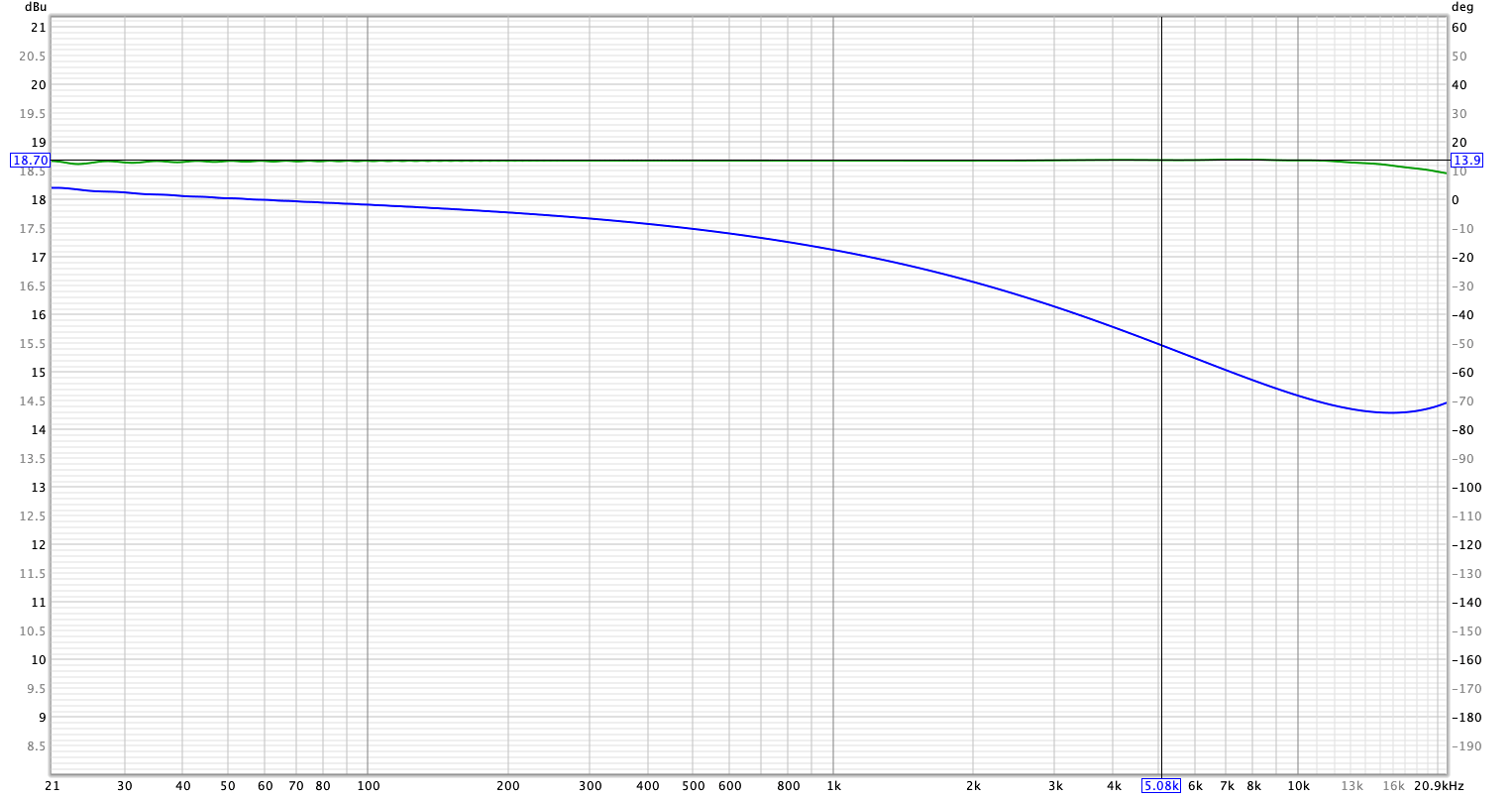

[ I think your 6º at 20khz requirement is way too restrictive! Here's PA5 frequency/phase response (phase in blue, lower trace) ]

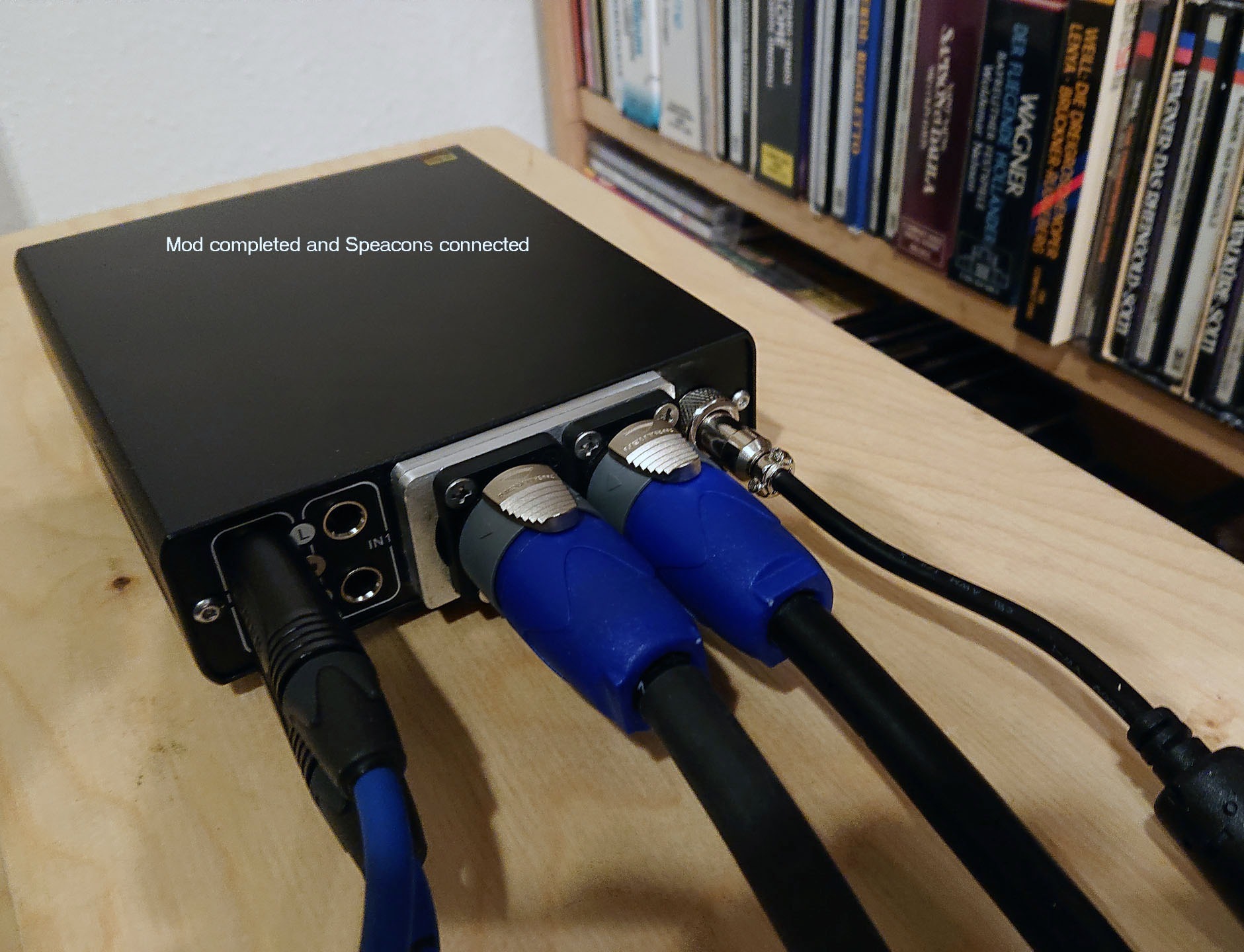

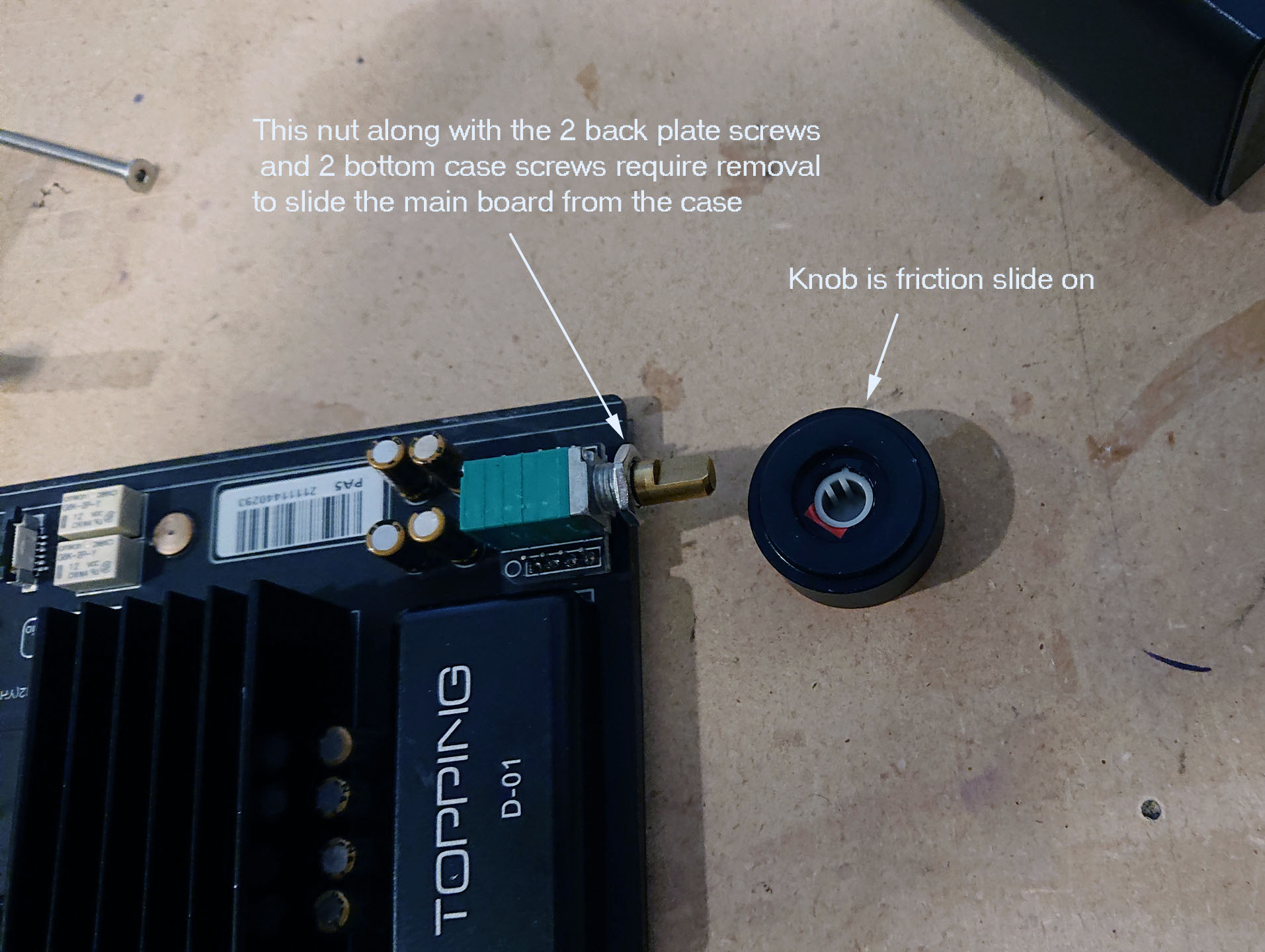

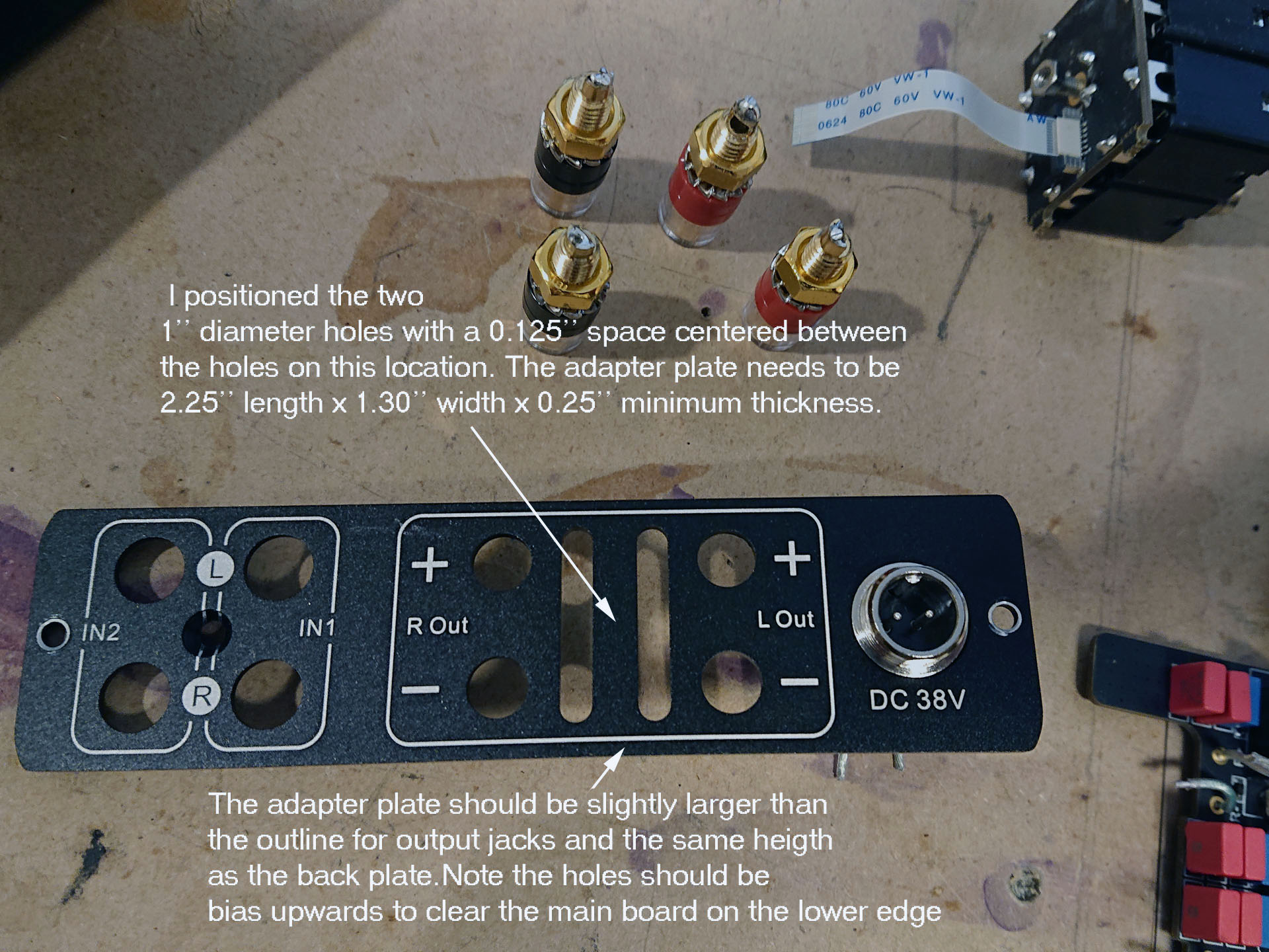

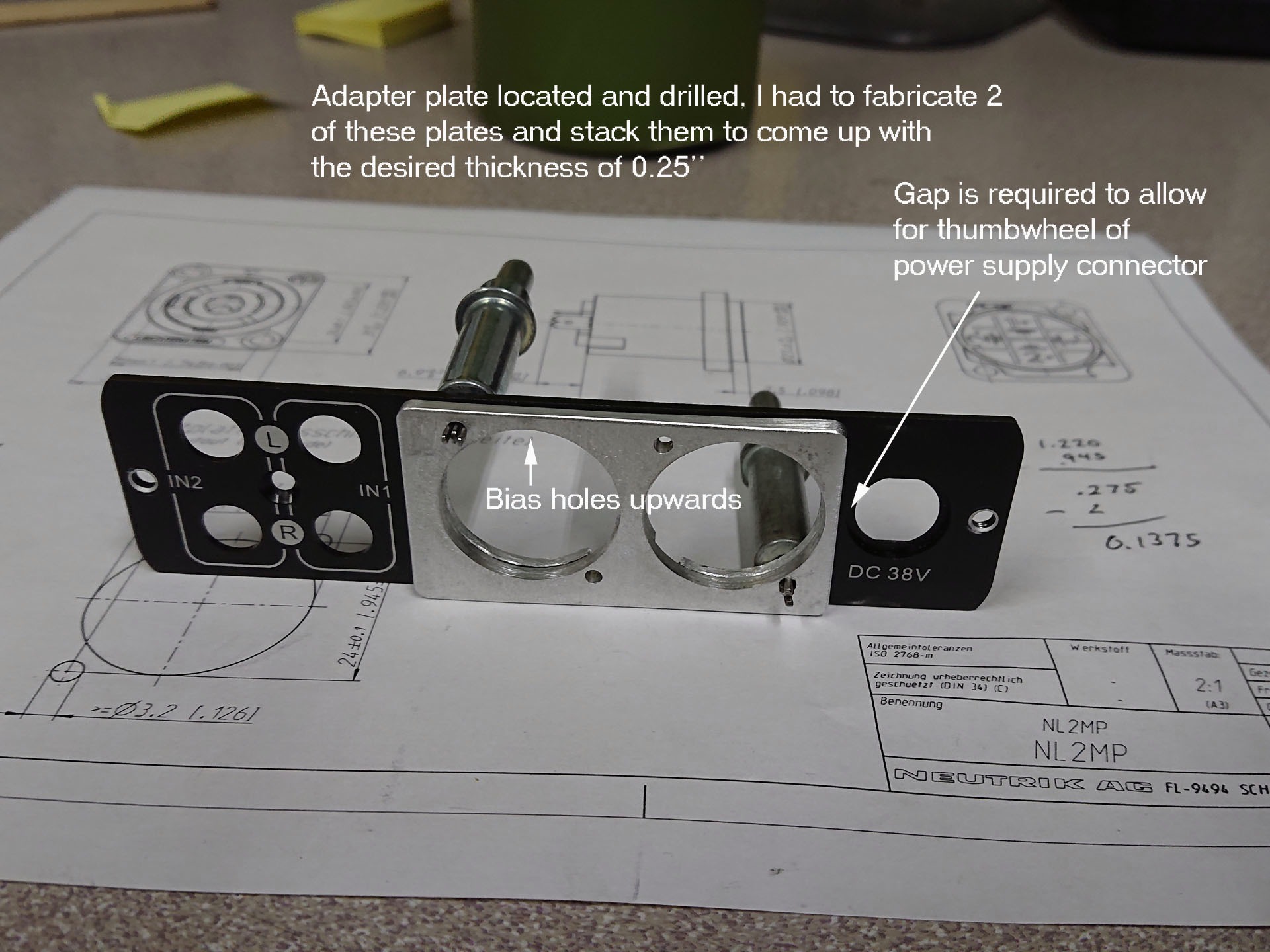

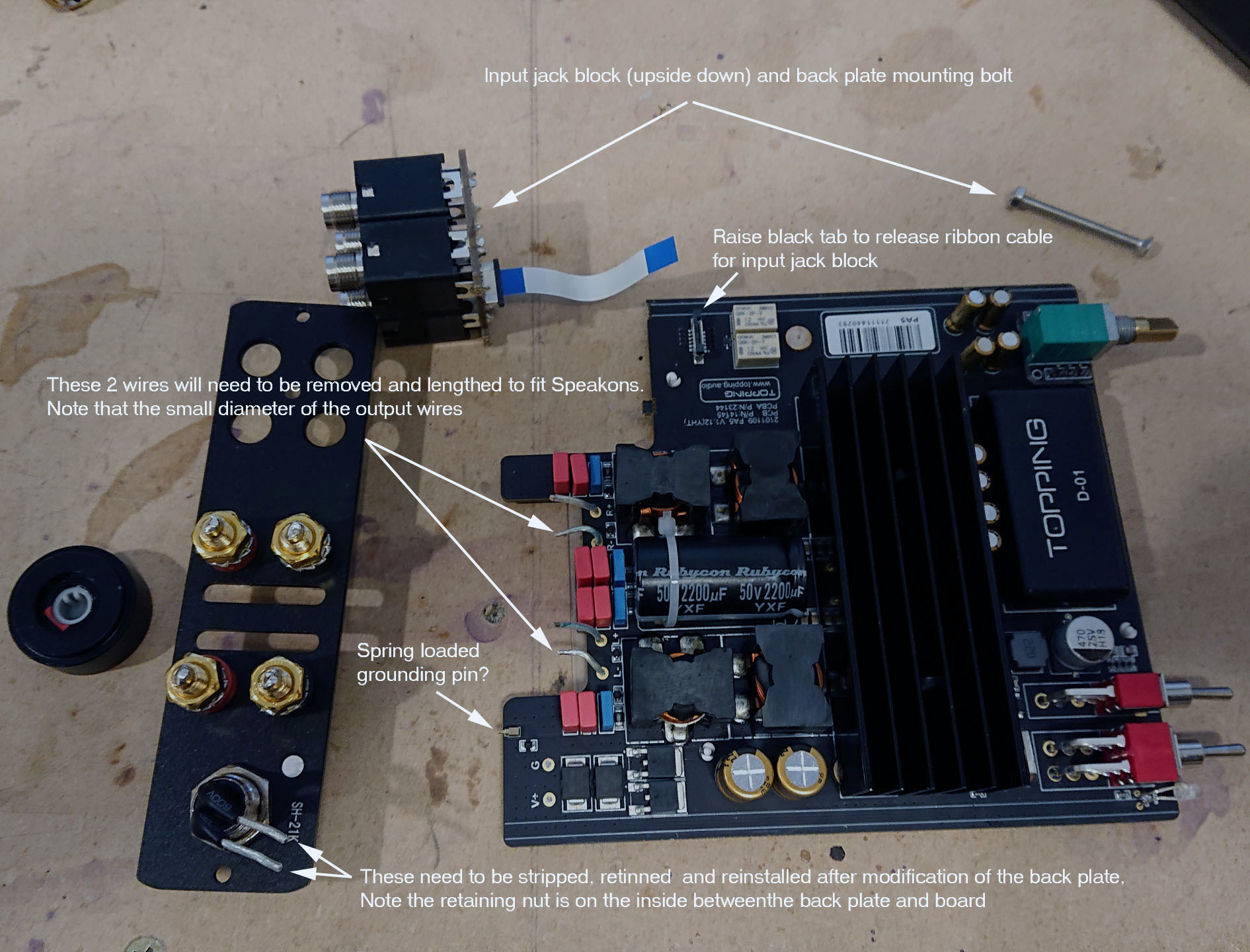

I find the PA5 to be a bit of an odd duck with pro audio balance inputs and consumer level small 5 way binding post outputs. Upon receiving mine I found foremost reaction was the replacing the later with Speakons as the amp was to be used whenever, wherever and my history with binding posts have relegated them to the ash heap upon discovering Speakons. The following are my experience replacing the binding posts.
