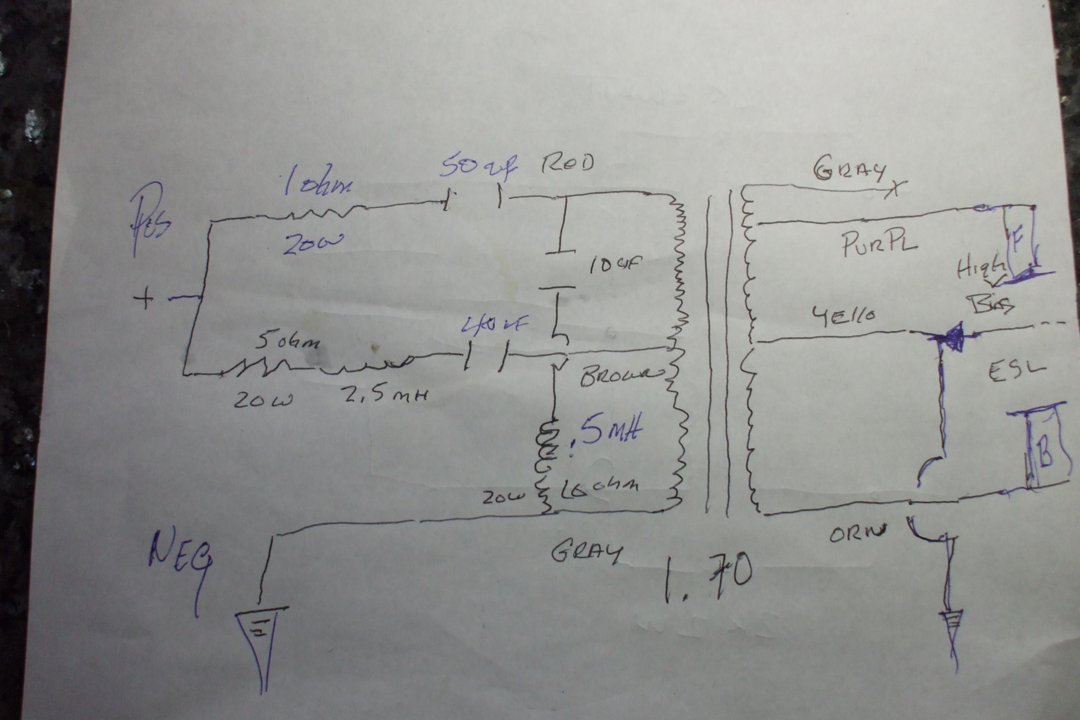

This is the panel crossover setup i am use now.....this come from ML thay use all the same stepup transfourmers in....
SL3, request,Ascent, Ascent i ,Odyssey, All these use the same panel....12'X48" Prodigy uses two of the same tranfourmers... pr panel 16"X48"....
ML uses a diff crossover in each...
Do you think i can setup the Antek AN-0506 this way....i know it well be diff but should work right.....this is the best sounding crossover setup type yet...i have even used....For give the Art....
Its also in my Acoustats 121 interface...with the ML tranfourmers...
thanks for any input

Yes, You can set them up that way.
But, it doesn't say that they will perform the same way as the ML transformer as the transformer will have a different set of characteristics and parameters than ML's transformers.
I would be a nice experiment to try though.
If you do chose to try it, let us know the outcome!!

This centerTap type crossover setup got MartinLogan the MId-range of the year in the Quest-request.
I thought it was the biger panel.... but it works well in 12" wide panels ...or any size well .....killer Mid...an topend...it just uses more of the tranfourmers windings....as input to the panels ....tone shaping...vary cool...something you dont see on other ESLs...Why ask why...
I gess it like the Bias... some think it dose not help the sound to have the best bias caps-diodes you can........i just wont it all.....
Have As much fun as you can.....MX
