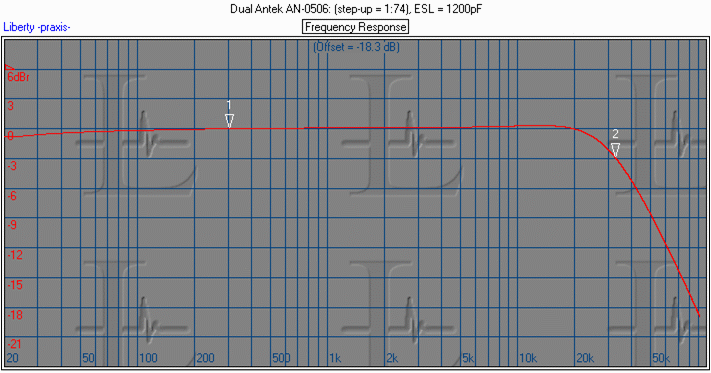

Here are the original scope picture of the frequency response of my cores.
It is very flat and again the roll off at either end was found to be that of the amp itself.

See, that just doesn't make sense because it takes a lot of effort to make a standard audio transformer have a nominally flat response to 60-75kHz. To get one to go all the way to 100kHz or above is extraordinary and doesn't just randomly happen. Certainly not with your average toroidal power transformer. So, something is going on here that at least isn't exactly clear to me, i've tried to read through some of the linked posts but can't yet determine what was done that would account for the apparently extraordinary results.
Just to clarify, you are taking a step down stock power toroidal transformer and feeding the test signal into the 120vac primary and looking at the lower voltage output?? No load?
Yes, this is correct.
At the time I had done this study I had little knowledge of transformers other than different core material types and transformation ratios.
The effects of Leakage inductance and self capacitance was new ground for me.
Also the importance of the load resistance I was aware of but didn't realize how much it meant under certain conditions.
This I learned more about as I dug deeper into the situation.
My findings are such that the core size and number of primary turns determines the lowest frequency of operation as per peak input voltage and is true for all transformers.
And the self capacitance along with the leakage inductance determines the resonate frequency of the transformer and you want to stay away from that range although added some resistance to dampen this resonance is common practice.

I’ll take a stab at describing why simplex wound power toroids provide extended HF response when driving hybrid ESLs, while much effort is needed to do the same in tube amplifiers. It basically boils down to two major differences:
1) ESL step up transformers are driven from low impedance sources while tube amp transformers are driven by relatively high impedances sources.
2) For hybrid ESL use, the required LF bandwidth is limited to 200-300Hz while transformers for tube amplifiers generally need to handle another 2-3 octaves.
These two major differences allow the use of significantly lower number of primary turns, because:
1) Low impedance drive allows the use of much lower primary inductance since the voltage applied to the primary will not be modulated by voltage drop across the source impedance due to current that varies with frequency and load. Low impedance drive results in flat low distortion voltage response applied to the primary of the transformer even with widely varying current from impedance variations and core related loads. For reference, the Antek AN-0506 has a primary inductance of only about 15mH.
2) Since the LF bandwidth is limited to 200-300Hz, lower number of primary turns can be used while retaining adequate power handling before core saturation.
Reducing primary turns is very beneficial as leakage inductance is proportional to number of primary turns squared. So reducing the primary turns results in significant gains in HF bandwidth. Leakage inductance is also inversely proportional to the length of the winding, so longer winding is better. In the case of the toroid, it’s core shape allows a given number of turns to be spread over 4-6 times the length as for an EI core with the same core area. This is why simplex wound toroidal power transformers are useable for ESL step-up but simplex wound EI power transformers are not.
Now I’m not sure about the 100Khz+ bandwidth that was mentioned, I believe that was a test with only a 10 turn primary which significantly reduced the power handling capability. For the Antek AN-0506, the 6V windings have 44 turns and provide enough power handling capability for hybrid ESLs crossed in the 200-300Hz range.
Attachment #1 shows the response using two of the AN-0506 connected as described below driving a 1200pF panel.
With no load, bandwidth was 47kHz.
