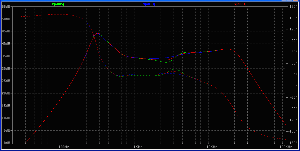

I did try a 300 Hz passive 2nd order crossover with the Antek and it worked well, no signs of core related distortion.

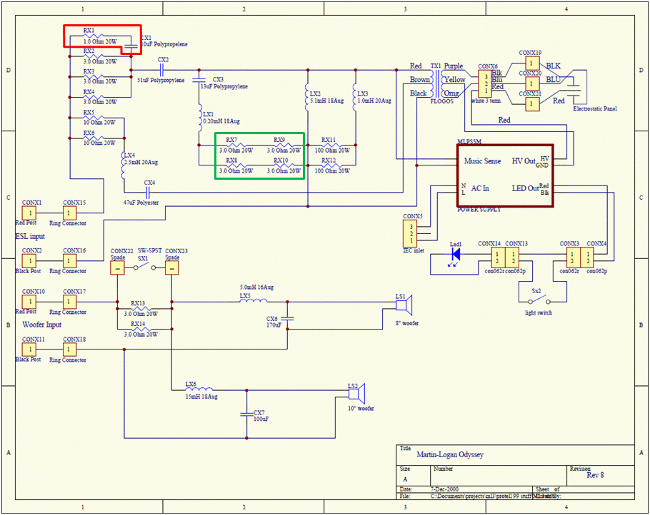

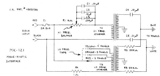

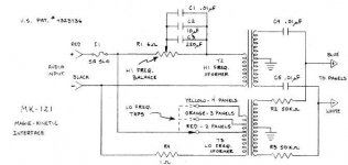

This is the panel crossover setup i am use now.....this come from ML. Do you think i can setup the Antek AN-0506 this way.
You could use two Antek's to do something similar, but the step-up ratio would only be about half of the ML transformer.
I redrew you crossover in Figure (A) Did I get it correct?
Can you tell me what ML model this is for?
All of the ML crossovers I have seen or worked on included an inductor across whole or part of the primary as shown in Figure (B) & (C) to provide a stable inductance for the high-pass crossover to work with. Sometimes there was a resistor in series with the inductor.
Does your crossover have such an inductor?

A. is right...it was a mix i came up with... for the SL3 An Ascent ...the Re-qust an the Odyssey...parts i had on hand. All there tranfourmers are the same but for the re-qust.
The Proidgy uses two pr speaker....like the Xfourmer SL3 an other... i do not get the inducters?? the Sl3s an the Ascent have the inducters on the centap of the primary...i thought it was to set the stepup xfourmers to just use 1/2 the windings...but if i run the center tap to the neg input only...i get less output....?? Can you tell me what adding the 1ohm dose to the inducker...flotet more.. give even more output???
For me on these ML crossover one clools thing i got was the Zobel thay came up with for the Res...Vary cool i never saw that befor an it works great!.....

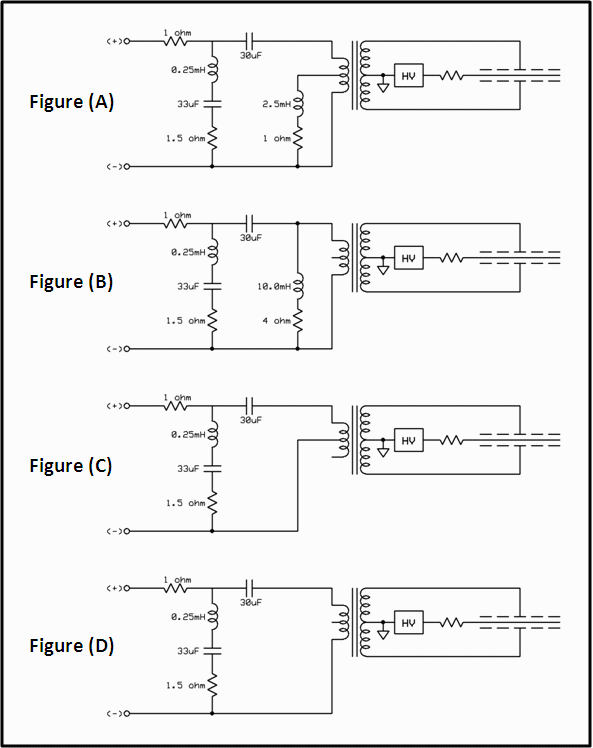

That's a lot of questions on the ML SL3 crossover. I'll see if I can answer them.
1) What is the purpose of the 2.5mH inductor connected to the CT of the primary?
Looking at Figure (A) you can see that the (2.5mH + 1ohm) is connected across half of the primary turns. By transformer action, the impedance seen by the crossover network will be that of a (10mH + 4ohm) network. In fact Figure (B) is electrically identical and produces the same response and load impedance. It is a common arrangement for ESL hybrid passive crossovers.
So, why did ML bother with the CT loading? Perhaps it comes down to $.
A 2.5mH inductor is cheaper and smaller than a 10mH.
2) Why doesn’t connecting the CT to ground result in higher output?
Figure (C) shows this arrangement. Since the number of primary turns were halved, the step-up ratio would be doubled so it would make sense to expect higher output. But, halving the primary turns reduces the impedance the transformer loads the crossover with by a factor of 4! To get the expected higher output, you would need to change the 1ohm resistor to 0.25ohm, and the 30uF capacitor with a 120uF capacitor. This would give you higher output if your amplifier could handle the resulting impedance that now dips below 1ohm in the midrange.

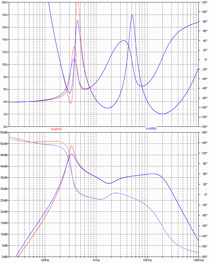

3) What happens when I remove the 1ohm resistor in series with the 2.5mH going to the CT?
Attachment #2 shows a comparison of response and impedance with and without the 1 ohm resistor. The Blue curve is with the 1 ohm resistor. You can see that removing the resistor boosts the output above the 300Hz crossover by about 3dB. At this same frequency, impedance drops by 2 ohm to just under 4 ohm.
4) What happens when I completely remove the 2.5mH inductor from the circuit?
Figure (D) shows this arrangement. Without any inductor, the load seen by the crossover at lower frequencies is mainly defined by the primary inductance which changes with signal level. In general you will probably be playing the panel lower than the 300Hz crossover, but will not have the proper equalization above crossover.
5) Can the Antek transformers by used with the SL3 crossover?
Yes, if you use Figure (B) you would have nearly the same step-up ratio and response as ML.
Of course you would probably need to tweak component values to compensate for differences in transformer inductance and parasitics.

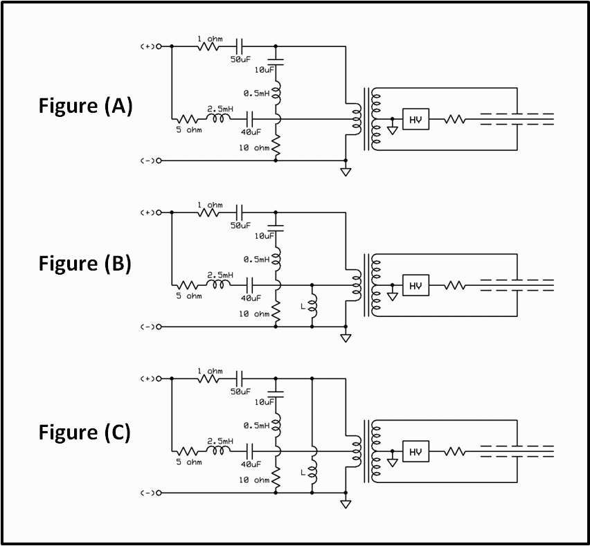

The Odyssey crossover is basically a tweak of the SL3 crossover arrangement shown in Figure (B) from post#46.
A lot of added complexity for what may be a small audible improvement.

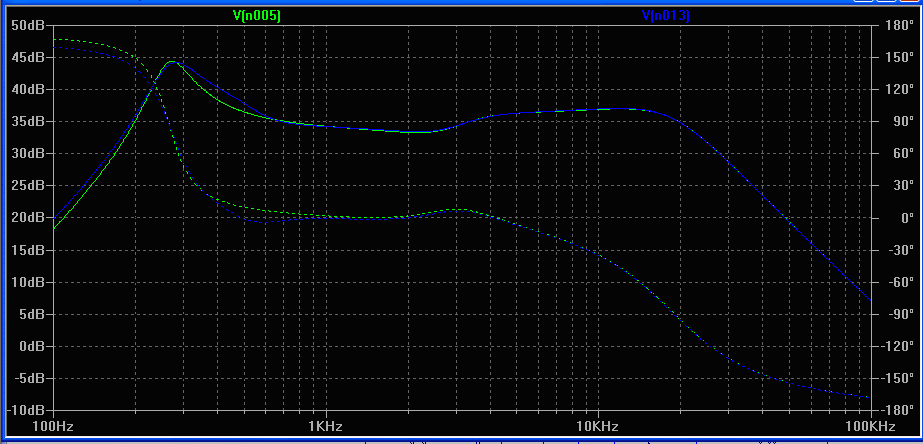

Driving the center-tap with a series RLC network fills in the dip in the response just above crossover providing a more linear equalization of the dipole roll off in the 300Hz - 600Hz range. There is quite a bit of interaction between the CT drive and the main drive signals, so a lot of modeling and measuring went in to optimizing the parts values.
Attachment shows simulated response with and without the center tap drive connected.
Blue = with CT drive

The 1ohm-10uF network your mentioned(red box on schematic) is a shelving network for the top octave.
Attachment #2 shows response trends for CX1 values of 10uF, 5uF, 2uF.
