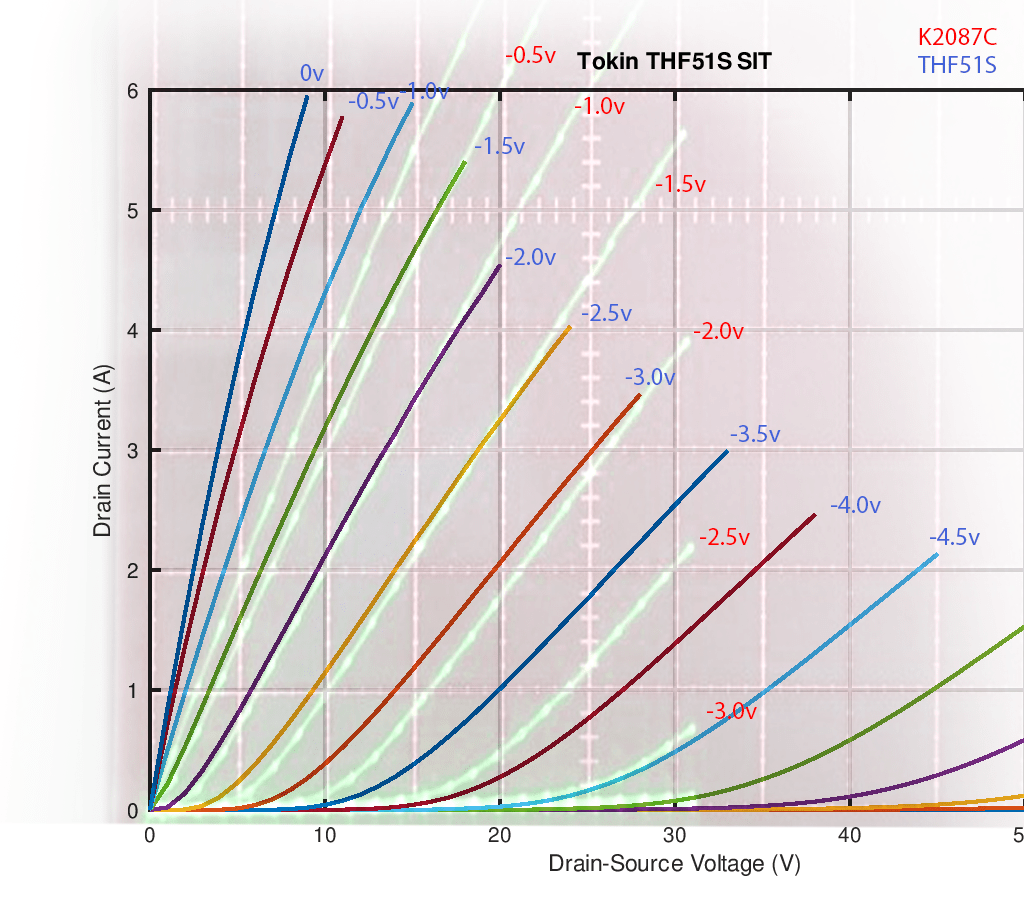

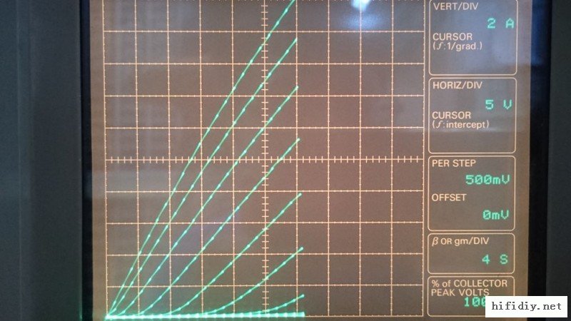

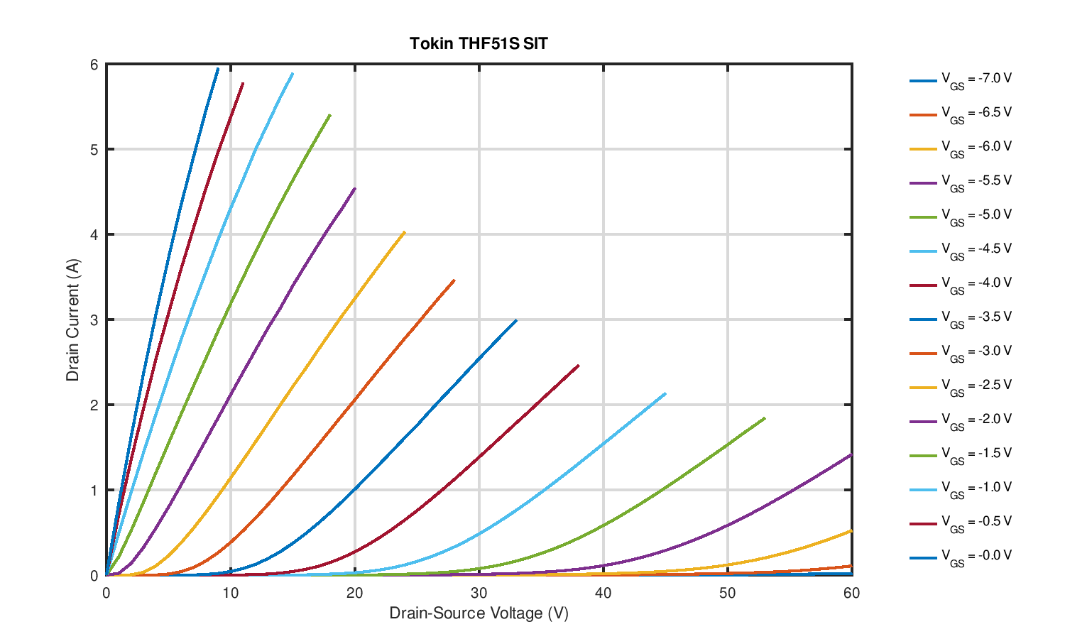

I found some measurements Woofertester made of thf51, and I superimposed it with a measurement that wangweiliangb shared in his original post on the K2087. I was able to warp things up so that the vertical and horizontal div's are the same.
Granted, these are two different testing environments done on two different devices, but its still an interesting look. To me, it seems like the curves are pretty similar and thf51 just needs to pull Vgs just another volt or so to bring it more inline with K2087.

Love that! Thanks codyt!
It looks like a at least one more volt will be needed. 2R might be enough in conjunction with the choke's 0.68R. At 1.4 amps, that will give about 3.75 volts. With some device variation, it will get you in the ballpark.
