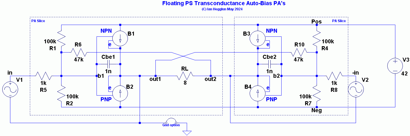

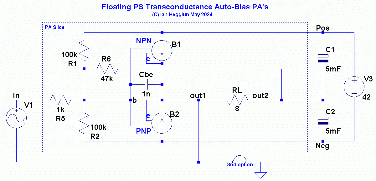

For those who are interested in floating power supply amps, here's a brief tutorial post for my auto-bias amps. The LTspice run file is attached:
This is a simplified circuit that you can run to see what's happening and how it works. The power transistors have infinite current gain so a driver stage can be omitted. The autobias loop is also omitted and there is a fixed idle current of around 180mA.
Capacitance "Cbe" provides simplified HF rolloff.
The load is effectively floating but loads "Out1" terminal can be connected to ground using the link.
The supply rails "Pos and "Neg" are floating in this amplifier.
The load "Out2" terminal connects to C1 and C2 which are effectively output capacitors (they provide DC speaker protection).
The input signal is connected to the amps "Out2" node (which is normally grounded but doesn't have to be grounded to operate). This means the power transistors operate in Common Emitter mode -- which is also the transconductance or current outout mode.
Some voltage feedback is then added by sensing the load voltage at "Out2"
Further, some voltage feedback is also added by sensing the rail voltages "Pos" and "Neg" with equal value resistors R1,R2 so negative feedback pulls "Out2" voltage to half of the rail-to-rail voltage V2, giving effectively +/-21V across output caps C1 and C2. Feedback resistor R6 is only for AC feedback while R1, R2 provide both DC and AC feedback. The effective feedback resistance of R1//R2 is 50k and this is in parallel with R6 giving about 25k for feedback. With a 1k input resistor the voltage gain is about 25 times. The actual gain is more like 20 due to finite driver stage input resistance (not modelled here).
The output resistance (and DF) with this voltage feedback depends on the transconductance of the output stage. If the Gm is 5A/V then the open loop voltage gain is Avol= 5A/V x 8 Ohms =40. If the closed loop gain is 20 then there is only a factor of 2 of voltage gain left for lowering the output resistance, giving only about 6 dB of feedback and an output resistance of around 8 ohms. (I measured about 12 ohms with 0.2 ohm emitter resistors). This amp is intended for current drive of loudspeakers. For conventional speakers you can add a Sokol tuneable equaliser to add the needed speaker damping (Post 219).
You may wonder why I have the Gnd jumper option. It shows you can completely float the entire amplifier and PS when you feed the input signal to "Out1" and float the signal source. This can allow a floating bridge:
The demo file is attached. The "Out1" node can be grounded giving a grounded output bridge and a non-floating input signal for the LHS. The RHS must use a floating inverted input source, which could be a transformer or a second floating DAC.
In fact you are free to ground whatever node you would like - for example you could use a conventional +/-21V non-floating power supply (to feed other channels) as long as the the two signal sources are floating.
Even more wiered, you can hang more bridged amps off the same floating power supply - as long as the two signal sources are floating and all the speakers remain floating (just include an antifloat ground resistor somewhere in your sim to keep SPICE happy). In practice you may prefer to use a conventional +/-21V non-floating power supply for a ground.

You and Marcel have successful auto-bias circuits. Fast auto-bias avoids the problem of the bias being goofed up by some signal in the (possibly distant) past.
I think the floating supply is not inherent to the auto-bias circuit. Floating supplies can pass noise from the AC line. You may want to develop a conventionally-powered version.
ETA: You may want to clamp Q5 and Q6 to prevent saturation.

Hi Ed,
Thanks.
With my autobias circuits there is also the option of a floating signal source with a grounded power supply.
There is also Post 160 option using a high voltage opamp and a grounded power supply.
Cheers, IanH

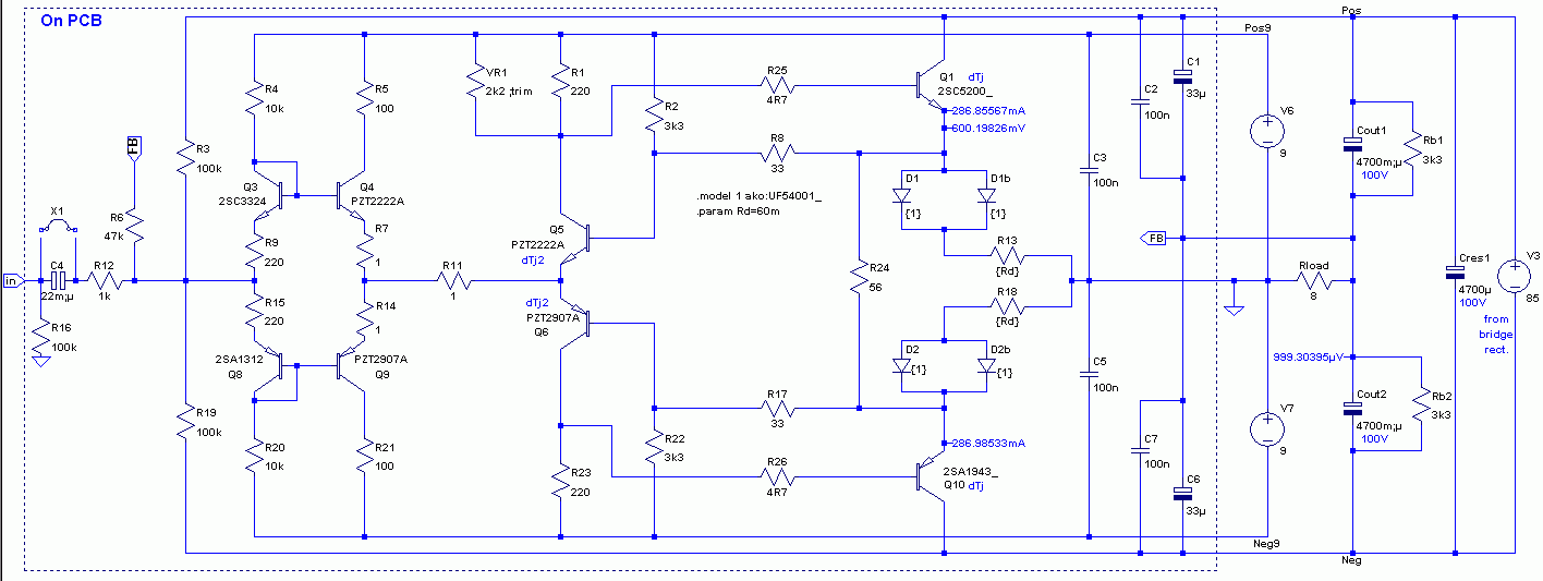

This post is similar to Post 220 but using UF54001 3A diodes.
The model for the UF54001 is close to the MUR1615 TO-220 diodes and gives a similar XY plot to that shown in Post 220. Two UF54001's are in parallel mounted on copper tabs so they fit in the TO-220 pads of my first PCB for testing. In Post 220 the two diodes in the MUR1615 are in parallel so the electrical properties are similar to two UF54001's in parallel. I used 50m Ohm resistors in series with the diodes as shown. There is another 10m Ohms in the wiring an copper tracks, giving 60 m Ohms total. The idle current without the bias offset resistors (R2,R22) is 540mA and with 3k2 for R2 and a trimpot for R22 the idle current is reduced to 250mA which is the minimum idle current for best linearity with 60m Ohm series resistance.
Using music set for just below clip (3Vpk in and 42Vpk into an 8 Ohm speaker) the temperature of the diodes remains almost constant at 43C (28C rise) and the main heatsink 55C (40C rise) at idle and 58C with music. At the instant of stopping long term near clip music the idle current is 260mA and falls to long term value of 250mA withing 2 seconds. So the thermal properties on this PCB appear to be good enough for music use. The distortion according to simulations is in the 0.1% range for the first watt -- but distortion was not obvious with music for any power level even up to almost clip.

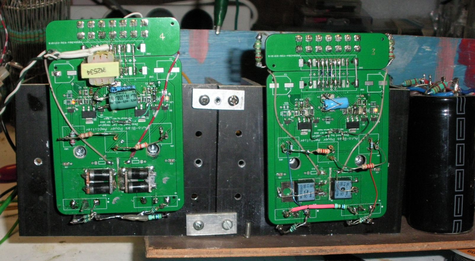

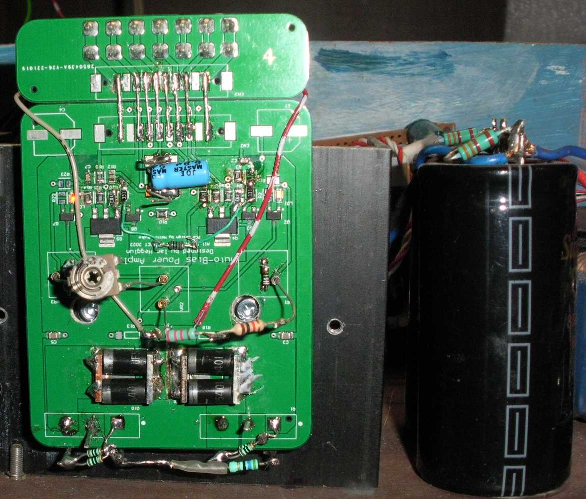

Here I run two Autobias amps off the same floating power supply as mentioned in Post 222. Good news!
One board (RHS) has it's "Out1" grounded as usual (see post 222). The other board (LHS) has it's input isolated using a 1:1 transformer. Both boards share the same rail capacitor and share the same AC output capacitors. But note -- the two boards have independent isolated/floating +/-9V supplies!
And it works as per simulations above. It allows left and right channels to run (almost) independently as with standard designs that share common power supply rails.
It also allows bridging - just by reversing the transformer primary phasing. With each channel independently I got 34Vrms into 8 ohms at the start of clip. Then with a bridge I got 63Vrms into 16 ohms. Rail voltages at clip were 110V for a single channel and 99V for the bridge. So that's twice the output swing as expected with a bridge. (But to drive 8 Ohms with a bridge with this rail voltage each side needs two parallel slices (boards). But that will have to wait till I uprate the transformer and heatsinking).
So, as long as each amp has its own isolated +/-9V supplies and the inputs of the amps are isolated, then two or more channels can run off the same floating power supply. And as stated in the tutorial you are free to ground the power supply, such as the center point to reduce noise from mains getting through to the amps - and again, provided all these floating amps have isolated inputs and isolated +/-9V supplies.
