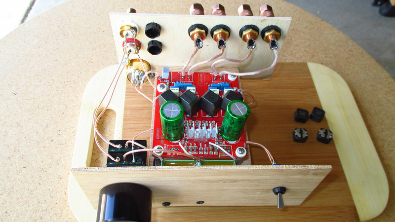

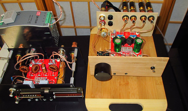

I installed the ICE Inductors into a TPA3116D2 that’s mostly stock, just to check them out (again a pretty significant improvement over the stock inductors, even with the original filter parts) and now I’ll put them into my main test rig (on the left) and see how they stack up against the Bourns inductors (which are sounding very good).

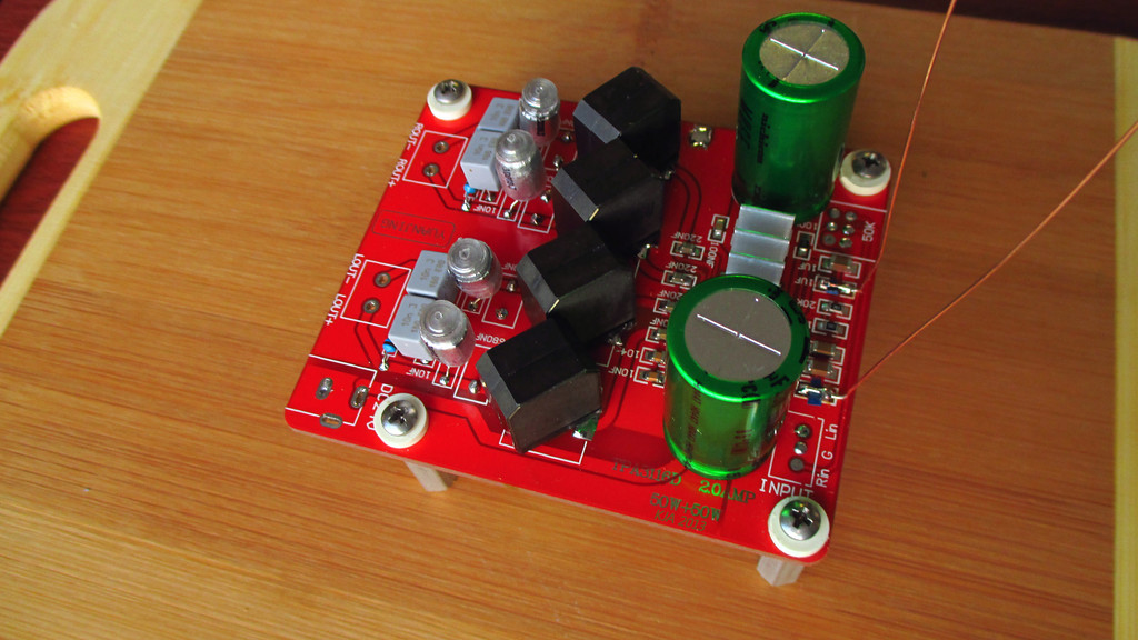

I have been really, really enjoying the Yuanjing 2.0 stereo version of this board and so thought to buy a second one to experiment on.
For reasons that make no sense now, I was convinced that the volume pot was rated at 100k, so I ordered a Valab 23 step 100k pot on Ebay. Of course, the actual value of the pot on the board is 50k. Nuts.
So...what will this do to the sound? Any problems? Any workaround to get back to proper values, given that I was already planning to swap parts?
