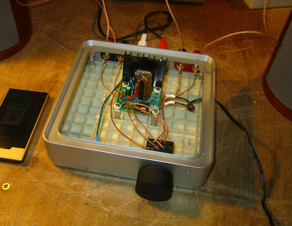

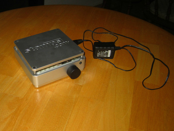

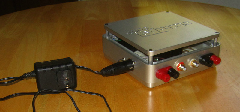

One ended up in a "chassis" from a broken stamps.com scale.
Interesting. I have a couple of the TDA7297 boards from China and for me they don't really measure up to the TPA3116 or TA2020. It sure is a good deal though. I bought a couple and they get used.
KJA,
You have good hands! You turned all the "nick-nack" boxes into nice looking chasis for all these small amp boards

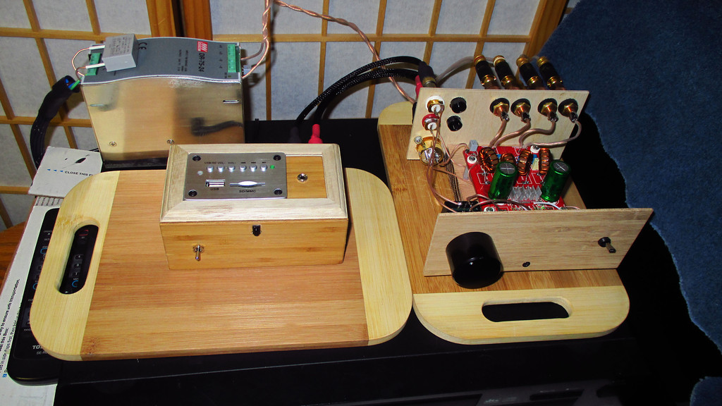

My wife laughs at how many "things" get transformed into audio equipment.
Yesterday, I made a case for this little MP3 player to use in the workshop.
You could make some bank selling stuff like that to hipsters...
