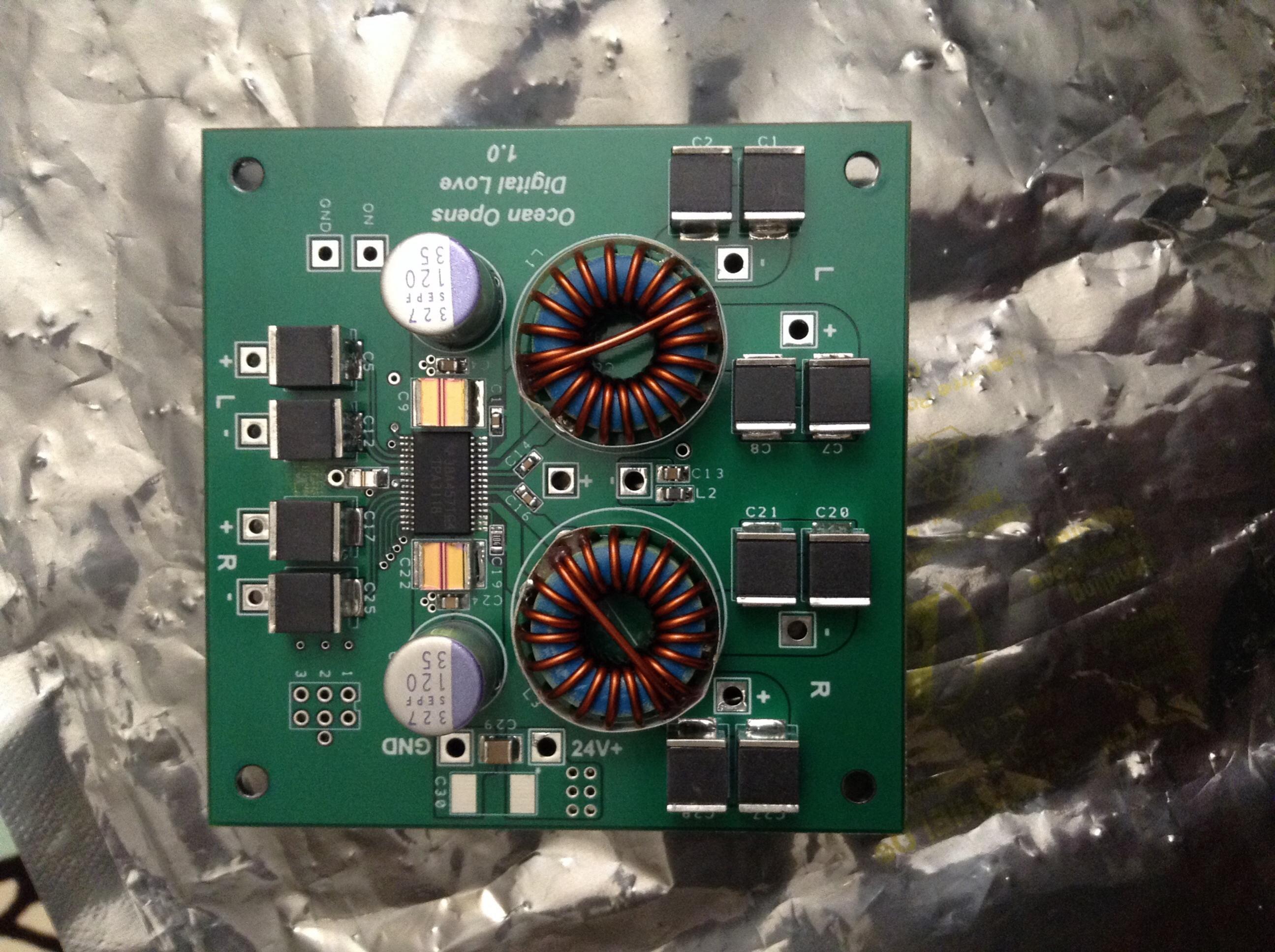

I assume this is the parallel bridged mono?
Looks to be stereo.
It is the 3118 though, correct? any reason you chose that over the 3116?
It's in my opinion the 3118 is ever so slightly better.

75mm x 75mm 4 layer. A bit more expensive but i wanted a dedicated GND PLANE.
Stereo configuration.
I liked the grounding better on the 3118.
Wima PPS smd 2824 (black caps).
Designed for a 6 ohm load. 22uh & 1uf LC FILTER.
Here is another angle. I am waiting for the battery to arrive. I will be using a LIFEPO4 4 cell design from batteryspace.

You get my vote for the best looking, most compact, cool TPA311xD2 PCB design! I have built both the the 3116 and 3118 and have to say it is difficult to discern the differences in sound. IIRC, the 3118 may actually have more choices for the modulation frequency selection?
I am sure we are all salivating on this design and wish we too could have the PCB. Would you contemplate sharing the design files for us to get the board fabbed? If not, I am sure folks around here would be willing to buy the boards from you in a group buy to play with.
