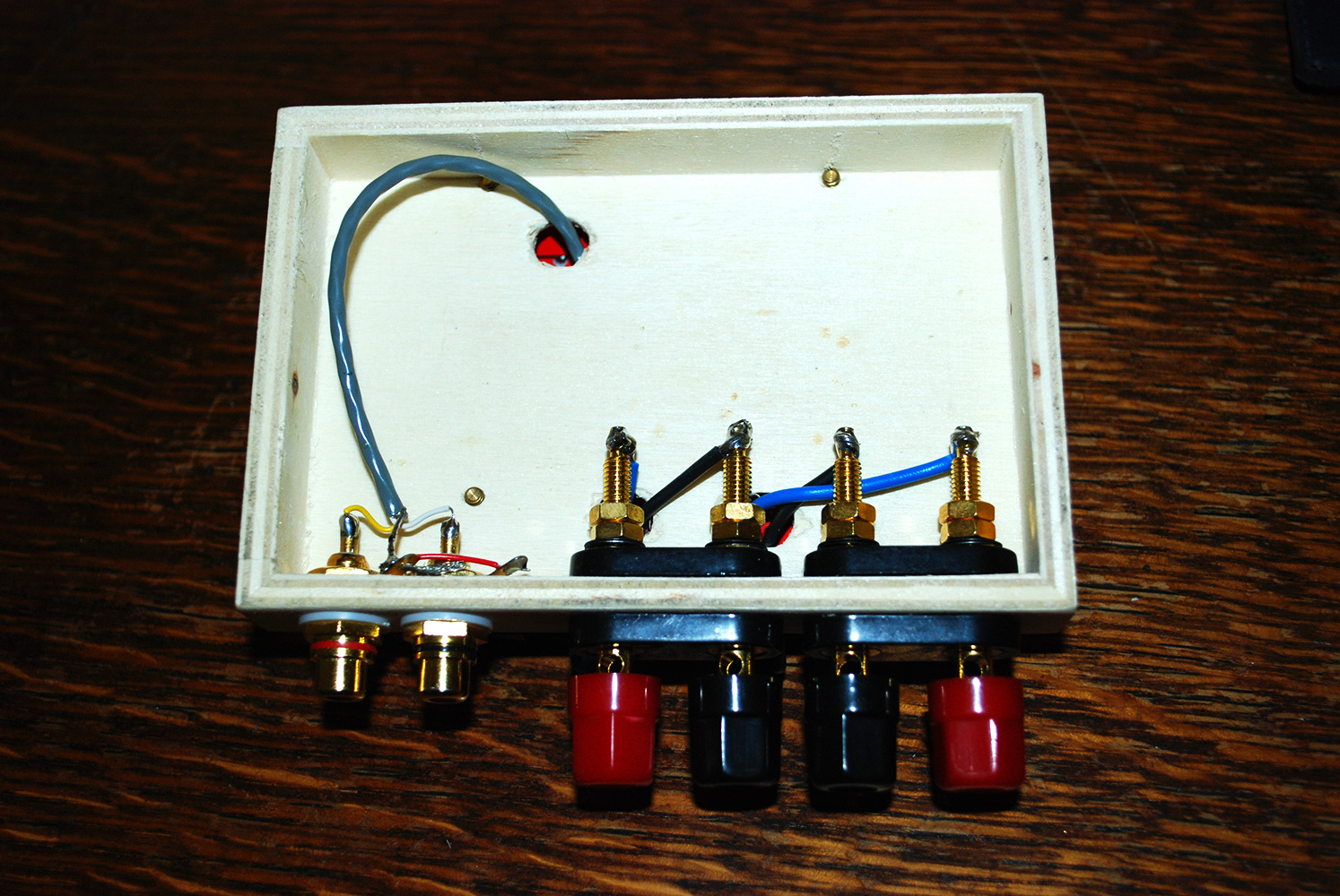

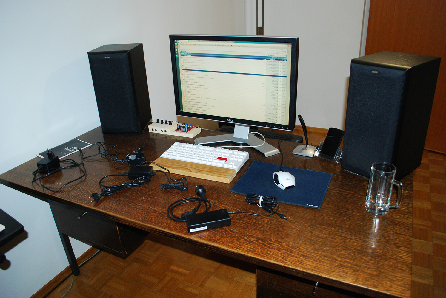

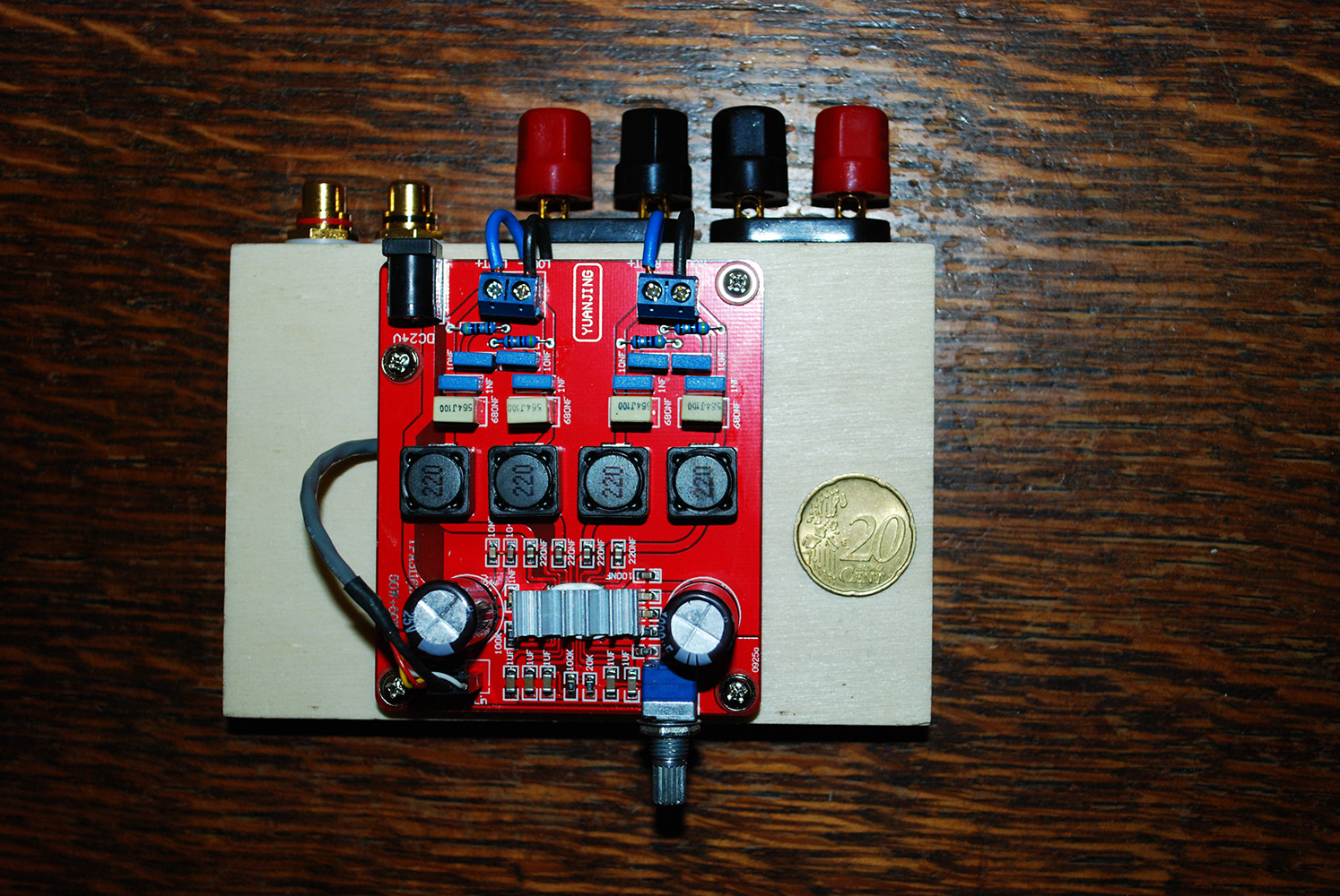

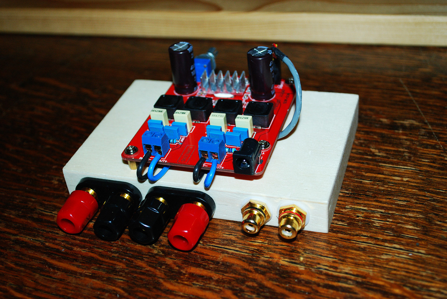

This is what I have so far.
Until I get new pot I'll just have it on top of that box. Now on to PS testing. Laptop SMPS 19V had too much hum. Only other option I have for now is 12V but those are all low current works well for low volumes.
Speakers are Jamo Cornet 165.
P.S. sorry for bad photos.

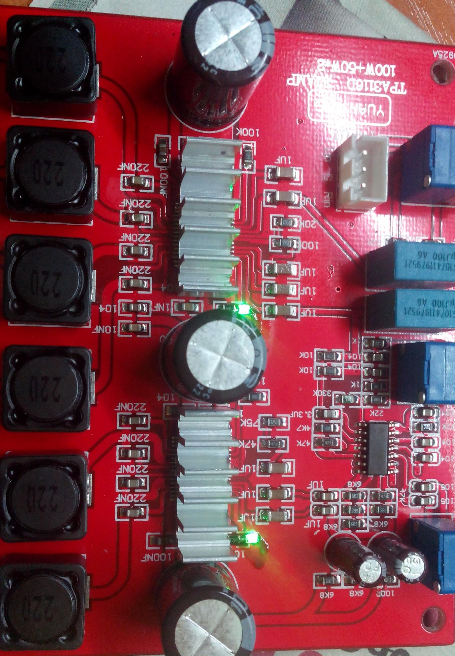

The sub channel filter is a text book Sallen-Key low pass filter built around one section of the TLO74. The components, 2 x 22k and 2 x 100n, are around pins 5,6 and 7 giving a Q of 0.5 and a cut-off of 72Hz. There are plenty of on-line calculators if you need to change the values to give a different cut-off.
There is no high pass filtering for the main channels.
Have you checked the value of the capacitor in the sync circuit between the 2 chips? Have a read of my post #419 as mine had a wrong value fitted.
