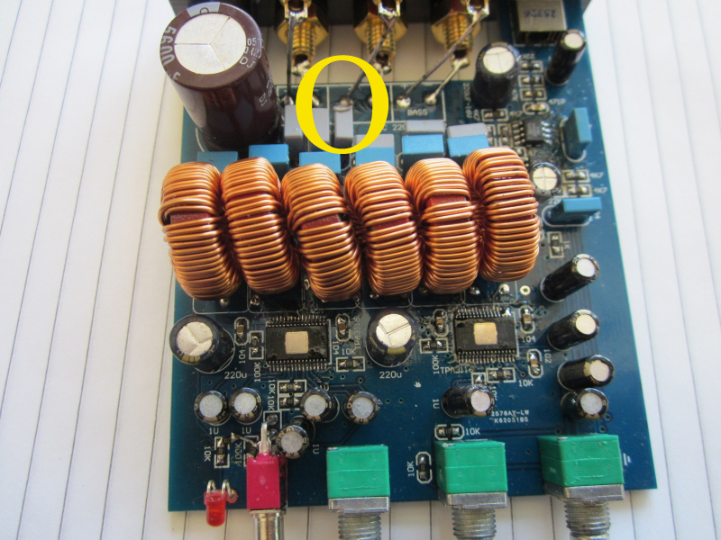

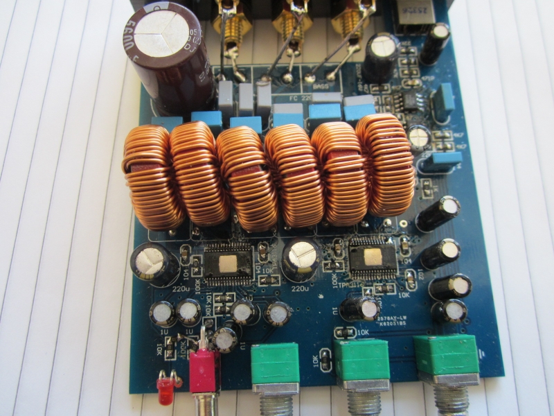

Before you power up your Breeze TPA3116 Mini Amp….
You may want to take 2 minutes to remove the topcover and look inside.
I opened her up and the first thing I noticed was that there was no heatsink on one of the chips. This didn’t bother me because I know these devices don’t get very hot and they have thermal protection built in…. but, what DID bother me was when I found the heatsink attached to the inside of the aluminum top-cover. Lucky for me the adhesive was strong enough to stick to the top cover.
Chances are you won’t hear the heatsink rattling around inside the unit since it will probably stick to something inside, but you might not be as lucky and it could be shorting something. I highly recommend that you be proactive and make sure everything is right before you power it up. You need only a #2 Phillips Screwdriver, a 2.5mm Hex Driver and a couple of minutes.
and oh yeah... Happy New Year!

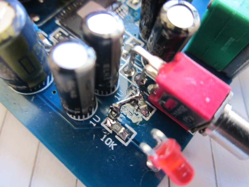

So I just received my Breeze amp and thought I'd follow this (excellent ) advice. Opened her up and surprise, surprise: No heat sinks at all
This amp has some other issues as well:
- the power switch doesn't work at all, and the unit is constantly on. There appears to be some pretty dodgy soldering around the power switch too..
- it is also running very hot: with the volume control turned right down, I can't put my fingers on the inductors for more than 5 or 6 seconds. Ditto for the chips themselves (without the heat sinks of course).
I also have a YJ 2.0 board as well and this runs totally cool at pretty much all times, so I'm concerned about this Breeze amp running so hot.
Maybe somebody else who has a Breeze unit can tell me how hot these thing normally run?
Should I try and fix this one, or send it back and get a replacement, which hopefully works OK?

Wow, that looks like some pretty shoddy soldering. Looks like they brushed one of the capacitors with the iron near the outputs...
Check the inside of the topcover for the missing heatsinks.
When this amp is running normally and driving typical loads, I wouldn't bat an eye at running it without sinks but the way yours is running seems wrong.
My inductors run warm, never hot. The chips themselves run cool to warm, never hot.
I've been driving a pair of Genesis G7p speakers (6 Ohm / 86db) on the stereo outputs and a Velodyne sub on the LF output.
It's difficult to tell from your photos, but it looks like overall quality and attention to detail isn't as good as what is on mine. Here's a fairly detailed pic of mine as it was received (except the heatsinks aren't present in this pic.... one had came off in transit and I removed the other to reattach them both uniformly.
I had seen the heat damaged cap too. Well spotted. Alas, no heat sinks anywhere to be seen.
I'll see whether I can get a (better) replacement from them.

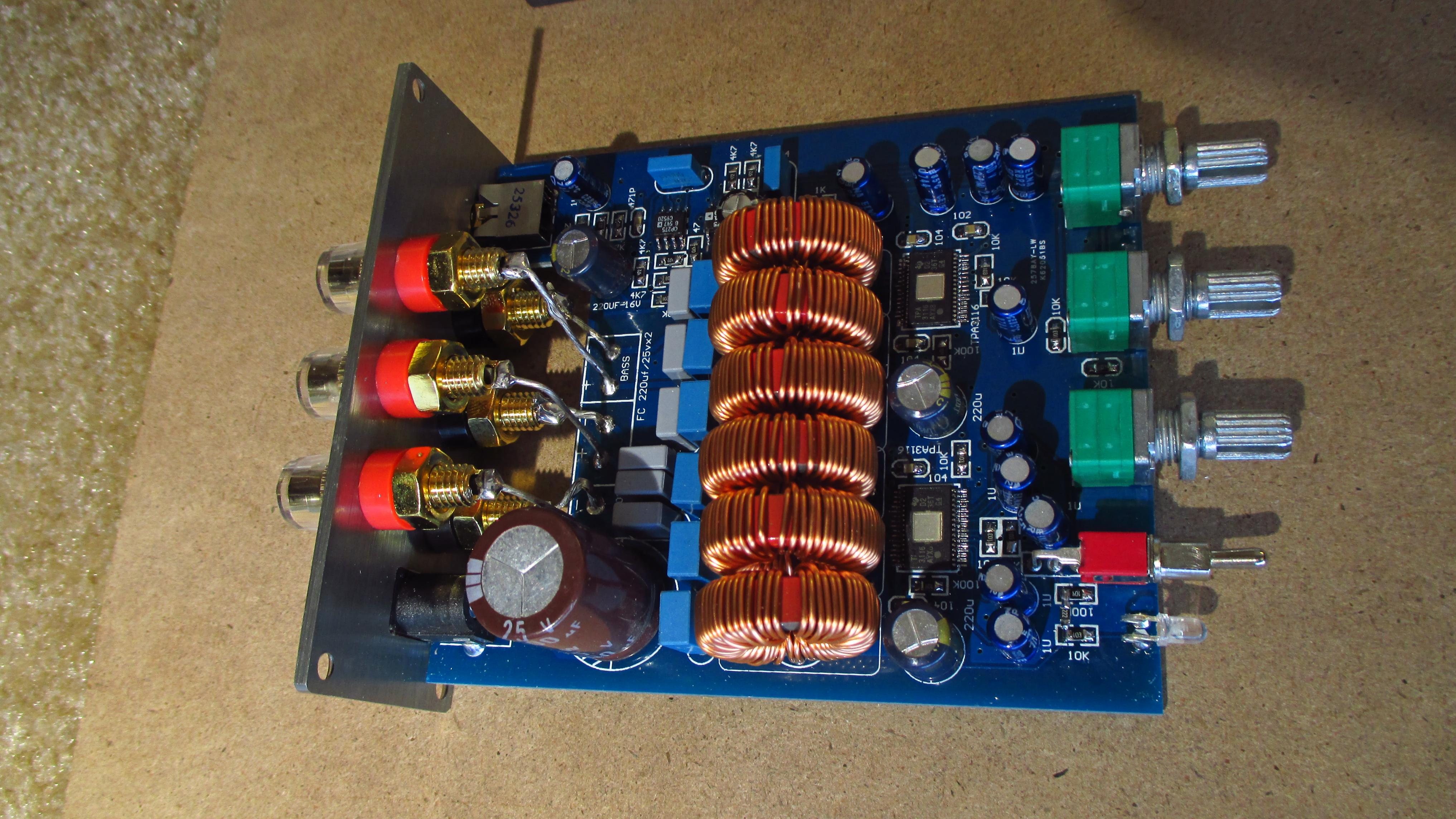

Help! My new Breeze 2.1 amp does not work properly!
Hi all,
Since this thread is where I got the link to Aliexpress for the Breeze 2.1 amp, and there are posts in this thread about that 2.1 amp, I figure that I should be able to get some useful advice here.
I just received my Breeze 2.1 amp yesterday. The amp came in a small beat-up cardboard box, wrapped in some flexible foam sheet. The packaging for the shipping surely did not look professional. The amp did not come with anything else, not even a user's manual. Even though I knew the amp is quite small when I ordered it, I was still a bit surprised by how tiny it really is.
I hooked the amp up to a pair of full-range speakers I made. Only the L and R channels were used, and the sub output was not connected to anything. The input signals came from a DVD player, and the amp was powered by a 24V DC switching power supply that I got from Parts Express. I noticed that the red LED on the front panel of the amp was on regardless of whether the power switch was in the ON or Off position.
I pressed the Play button on the DVD player, and music came out. So far so good. After only about 20 seconds, however, all of the sudden the music stopped, just when I was thinking: "Hmm, this little amp does not sound too bad." After a few seconds, the music came back. Then after a few seconds the music stopped again. The amp kept on cutting in and out. I then noticed that the intermittent operation of the amp was volume-dependent. With the volume knob was turned almost all the way to the lowest position, the amp would keep playing. When the volume was increased slightly, the amp started to mute itself intermittently. When the volume knob was at about the 12 o'clock position, the amp would keep switching on and off without playing any music.
To see if the problem was affected by the power supply voltage, I connected the amp to a 12V SLA battery. It appeared that the amp was able to play at a slightly higher volume before starting to skip, but the problem was still there.
I opened up the amp, and could not see anything obviously wrong. The two tiny heatsinks were attached to the chips. The soldering job, however, seemed quite shoddy. Did they solder those SMD components onto the circuit board by hand? Also, the 5600uF power supply cap is too tall -- it would push hard against the top cover of the amp when the top cover is on.
With the amp's top cover removed, I tried the amp again, and the problem was still there. I tested the temperature of the chips and the filter inductors by touching them, and they were just slightly warm.
I suspect that the intermittent operation of the amp was due to the amp's protection circuit kicking in when it shouldn't, but what could be causing that problem? Perhaps the protection circuit is mis-wired or uses some wrong components?
Any suggestions regarding what could be wrong, what to check, and how to solve the problem will be appreciated.
