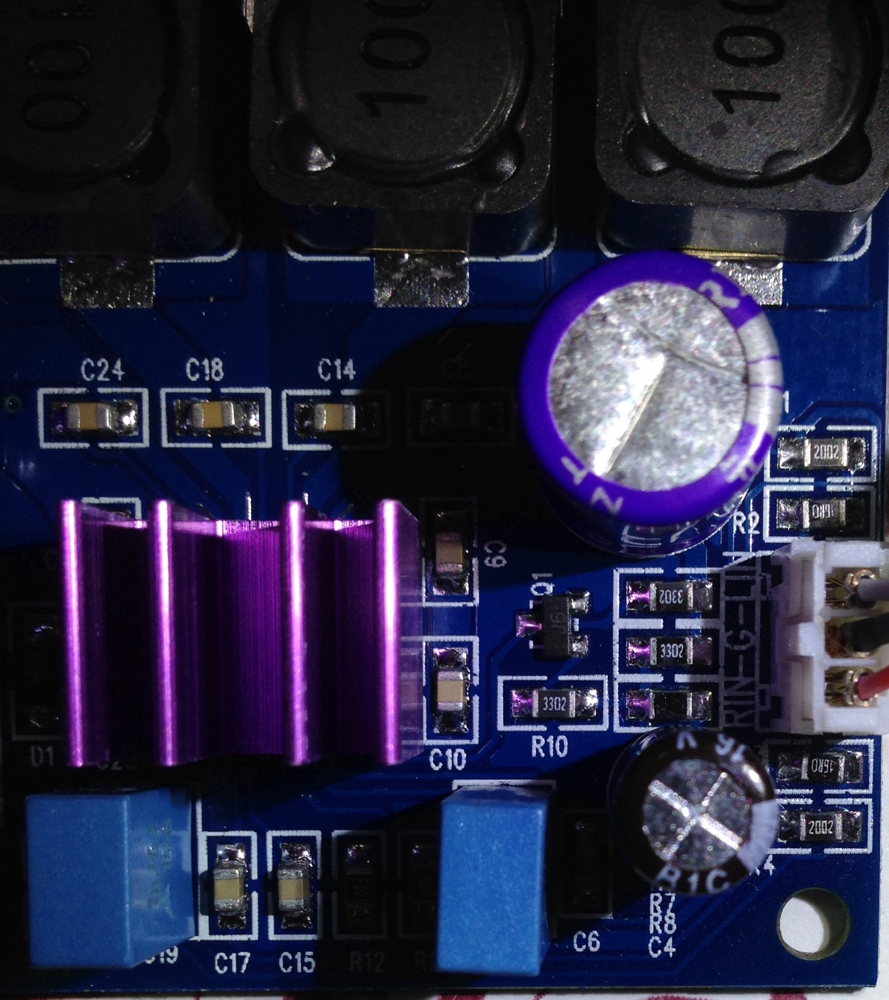

Beside, last week it arrived the little blue board from taobao that now its listed in aliexpress, check the input pic, My electronics skill are low, but, Could be that the transistor Q1 allows to play this little board in PBTL!?...
Pbtl requires connecting outputs together in parallel and that cannot be done with single Q1. I am guessing this has to do with the ' no sonic boom' or anti turn on thumping feature, or maybe used to sense signal input on to turn amp on from silent sleep mode? Many sub amps do this so you don't have to power them off when not used.

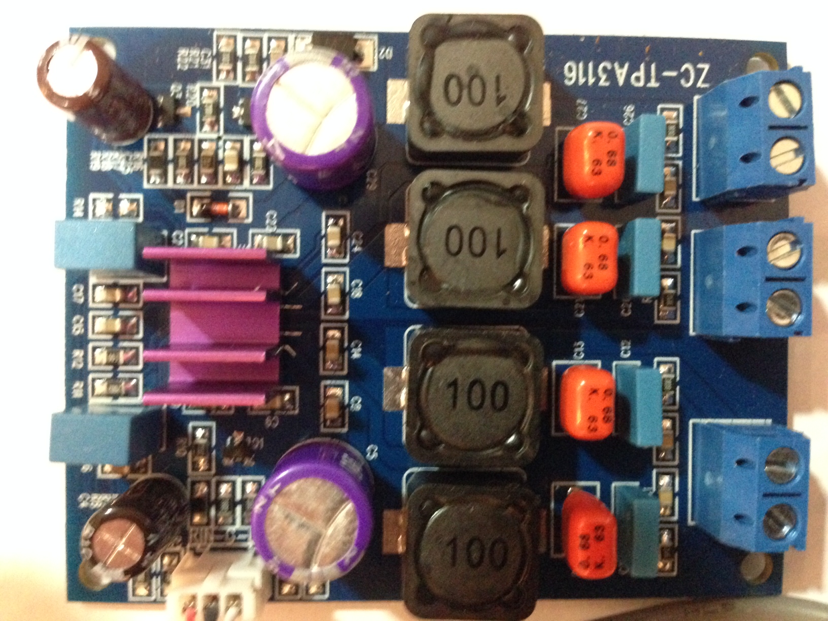

Good catch to see on it Aliexpress. Question is how many units per bag? I see solder pads for two more inductors so this can run as BTL in stereo. It is one of the most compact layouts at 2in x 2in. Has anyone seen the stereo brother? I assume 15 watts/ch.

Q1 is in the datasheet. It's the automute on fault transitor.

Could be this:
