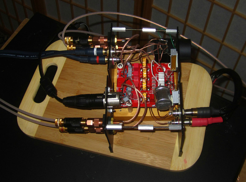

It's a blast trying wring as much performance as you can out of a little board like this.
The only thing I've had to buy so far were the coils from HK.
They sound quite good and better than the stock parts. They run warm but not hot (around 48-50C). After a couple of weeks now, the little guy is driving these big speakers quite well. You're right Lo_Tse, it is fun.

Interesting, did you use the XLR type plug as the power supply connection?
By the way, did you get those coil from Ebay? Would you mind sharing the the name of the vendor?
Thanks!

Yes, the XLR connector is for connecting the power supply.
The coils were purchased for a TA2020 based amp that I am using but I thought I'd try it on this amp as well. I'm thinking of getting some Bourns 22uH coils to see how they compare to these since this board comes with the 22s. The seller was cloudcloud1018. They were $4 plus $3 shipping from HK.
I have a nice looking chassis to mount this board in once I'm done experimenting with parts. I'm making the amp for a friend of mine.

I like the way you set up the "box" for the amp (as per the photo a few posts ago). Two pieces of acrylic plates should work well. I am going to give this a try (I was never good at building chasis).
Let us known how the Bourn 22 uH coils work.
