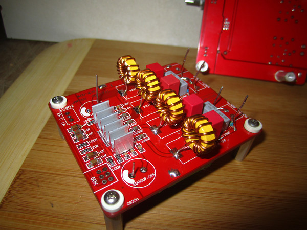

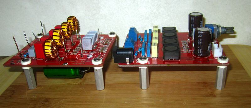

I'm going to give these budget 10mH Ebay coils a listen to tomorrow.
Has anyone else changed the coils on this board yet?
Correction... Meant to write coils.
KJA,
You mean 10uH coils not mH, right? I am curious how they sound with the 22uH coils because my design has always used 10uH as specified in the reference drawing. I noticed that you have started extensive modding of all the downstream caps with upgraded poly films and put bigger power supply electrolytics on the bottom. It's looking really good. FWIW, the design I have uses all SMD components downstream except for the coil and I think this keeps the size of the parts really small and yet it sounds really good to my ears. Those new coils are unshielded and now hang like antennas above the board. I wonder if it would reduce RF pickup by mounting them in flat orientation as close to the ground plane as possible on the bottom side of the board and use the ground plane to block RF pickup between the high impedance input side (on top) and the low impedance output side (on bottom). I actually have my unshielded coils mounted on bottom side.

Yes 10uH...KJA,
sure, just using this board to test various parts.... final orientation can be optimized. I'll hear how they sound sometime later today or tomorrow.

?..... and put bigger power supply electrolytics on the bottom.
They're still 1000uF caps but mounted so that it's more convenient to try different bypass caps if I want to.
