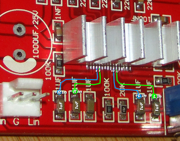

For those of you trying to wring the most hifi performance out of this pre-built board from YuanJing, I recommend using a better volume control and connecting the outputs of the pot to good quality 1uF film caps connected to the traces that go to Pins 4 & 10 ( the positive L & R inputs) of the amp chip, eliminating the little surface mount caps they use.
Can pins 5 and 11 be made accessible for balanced inputs? Thanks...
The signal paths to pins 5 & 11 are equally accessible.
The volume pot can be removed altogether though, right?
Sure, I've removed all of the cheap pots that come with these boards.
