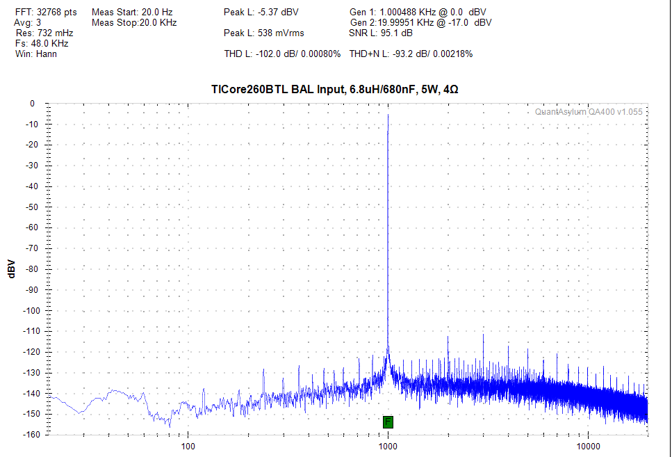

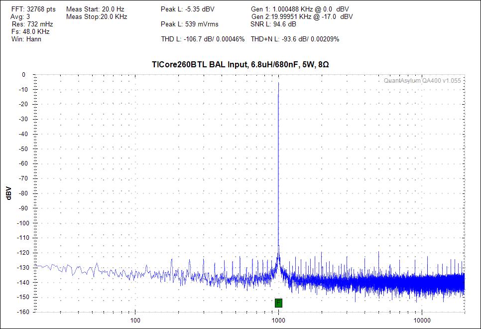

My latest soundcard measurements. Note that the THD+N limit of my QA400 + Interface is 0.002% (the interface's power supply has no low noise LDO, it's only relying on the PSRR of opamps),
I'm also using a low noise supply for TPA3255, so the THD might be the more accurate indicator. Gain is 11.9x, supply rail 38V.,
5W, 8 ohms = 0.00046%
5W, 4 ohms = 0.0008%
It is incredible what the tpa3255 is capable. Thx you jlp for taking the time and transparency. Your amp is very hard to beat for the price.

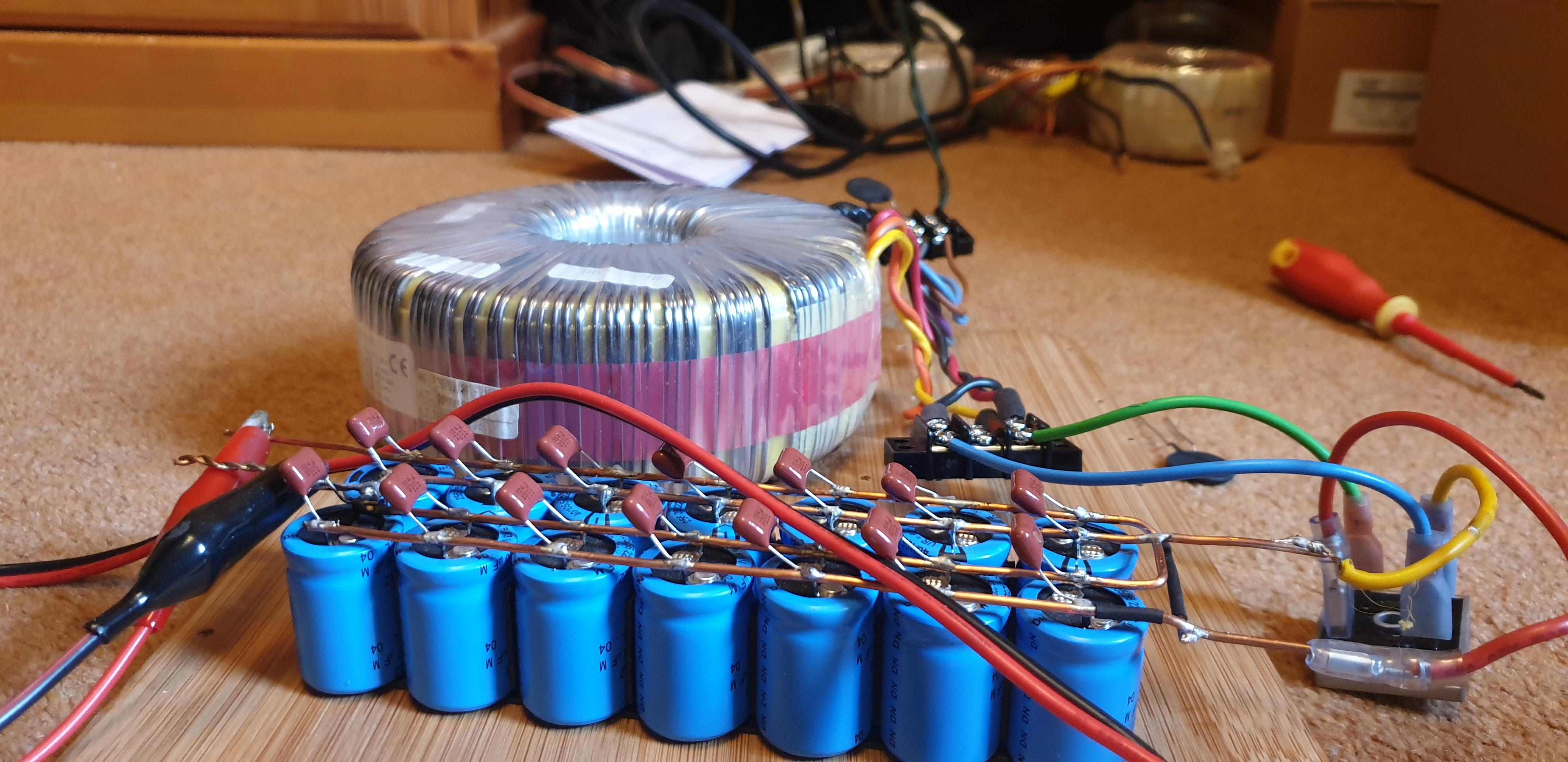

I use a 35v 500va toroid with 14 x2200uf each with 0.1 bypass.
I prefer the simplicity and reliability over SMPS. I did try a MW but could hear its PWM.
