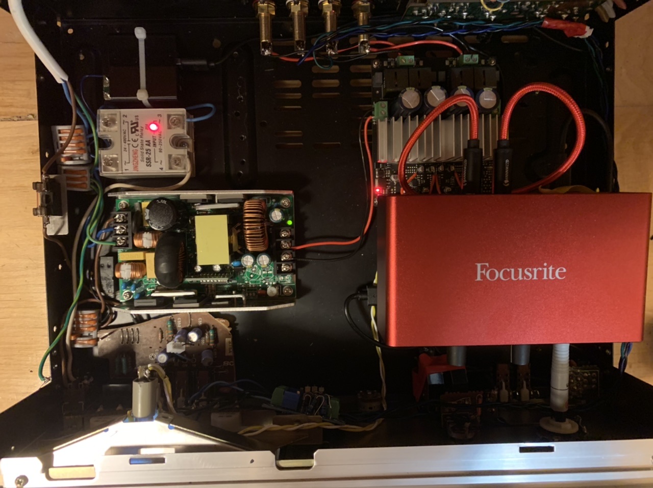

Show your PSU )![]()
Another good option, using a linear PSU with 4x 10000µF 50V Nover caps + 300VA Toroidal transformer.
What I did with my 3E Audio module :
