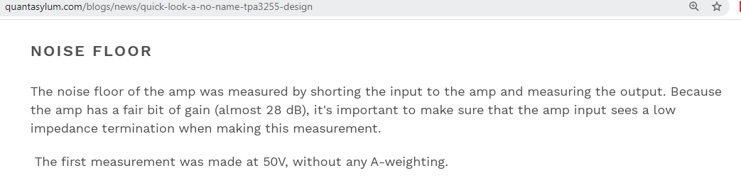

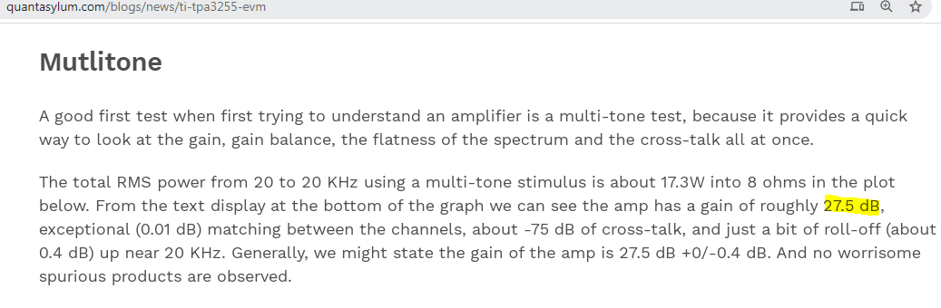

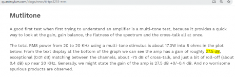

Pokerbarlo, you are wrong about the tpa3255. It really is 150w but I dont think you use the amp within its limitations. The bass shakers are probably less than4ohm so in parallell they actually are less than 2 ohms! I think 3.3ohm is the limit for the chip. When connected in series lets say 7ohm which is fine but then you need a high level music signal (3-4V, think pro audio levels) into the amp which most people dont have. The amp only has about 21db of gain so its designed to be used with a preamp. Many other diy amps have 26-32db of gain so this tpa3255 isn't straight up swappable with other diy cheap power amps you might have already. So to sum it up, connect 2 shackers in series and get a preamp with 3-4V signal level output and it should work
Also, put a fan on the heatsink for high power continous use.
D
Deleted member 148505
Hmm based on my tests (and also in Quantasylum measurements) gain is around 27.5dB to 28dB, so I'm not sure why the datasheet says 21.5dB.
Anyone can clarify about this?
EDIT: I think 21.5dB is for SE per channel gain. 27.5dB is for BTL modules
