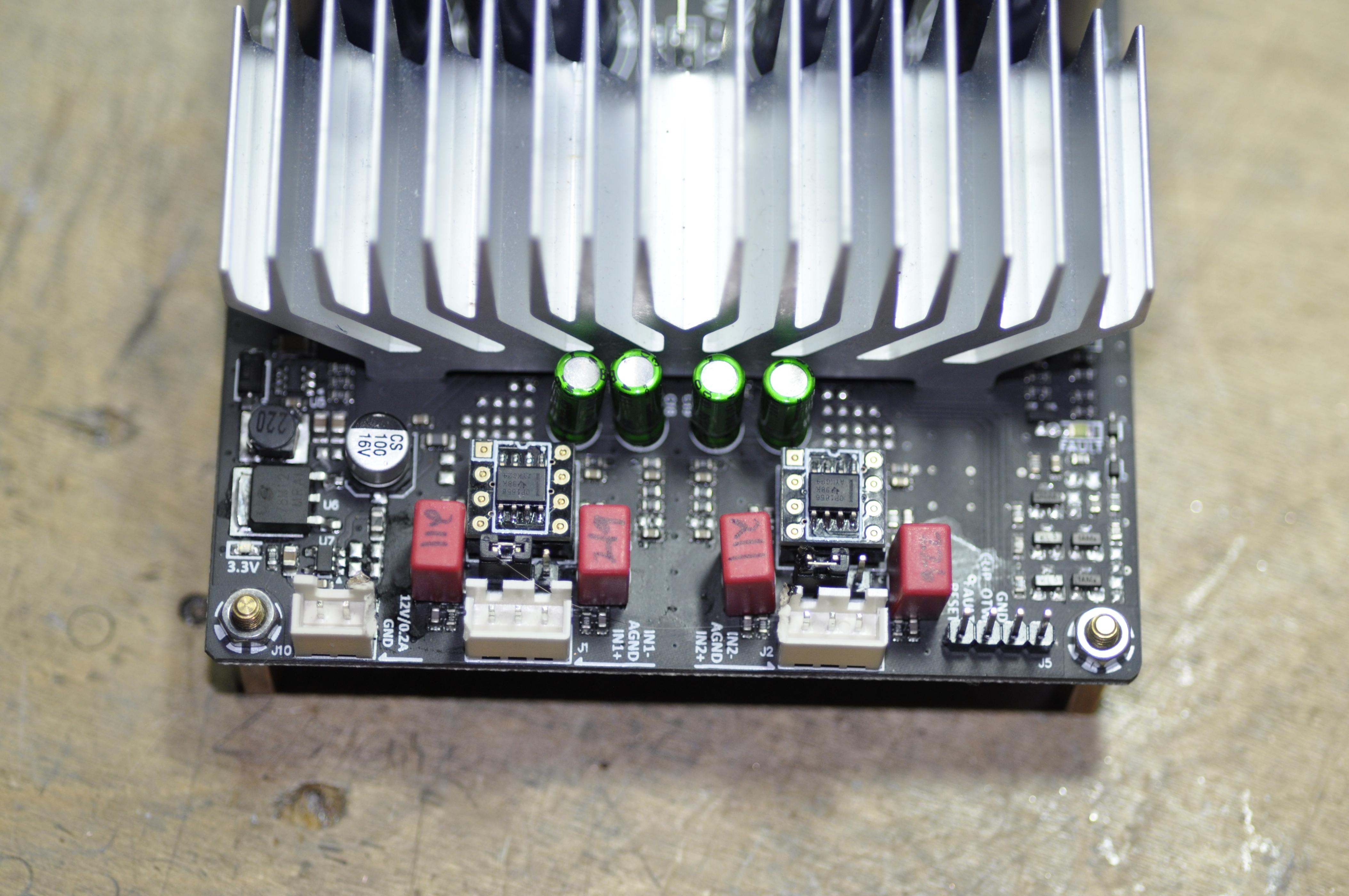

I have a 3e-Audio EAUMT-0260-2-B Rev1 two channel TAP3255 board (this is the latest released board as far as I know).
Has anyone looked at the options to add bypass capacitors to the main Power Supply Capacitors ? Should be quite easy to add them under the board.
I don't know if you would have access to the AVVD Supply on the TPA3255 to add any additional Capacitors at this point.
As the Op-Amps are on DIL adapters it should be quite easy to add some dedicated capacitors to the Op-Amp's power supply pins.
Any opinions as to whether this would improve the amplifier ??

Hi Pete.
Thank you for your comments on the 3e-Audio module. Do you have any photos you could post to show the modifications.
I also have a couple of the Aiyima (Tilear) amplifiers and I have also been following the "Aiyima TPA3251 Modification Build Thread". It was this thread that made me start to think what could be improved on the 3e-Audio board !!

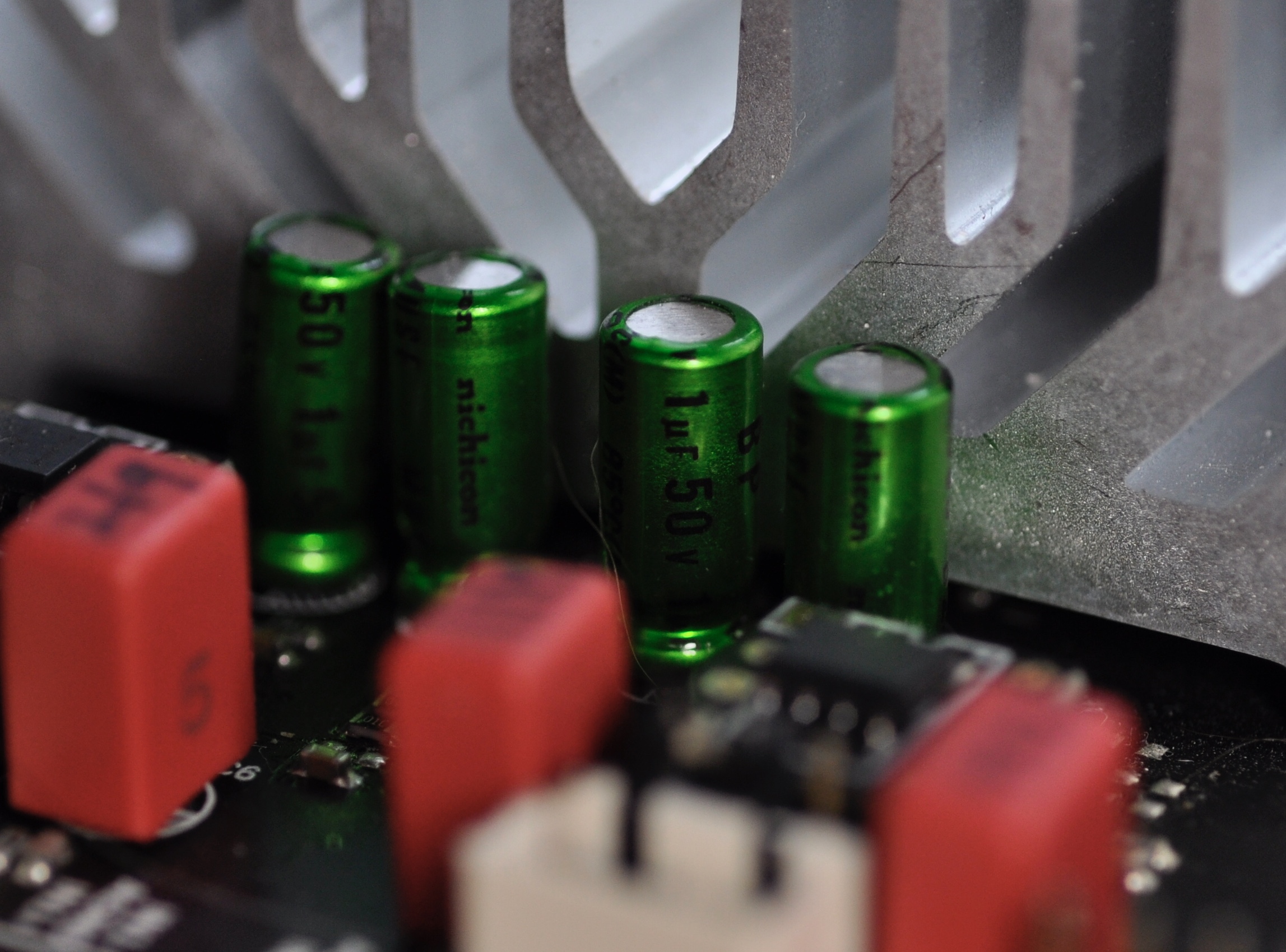

I already use the OPA1656 Op Amps as my default choice and was also looking at adding Caps to these as suggested in the above thread as it would seem quite easy given the plug in DIL modules without damaging the main PCB and the SQ returns seem quite good. I am sure this would work for any amplifier with DIL sockets for the Op-Amps.
I was also looking at suitable options for bypassing the Chengx main Caps - Whether these would benefit of being replaced or just bypassed I guess time will tell as people experiment.
It seems that providing clean power to the Analogue side of these amplifiers provides the most SQ benefit. Other than the main Caps there is not much room (physical space) for any significant additions !!

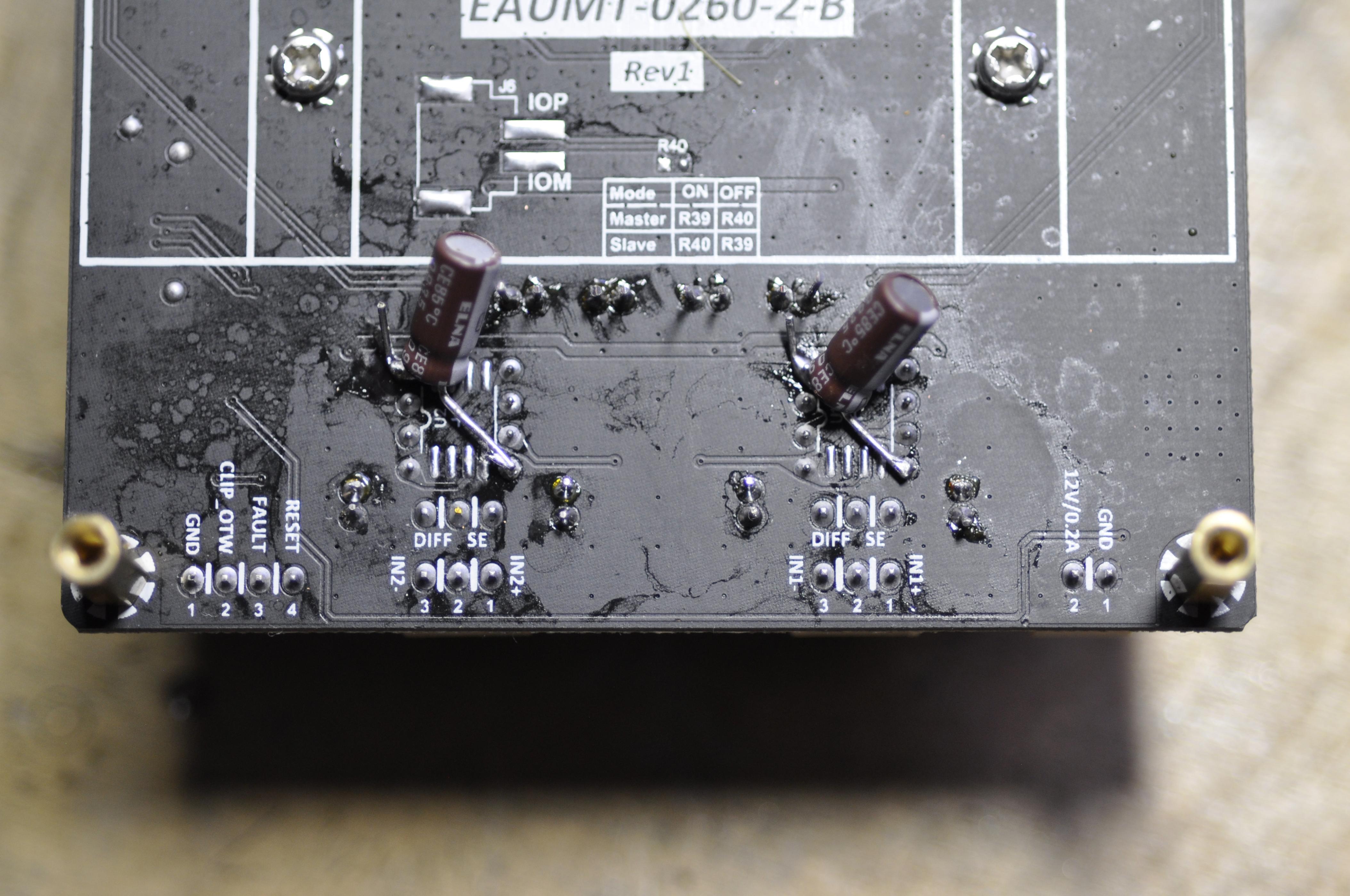

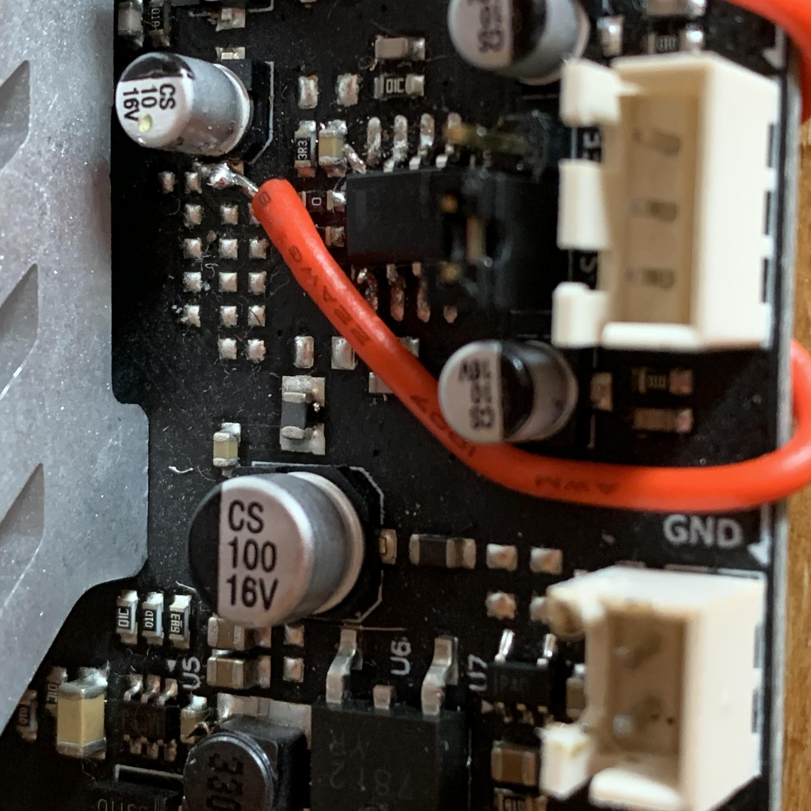

My mod
This is the mod I made. I lifted the 1 leg on each op amp to remove their power. I wired the source sockets to the SMT caps, this was very tricky and tested my soldering skills (these caps can also be bypassed by soldering the wires to the other side of those caps). I will post the Panasonic caps I used later, I need to look it up. I did not try out the balanced DAC I used before I made the changes which means I can’t make any decent comparisons. However the DAC was a Scarlett Solo which is good but not expensive. The overall improvement was really impressive. It sounds less bright with much better midrange and bass without sounding boomy.

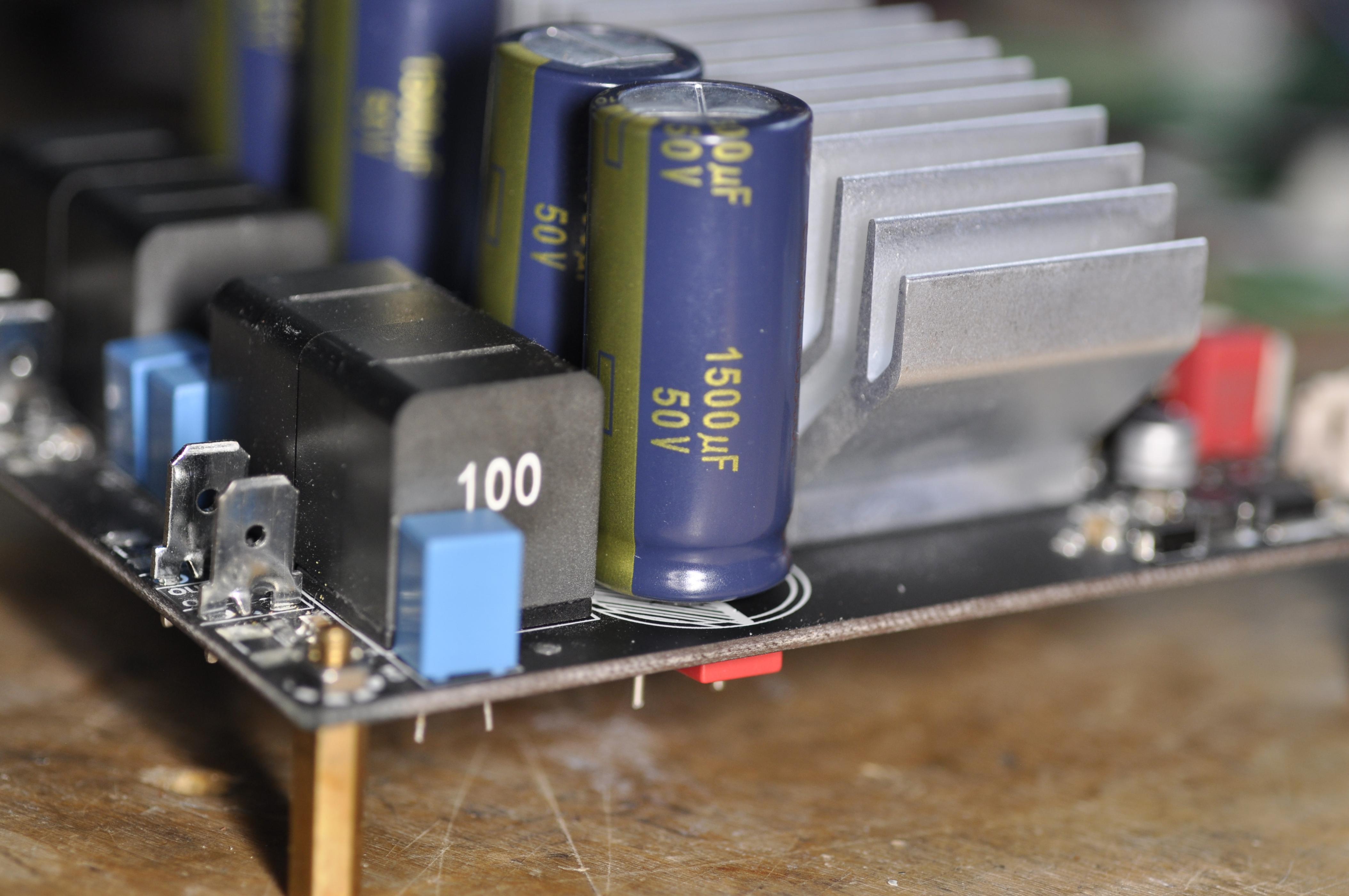

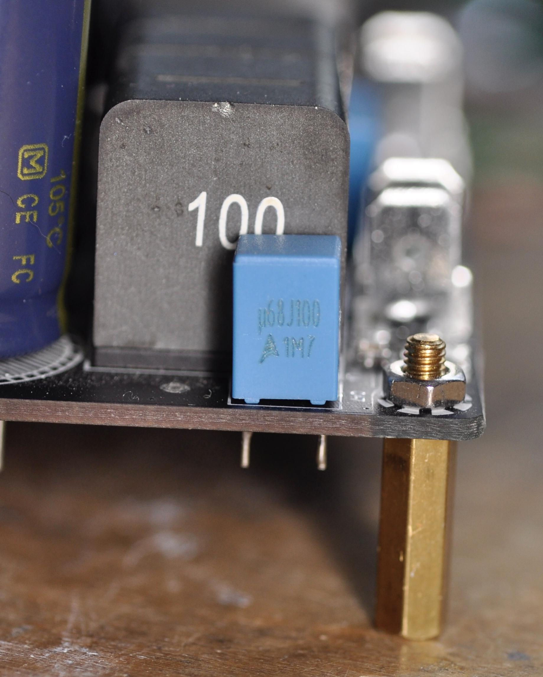

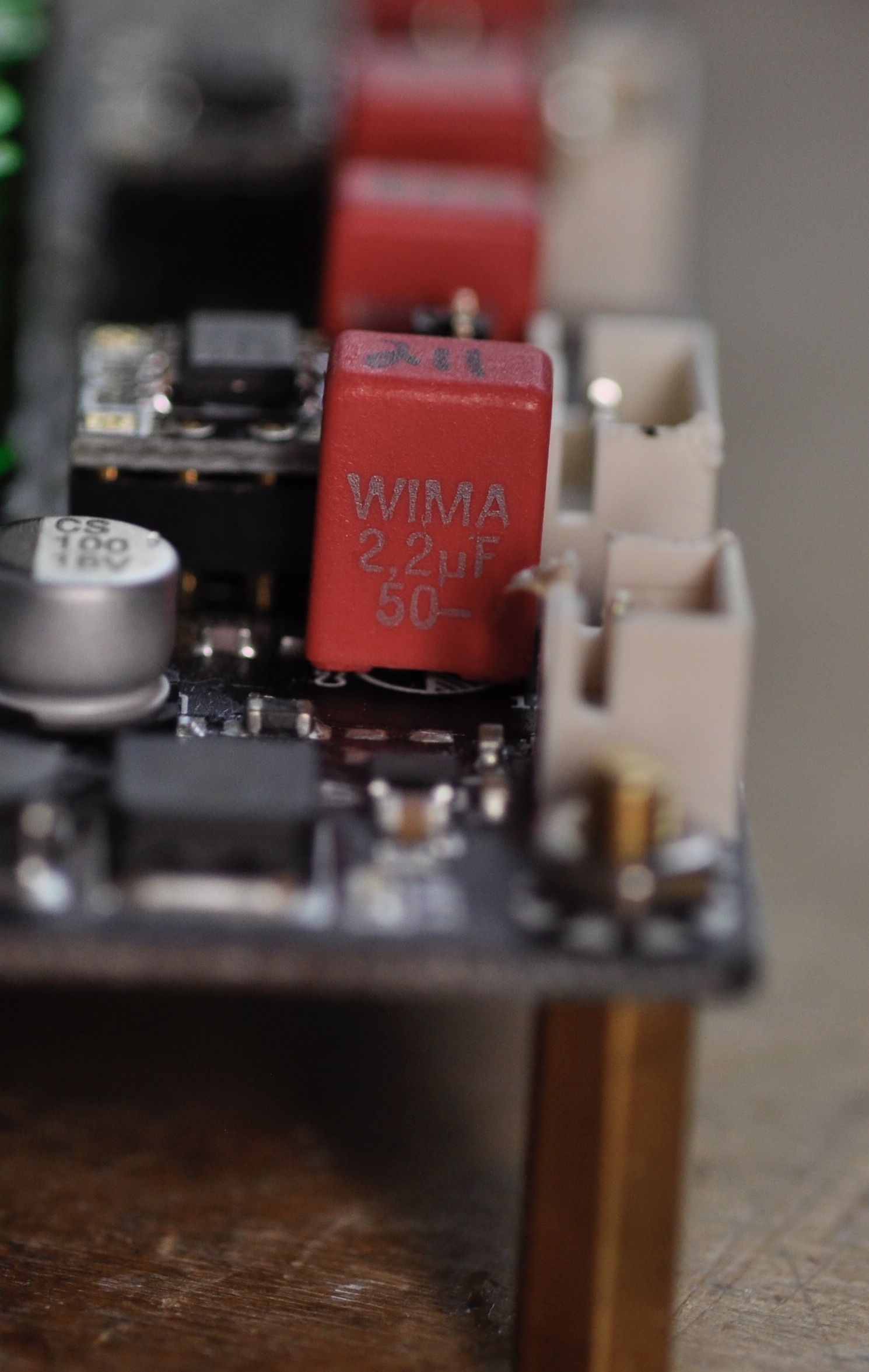

Here’s my mods..again, SE input..big cap bypasses are 1uF WIMA MKS right now but will try 4.4 uF once parts arise.
Merry Xmas
Pete
Nice job with the older, trickier board! It wasn’t clear to me..SE or Balanced input? The newer version board makes everything a lot easier.
Pete

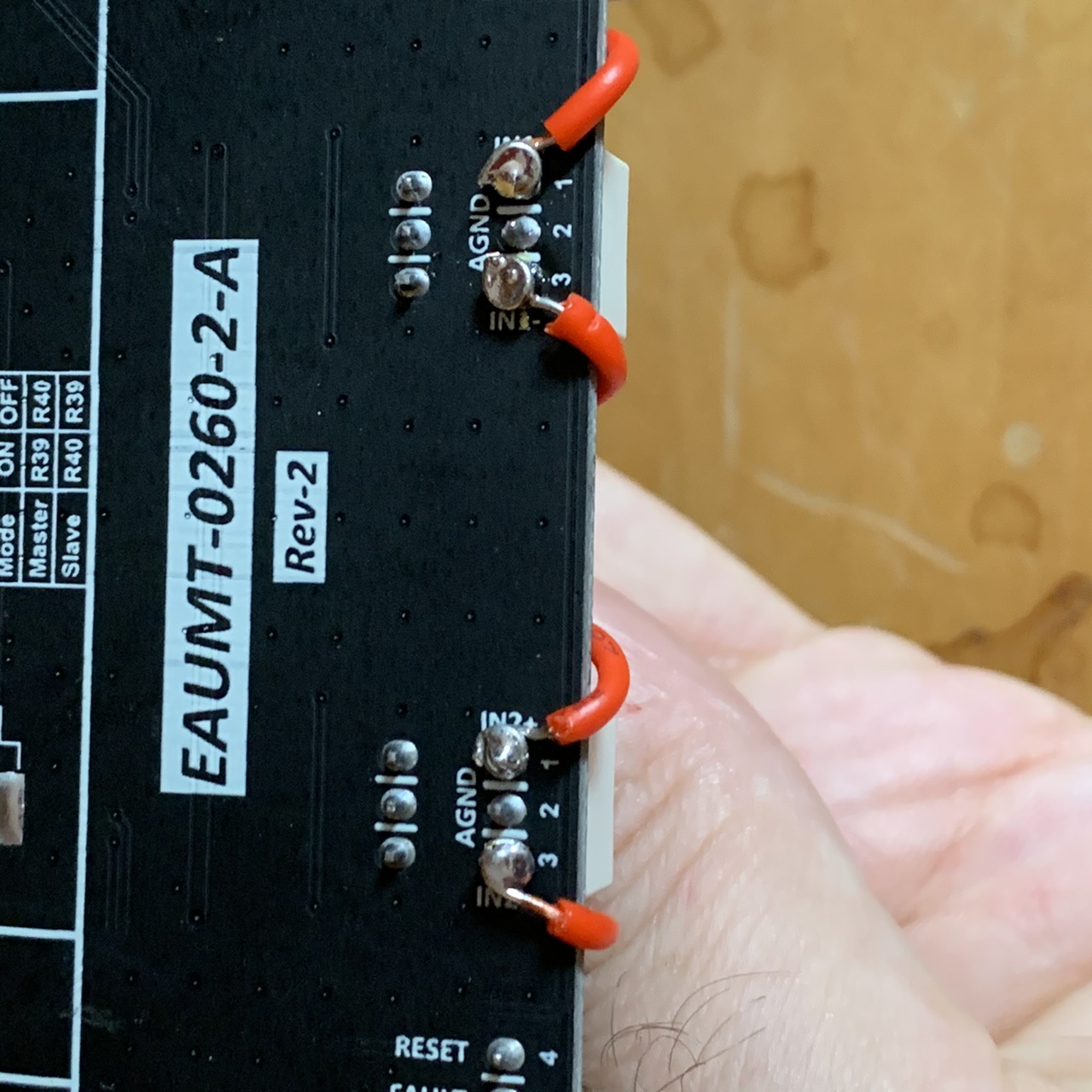

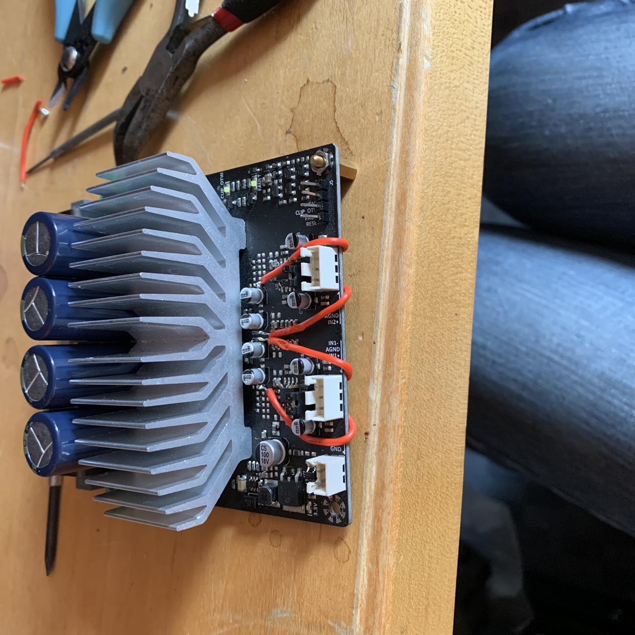

You can copy ElliJ's bypass-opamp mod. It will also bypass the DC-Blocking caps for the opamps.
For JLE board:
- Remove SE/BAL solder jumpers
- Remove opamps from sockets
- Connect J1-1 to socket A pin 1
- Connect J1-3 to socket A pin 7
- Connect J2-1 to socket B pin 1
- Connect J2-3 to socket B pin 7

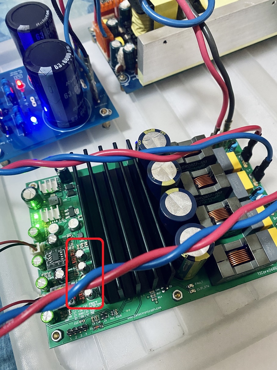

For future reference and in case anybody wants a nice 2.1 amplifier, I managed to put one of the chips into PBTL mode on the following board.
It was clear that the board had been designed to allow of changing of modes, but I was not able to get my hands on any documentation.
So I might have done it the wrong way, but the amplifier is working great now in PBTL/mono mode. I basically just had to ground one input and change the Mode2-pin of the chip.
You can see below here how I have managed to do it. Red are components which must be removed. Green are added shorts (solder).

Hi ElliJ,
I want to make this change.
I am using the PCB in SE mode and unbalanced, is the bypass correct in SE mode?
Denis
It can only work in balanced. When in SE it creates a balanced/differential signal with the 2 dual op amps. I am a mechanical engineer not electrical, someone else here can confirm.
