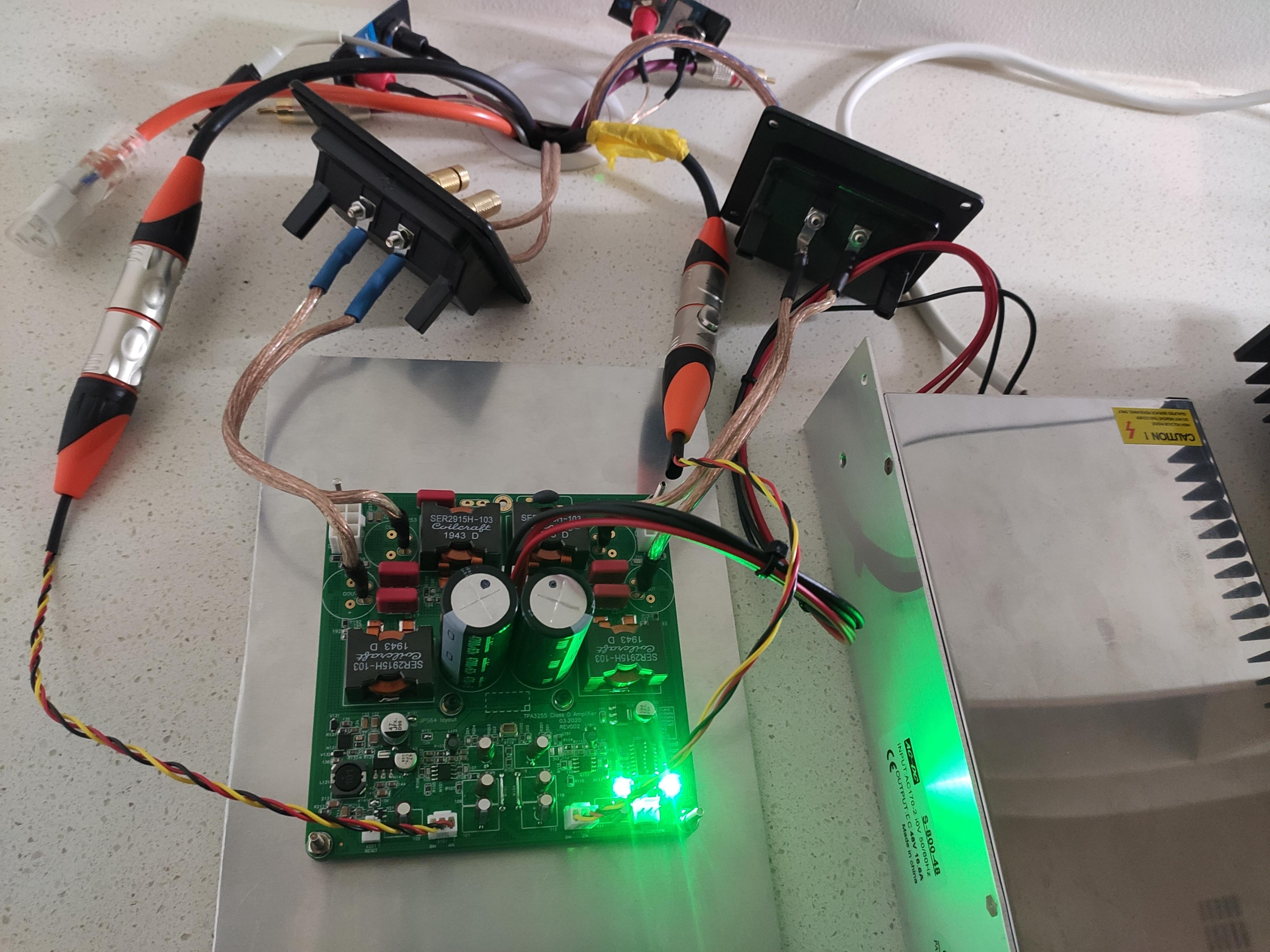

So when I would like to connect the RCA input into the BTSB what I need to do when I want balanced output? The neg_input from BSTB connect to ground? Because I all the time thought that LME49724 need positive and negative input and works as only as a spec amplifier.
connect the RCA center to +, shield to -. The better way to do it is with 2 wire + shield mic cable. Then you would connect RCA - to the - wire and shield at the RCA connector side. At the BTSB input connect RCA + to BTSB +, RCA- to BTSB - and shield to the X input.
I think Jhofland explained they input to the BTSB. On the BTSB output, there are 3 pins. The middle one is GND on both BTSB and TPA3255 balanced input. The two on the side are +ve and -ve phase out. Pin 1 (square pad) is +ve phase. On TPA3255 board, The +ve input for Ch1 is A_input and -ve is B (pins on either side of middle pin) and for Ch 2, +ve is C and -ve is D. Just make sure phase is not flipped on one otherwise you won’t have much bass.

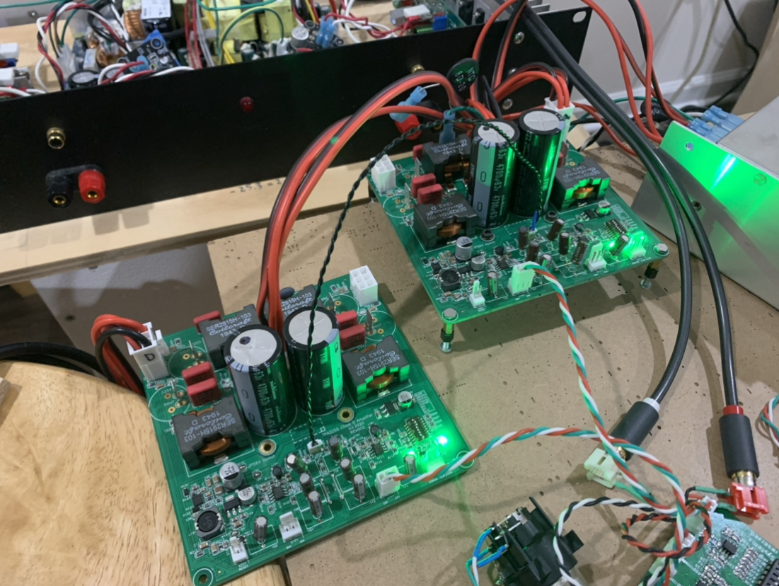

A bit late to the party but I setup a test rig to listen to the amp in my main system. Nice sounding amp. Thanks X!

I just verified that the Master/Slave mode for frenquency sync between two amps works well. Just need a WR-WTB 1mm pitch connector cable from Wurth. On slave amp, flip DIP switch to slave. That’s it.
attachment.php
These are the parts you will need from Mouser:
2x of WR-WTB female connectors 710-665003113322
2x of WR-WTN precrimped 12in wire assemblies 710-665165128130
Connect pin 1 to pin 1 and 2 to 2 for same polarity sync and flip for negative polarity sync.
