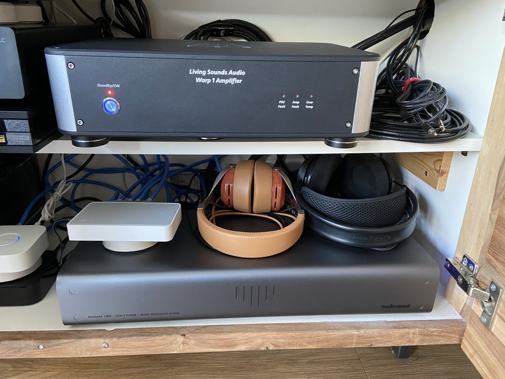

Hi Richie,
Thanks for your praise of the Warp-1.
You may have heard someone say that “it is an AHB2 killer”, but that wasn’t me. If they said this based on their listening impressions comparing the two, that is great. I did not directly compare the two but based on measurements alone, the AHB2 has better figures, whether or not that equates to better sound, is up to the listener

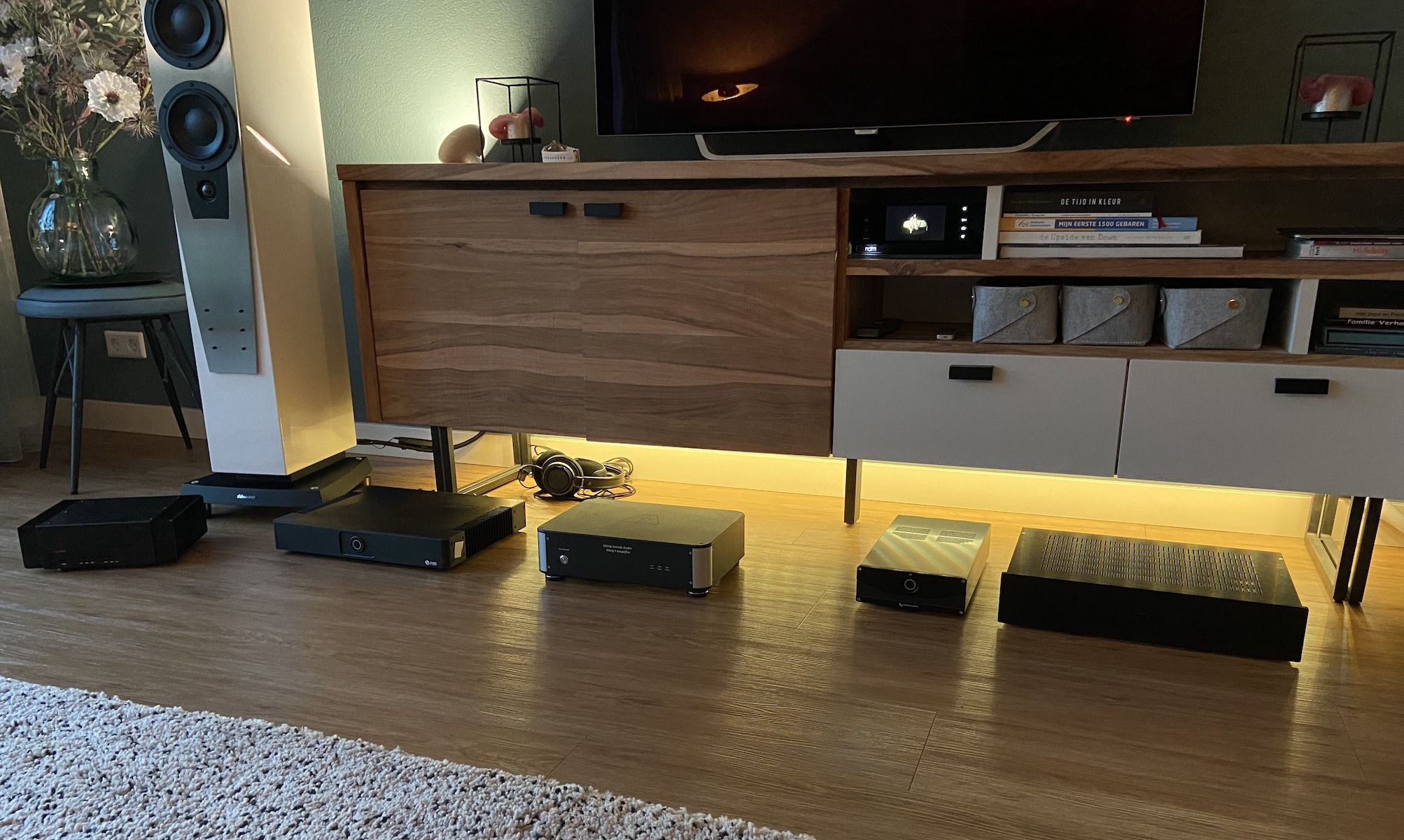

So, we did a shootout for several power amplifiers at my place earlier this week. The contestants were:
Here they are:
We connected all amplifiers one after another to my Naim Atom HE preamp using Grimm TPR XLR interlinks, loudspeaker cables were AudioQuest Castle Rock and the loudspeakers Dynaudio Contour S 3.4 Limited Edition. The subwoofer remained off during all listening. I use an AudioQuest Niagara 1200 with Monsoon and NRG-Z3 cables towards the equipment.

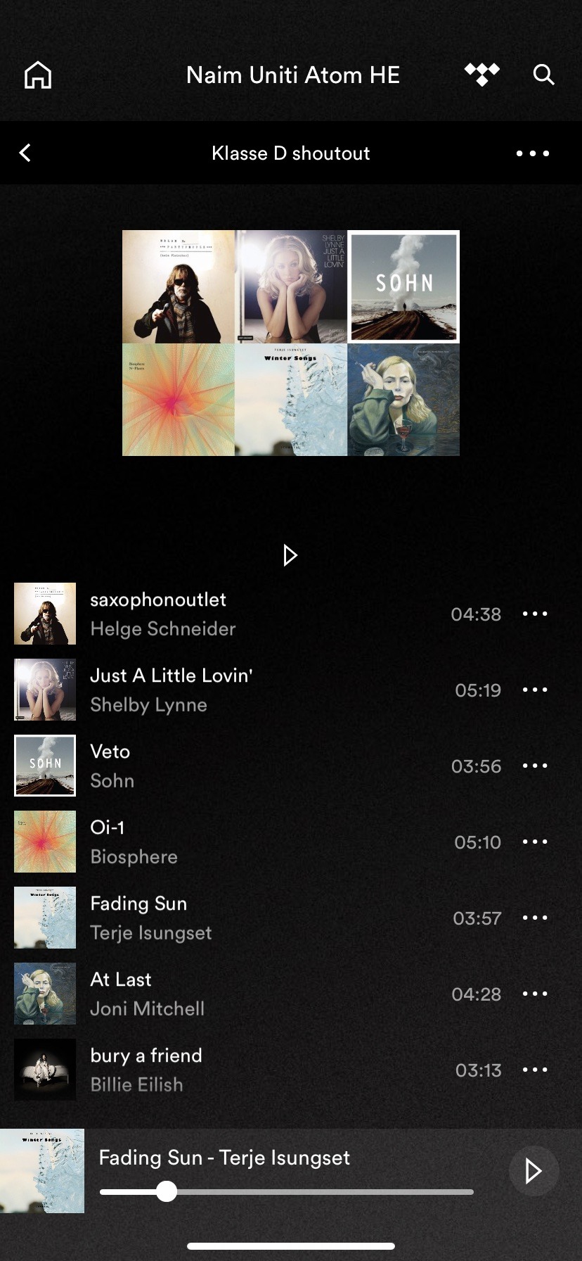

We used one playlist. See below.

Here they are:

You “mess” is pretty nice is you call that a mess, my lab is a tornado disaster zone. 🙂
Thanks for your comparison - very interesting and I am glad you found Warp-1 great sounding against some very formidable competition! Everyone says the bass on the Warp-1 is outstanding. This must be the result of the implementation. There is no “EQ” or response shaping done. The input buffer uses OPA1656 and OPA1637 balanced driver. The TPA3255 amp board uses NE5532 opamps. What I think is responsible for the bass is the low impedance circuitry: an over spec’d custom 600w SMPS, 2oz copper traces that are double layered and stitched together vias on the PCB for all high current traces, doubled up high current silicone RC drone motor wires for the PSU and speaker output binding posts, and pure copper 8mm diameter Viborg binding posts. Little details like this - together, make a difference in the bass.
