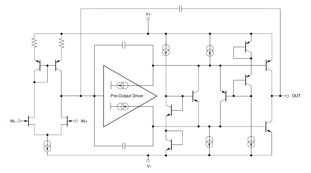

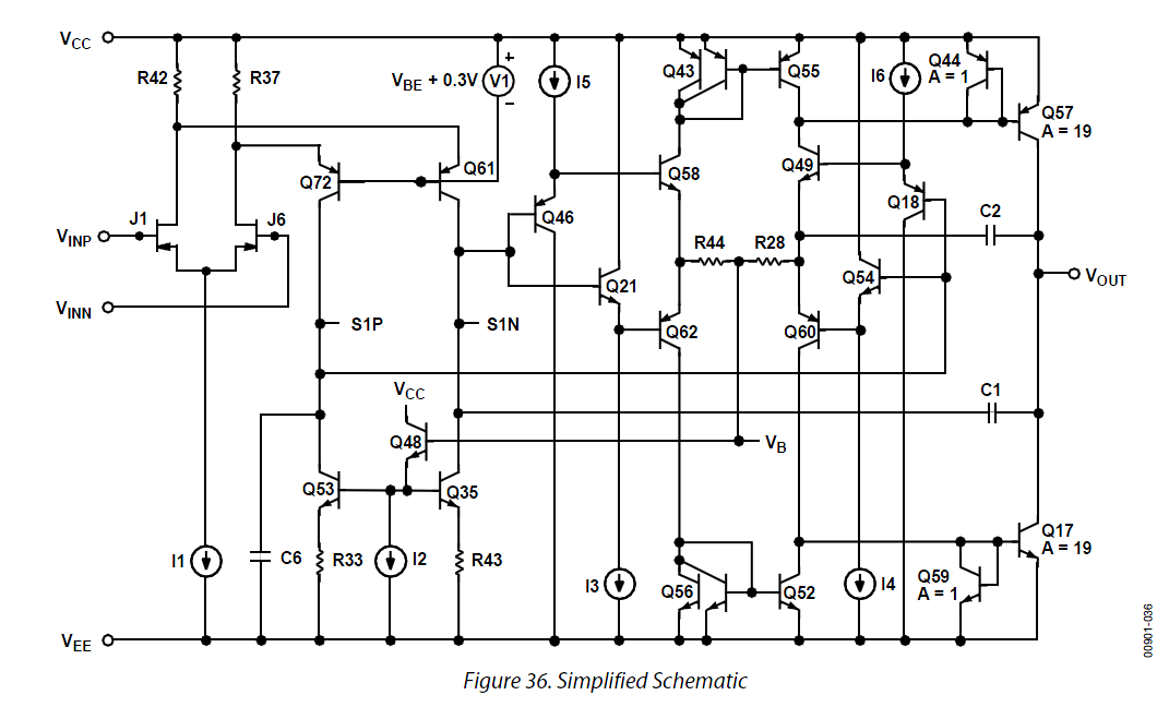

just a couple of output inclusive Ccomp op amp datasheet simplified schematics (AD823, OPA164x):

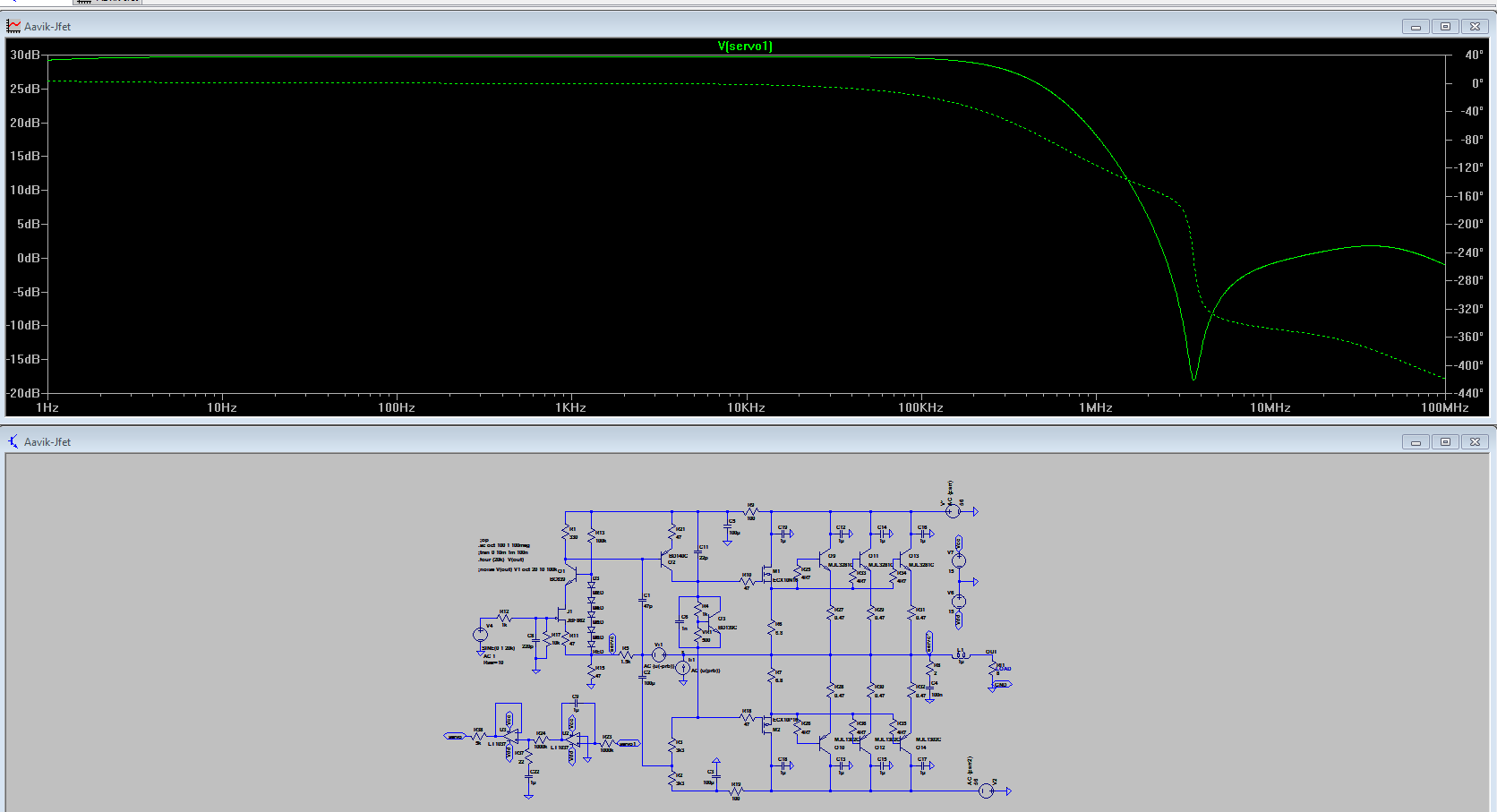

Not really sure what the tian probe i trying to tell me here, all looks stable with app 20 degrees phase margin, but when I insert the tian probe it doesn't look so stable any more, why is the gain coming back in the MHz area..?? I suspect it's due to the nested loop
I am not really sure what you mean.
What you have plotted is not the Tian probe response, it looks like the closed loop.
A Tian probe should never make a difference to the stability of a circuit.
I can't read the circuit clearly, if you can post an ASC it would help.
