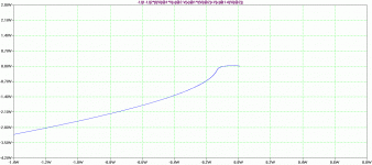

Like this one? How would you interpret it?
Damir
The Nyquist curve you show approaches the origin from the bottom so is likely to stay far from (-1,0) and be very stable. It's GM is essentially infinite.
However, I would really like to magnify the region near (-1,0) and the origin to check on this.

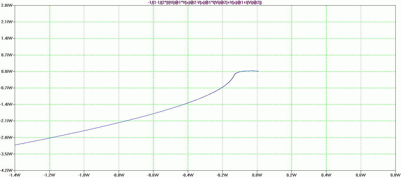

Is this better? And it is not infinite GM, it is 21 dB. This is Nyquist curve from my 200 W CFB amp and it uses a kind of Cherry compensation(TPC but connected to the output not to the VAS/TIS).

GM of 21dB is 'essentially infinite'. No sign of peaking at all and very stable at that frequency.
Draw a unit circle at the origin to find the PM, where it cuts the Nyquist. This is the ULGF so its about 30. You can probably adjust the compensation to get better PM (cut the unit circle further from (-1,0) and reduce some slight peaking at the ULGF.
Bode's 'recommendation' is PM 45. Sorry Dave for simplifying Guru Bode's recommendations! :)
Cordell shows some PM & GM numbers for peaking. These aren't exact (and can be very far out) ... but its a useful guide. If it's easy to adjust both PM & GM in your amp, you can try this and check (by plotting Close Loop response) how applicable his chart is to your design.
Du.uuh! You can only estimate PM like this if the x & y scales on your Nyquist plot are the same. Your PM is actually quite good and much better than 30.
Sorry. :eek:
Try the attached Nyq.PLT. Rename it from Nyq.plt.txt

PM is 74 degree and I showed both "inner" and "outer" Tian probe in here http://www.diyaudio.com/forums/solid-state/243481-200w-mosfet-cfa-amp-17.html#post3675331.
