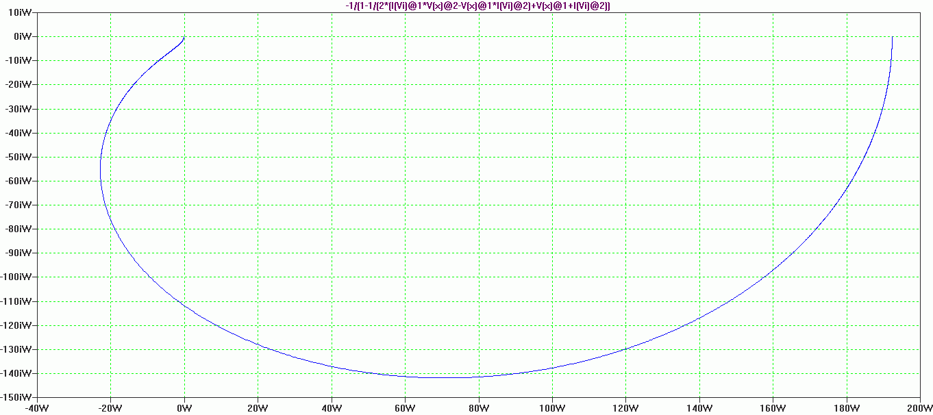

LTspice has a nice Nyquist plot.
Like this one? How would you interpret it?
Damir
Thanks Richard, I certainly appreciate PM and GM are just two points on a Nyquist plot.
Your appreciation is excellent. I spoke too soon when I expected to improve the compensation easily.
...(when I have time), I will move over to LTSPICE, but I must admit when I tried it years ago, the user interface put me off.

PM & GM are just 2 points on the Nyquist Curve...
Horowitz and also Lurie discuss the shape of the curve near the critical point.
On a Nichols plot a specified GM and PM leave a rectilinear shape.
A smoother shape is possibly better.
I think it is pretty much academic because in practice there is not much control at that frequency and the curve is inevitably smooth anyway.
2 points looks sufficient to define the stability in practice I think, you don't?
