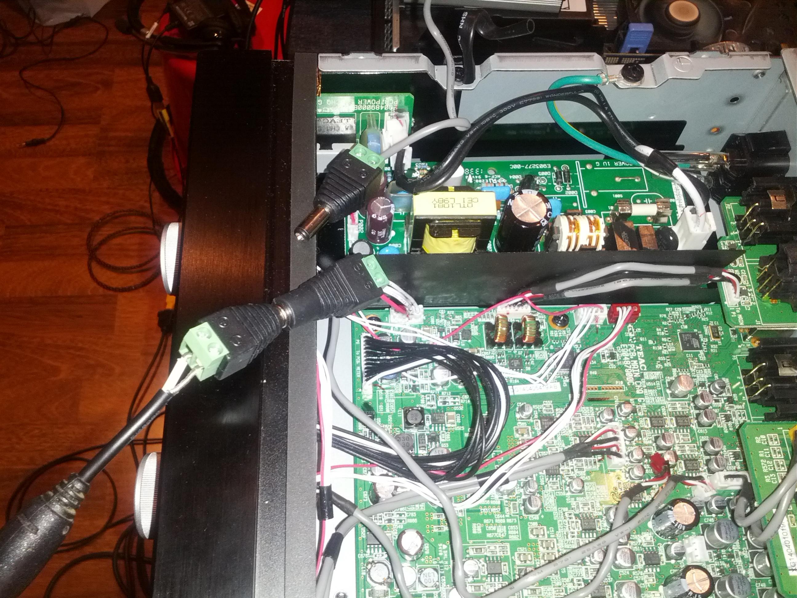

I have just one power input on the circuit board actually.
Btw about which dac we are talking about? MF?
Well it is a commercial usb soundcard, not diy.
People have measured some spikes in the noise and the guilty happens to be the original smps.
Some people have decided to live with that saying that is low in level.
Others have replaced the smps.
I am thinking about replacing it trying to avoid to destroy anything.
I have seen a current draw of about 450 mA at 12VDC for the circuit board.
I am attaching a picture of the unit under testing.
Thanks again and kind regards, gino
Hi. MF is commercial dac ...Musical Fidelity.
That i was talking about...after big smps you have some more small smps regulators around pcb....they destroy excellent performance of Tps reg. Take scope and measure and you will see. Problems with smps is also huge gnd polutting with noise.

Hi ! yes I see your point.
However I am trying to get to the best performance that this unit can provide.
My thinking is that supplying it with the cleanest 12VDC possible is the way to reach this limit.
In this way I could be sure that the power supply is not the problem for not excellent results.
I am testing different psu and for now the results are quite similar aside some bad cases. But I am still in the testing phase.
But I understand your point. It is a very common solution these days for usb soundcard, even good ones.
They have DC to DC converters on board to generate all the different voltages necessary for the various chips.
Thanks a lot again, gino
Yes first connect Tpsxxx from Ales then go on if you want do something more change this 3..4.. regulators this is 2hours job. Maybe check if regs have enable disable pin or function to not have problems with startup or similar reset functions... almost all Ldo regulators have on off pin. And carefull...some have max input of 5.5v...with Mravlcax regs...no problem with that.

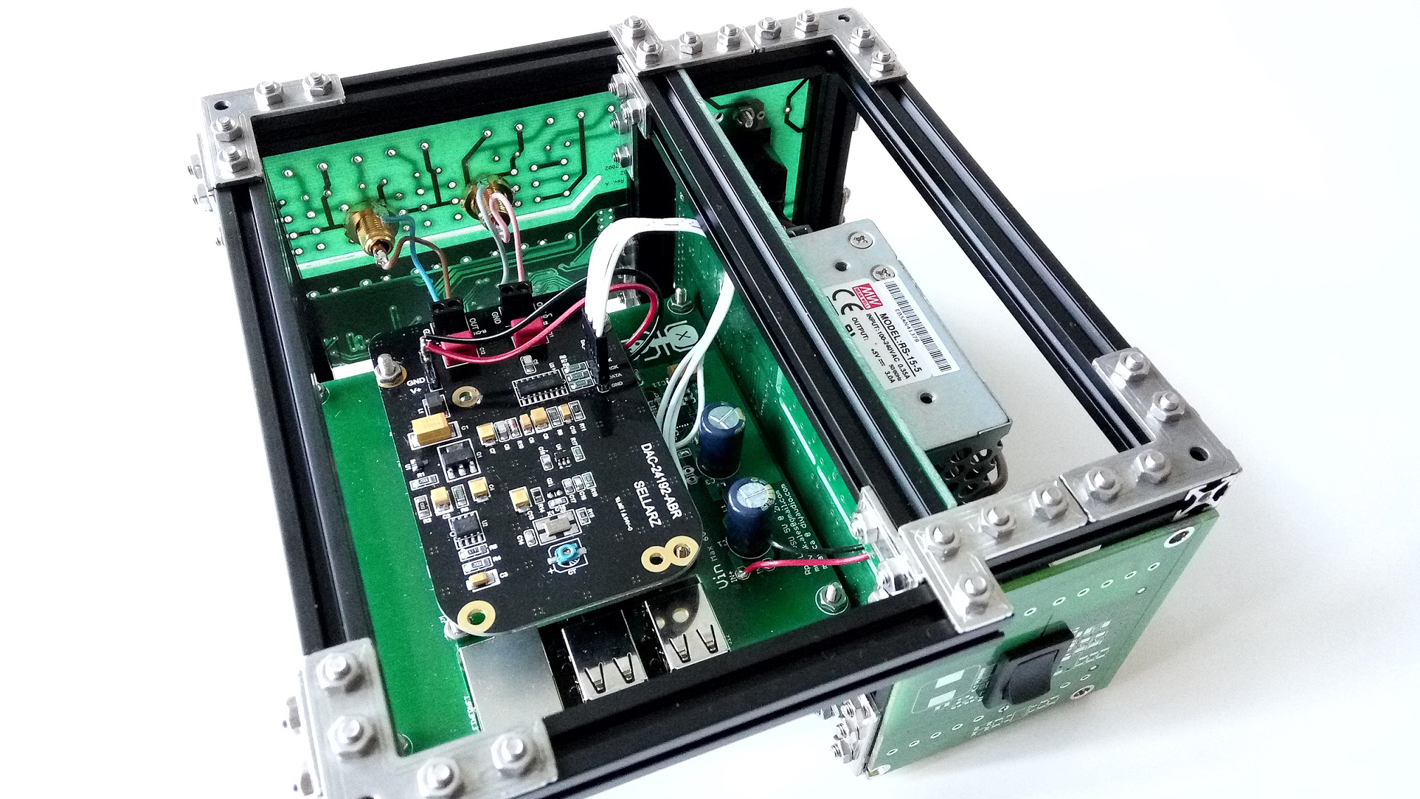

Hi!
1. Yes this is possible. In order to supply PCB with DC voltage you can bypass diodes or solder wires after diodes. As you can see in this picture all diodes also have two vias.
2. It should work. But I really don't see any benefit in that. Ifi power supply already has low noise levels. Which model of Rpi are you using?
Option that I am currently using is TPS7A8300 regulator board that goes in between Rpi and DAC.
Best Regards,
Aleš
