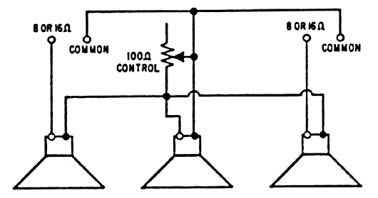

You can wire three speakers Trinaurally in a very simple way to form a matrix (abandon the input resistors in this case)
Ls = L - 0.5*R
Rs = R - 0.5*L
Cs = 0.5*L + 0.5*R
- Elias
