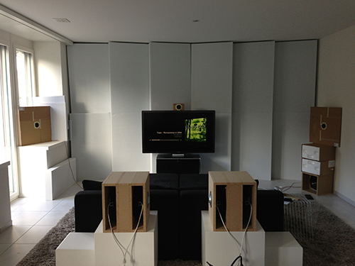

I'm getting very good results with L and R placed about ±45° at the side walls (no center):
Just speculation, but I believe the good performance has to do with the way the speakers perceptually couple to the room's reflection pattern.
The level and timing of the contralateral reflection seems to be crucial.
What about head turning ?
And what about off center listeners ?
Have you tried to compare with center speaker ?
Both a no-go.
Not yet.
