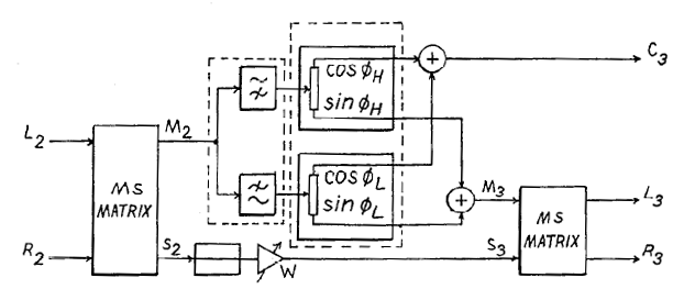

Which is a forerunner of the "energy-preserving matrix decoder" which in turn is a forerunner of the "frequency-dependent energy-preserving matrix decoder" to which I'm listening right now
(From Gerzon's AES convention paper #3180)

Last week I was listening to a 2-> 3 matrix with coeff 0.5 in Reaper (I'll upgrade to Markus' script, thanks for posting that). For the afternoon I'm using Dolby PLIIx from my soundcard (Xonar) output.
What exactly does it do frequency wise? It cuts up processing band by band, but how? The Wikipedia article doesn't really say. Or am I totally mistaken and it is just a sqrt(2) center if I'm using 3 speakers.
If you use the energy-preserving code then remove the 3dB attenuation for the center. Simply replace
Code:
c_out = 0.7071*m_c;
Code:
c_out = m_c;

Just for the sake of completeness here's the "final" Reaper code for a energy-preserving matrix decoder after Gerzon:
http://mehlau.net/audio/matrix_decoder/
