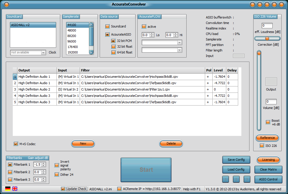

You can try it yourself 🙂
AcourateConvolver - AudioVero
Set it up like this:
attachment.php
It is interesting to note that Gerzon energy preserving decoder for below 5kHz gives speaker signals for mono signal (L=1, R=1):
Ls = 0.577
Cs = 1.15
Rs = 0.577
so
Cs = 2*Ls = 2*Rs
which is the same ratio as Trinaural decoder for mono signal
Ls = 0.5
Cs = 1
Rs = 0.5
Cs = 2*Ls = 2*Rs
This means that for freqs below 5kHz they present the same phantom imaging for center panned sounds.
