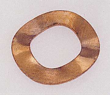

GregGC said:
I'm not too crazy about that kind of attachemen to the heat sink as the chip starts heating up the plastic will start expanding and ..... crack. And if not "crack" at least a lot more compression on the chip inside. Unles you have some kind of spring-loading construction.
Greg
actually, as the thing heats up there'll be less compression 'cuz the metal bolts (longer lengths needed in this sort of arrangement) expands more.
So spring washers (nice beryllium copper ones are cheaply available) are useful, not to ease pressure, but to maintain it over the heat cycles.

blurb:
"A range of beryllium copper crinkle washers in both metric sizes. These washers have good corrosion resistance, are non-magnetic, and have high resistance to permanent set under compression. They have a number of uses including use as vibration-proof locking washers that will not mark or damage panel surfaces."
