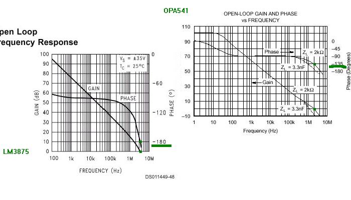

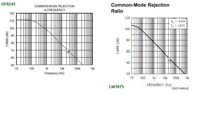

hitsware said:FWIW ..... I think the PSRR is not quite as good.....??????
Strange, I can't find the PSRR in the OPA541 data sheet.
And it should be a lot less prone to oscillations. I may be wrong but it looks like that according to the data sheet (45 deg. more reserve or 10 dB gain reseve at 180 deg. in favour of OPA541). Though at 30dB gain they are both good.
!!! OPA541 has a lot more THD at 0.1W/1kHz compare to LM3875 0.35% vs 0.015%). At 5W and up they are the same.!!! I don't know how vital that is. I suspect it is.
I guess LM3875 would sing better at low volume. Plus with wider frequency response (200 kHz vs. 50kHz at 30dB) will be even better.
I don't see it either.......Guess I was thinking of the 549 ....
