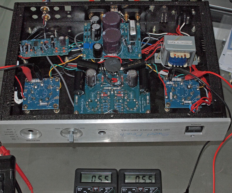

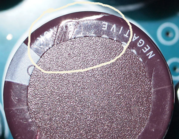

Today I received my amp but unfortunately it came with a lot of damage, the top plate was crushed by the weight of the transformers.
The transformers were almost torn, and inside the large capacitors are pushing the bottom plate.
The weirdest part is that the shipping box has no damage.
The only positive part is that despite so much damage amplifier works well and the first hearings show that has potential.

Today I was off and I decided to change the capacitors, the amplifier still works and the improvement in sound is huge . (I'm starting to feel happier, this may turn out to be a good opportunity to learn).
Now I'm looking at the list of modifications of the post No. 81 made by Globulator, and the “general part” is completed.
On the part of “Input section (6N3s)” I have doubts, can I make changes in this part without changing anything in the “Driver section (6N1)” and in the connections of the transformer, or are these changes linked to each other?
If I can change the "Input section (6N3s)", would anyone please post a picture of that section with the resistors, capacitors and FB components marked (I would not want to remove the wrong parts).

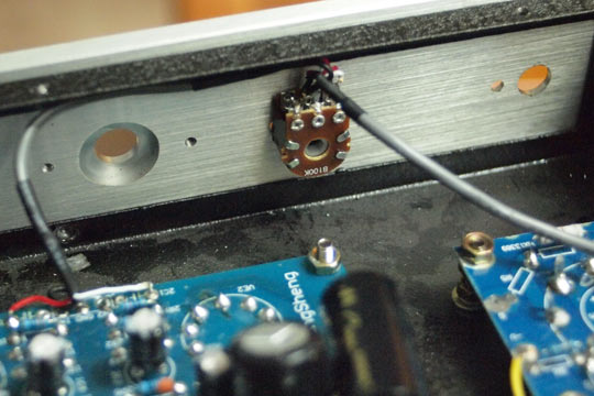

While you rebuild the box you may wish to put an ALPs motorised pot in, there is a small one on eBay I bought (100k log) 100KDX2 which should fit OK, I have not fitted it yet though. I also need the remote controller..

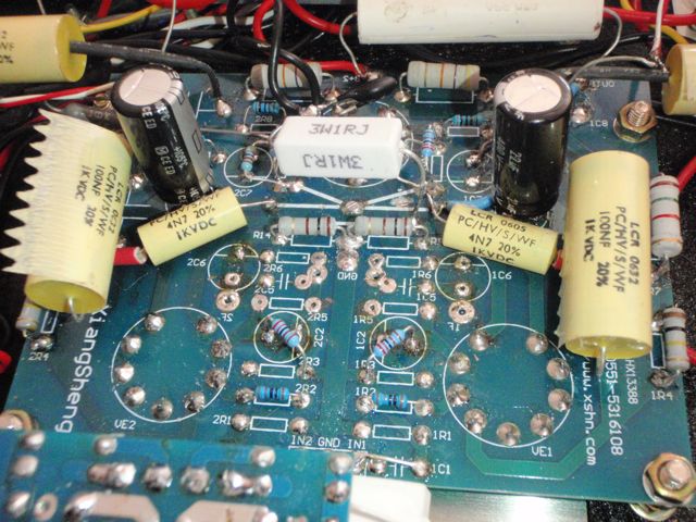

Changes to 6N3 input stage:
- Repalacing 1R5 and 2R5 by two 2.2 k resistors - (nr. 1 in picture)
- Remove the 220u cathode bypass caps 1C2 and 2C2 – (nr. 2 in picture)
- Unsolder the FB wires and free from the tyraps 1F and 2F - (nr. 3 in picture)
Optional - remove all FB components:
- Caps 1C6 and 2C6, - (nr. 4 in picture)
- Can I remove also Caps 1C5 and 2C5 ? - (nr. 5 in picture)
- Resistors 1R6 and 2R6 – (nr. 6 in picture)
- Can I remove also Resistors 1R3 and 2R3 ? – (nr. 7 in picture)
- Big Cap, should I remove this one to? - (nr. 8 in picture)

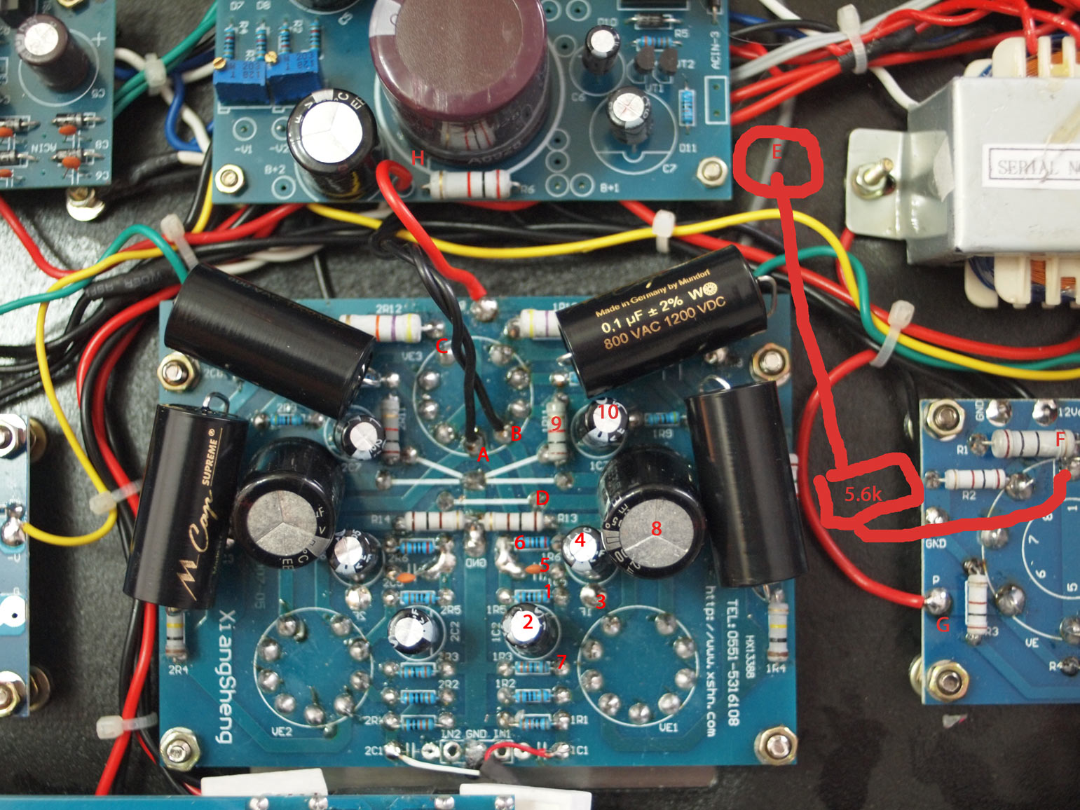

Changes in Driver section (6N1 to ECC82):
At this point I start to have a lot of problems, there are a series of links that I can not figure out.
Rewire for parallel filaments:

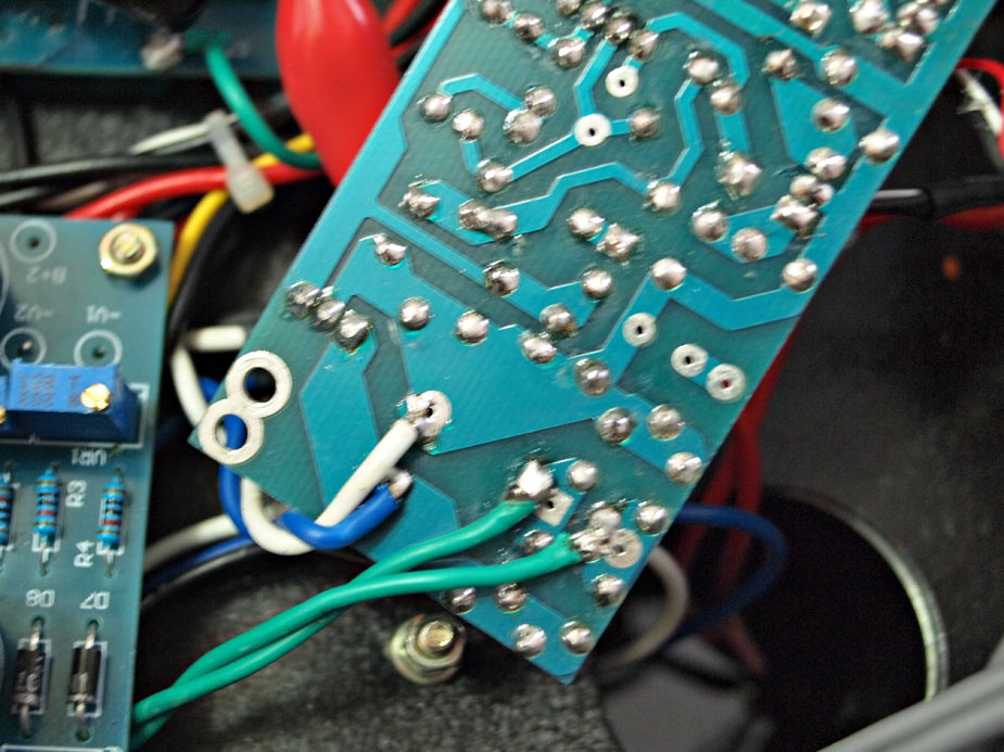

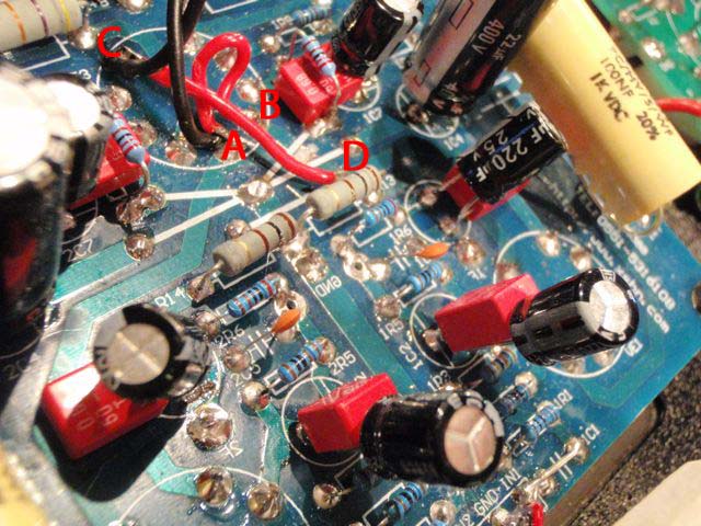

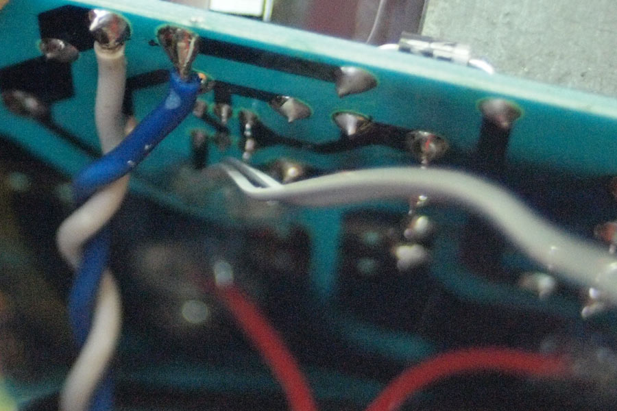

- Loking to your picture I think I should move the black wire from position B to C, a Make new link from position C to D, I also should connect the A position to B.
- I can not figure out what is the track that I should cut, please can you post a picture with the track that I should cut?
- Adding an NTC thermistor, Can you tell me please what thermistor should I buy? How should I connect it to the ECC82?
- Replace the 1k cathode resistors for 1.5k, Is it the nr. 9 in picture?
- Remove the 220u cathode bypass caps, Is it the nr. 10 in picture?
- Change the negative feedback, if I understand it, I must connect 5.6k resistor from the FU50 grid to the feedback wires.- (E and F in picture).
Transformers (Swap the wires around) :
- In this photo you can not see the wire connection to B+ but I think it should be at the back of the circuit board near the H position, I also think that the red wire that connects the Transformer to the FU50 is the indicated at position G, am I right?

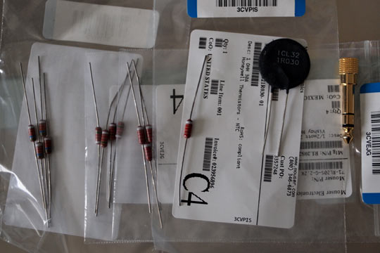

List of stuff to buy:
- Two 2.2 k resistors (how many wats? any recommendations regarding the type or brand?)
- Two 1.5 k resistors (how many wats? any recommendations regarding the type or brand?)
- Two 5,6 k resistors (how many wats? any recommendations regarding the type or brand?)
- One NTC thermistor (I have no idea what to buy)
- One ECC82

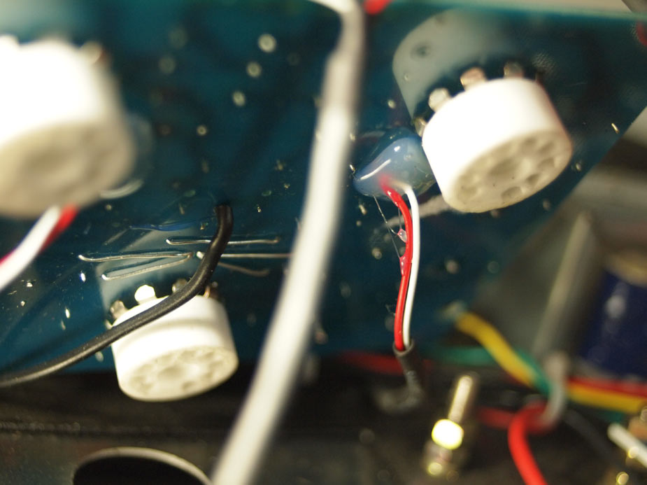

Ok - some more careful reading of #81 required I think!
Based on your first picture this is the change list, based on the red letters. I describe one channel - obviously the other channel needs doing the same.
Starting point (remove bypass and feedback caps)
Remove caps 2, 4 and 10
ECC82 filament mod (not needed for 6n6p):
Cut track from B to D, and move wire from B to D
Bridge A and B
Connect a new wire from D to C (I added NTC here)
- no idea what type of thermistor as I got it from a broken SMPS
- you could try a 1 or 2ohm resistor to start
ECC82 bias
Replace res 9 with 1.5K
- 0.6W metal film will be fine
DN3 bias
Replace res 1 with 2.2K
Feedback
Unsolder feedback wires at 3 and wire to top of res 9 (ECC82 cathode) via a 5.6K res
- I did this from the top, no need to remove board
- red and white are in parallel (connected together)
- This bit is difficult to do in a tidy way
Invert transformer primaries (beware electric shock!)
- this means swap the red OPT wires between B+1 on the PSU PCB to G on the FU50 PCB
(OPT = output transformer, the red wires go to the primary and connect the power into the big FU50 output tubes.)

Hello Globulator, thanks for the help,
I just returned from work, and if you do not mind I have some questions.

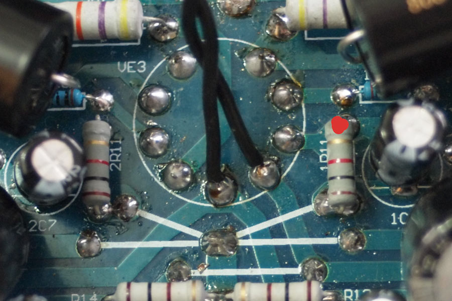

You said in your instructions to connect the feedback wires to the top of the resistor, please confirm whether the correct position corresponds to the red point in photo.
Initial searches on ebay and I only could find the 1W resistors, can I use those?
NTC thermistor the smallest I could find is 5 ohm, is it to much?
Cheers
Cheers
Any resistor of 0.5W or over will be fine for all the changes.
The red dot is the correct place (the tube cathode - check out the pinout of the ECC82) for the feedback mod.
Tube datasheets are your friend - Google for "ECC82 datasheet" to find them.
Do the other mods first and make sure the amp still works
Then discharge all voltages to zero
Then do the feedback mods.
ETA: Thermistors vary with temperature - you just have to try them out, it's just to stop the filament shock, try one and measure the voltage before and after - you are aiming for 6.3V. Don't worry about this bit too much until you get the rest working, if you are stuck try a 1ohm resistor instead.

There is however a board I would like to remove but it seems to me that I can not.
The board is that the left side of the power board, this board is connected to the power transformer by two green wires that after passing a set of four diodes and capacitors is connected back to the ACin3 on the Power board.
If I disconnect the green cables the amplifier stops working, and I think I can not connect those directly to ACin3, because the sets of diodes are converting AC to DC before send it back to Acin3. Can you please tell me if my reasoning is correct?
I have been looking at the bottom of power board and I'm expecting a very difficult work to redo the soldering when changing the new box (why they had to leave the wires short?)
Today I received some parts, the thermistor is a monster in size and the resistances, while being of 0,5W are also big. (I'll have to think what will be the best way to fit these monsters).

I'd wait for the case, or bend back the old one
Your photo with the pot is interesting, I will wire my driver circuit point to point later because I want to use an Alps motor pot there, but the driver board is in the way!
I quite like the selector actually!

Hello Globulator,
I have some good news, today I had time to make the "Hot Sugar mod".
Grid voltage on the ECC82 is 5.5/5.6 and on the 6N3 is 4.5/4.6(maybe a little high?).
The best part is that nothing is burned, I was not electrocuted, and the sound is really good , none of this would have been possible without your help, again thank you Globulator.
When I was doing the soldering I slightly melted the coating of some capacitors, will I'll have problems with this?

Excellent!! Do you like the sound? It will vary depending upon your speakers a bit - but I think it has a good solid yet relaxed quality. The ECC82 is right in the middle of a nice linear region there - combined with degeneration it's probably the best they sound!
The caps look OK - if you are worried make sure the ones going to the output GU50 tubes are perfect - that's the tube you do not want turned fully on!

So try 45mA (0.45V) and see how it sounds - if it's good enough (no clipping and sounding solid) leave it there for a cooler power transformer.
Your thermistor disc is huge - twice as big as mine!! Should be fine though, you only need about 6V at the filaments and not to see them 'glow' like a lightbulb when you switch on!
The capacitors across the B+1 and B+2 are there because I 'know' the electros need bypassing. I only had a 0.1u for the B+2 (I mounted that on the driver board) - not sure how much that does, there is a 5uF on the B+1 board, that is a motor start capacitor from an old central heating pump that died! I think that tied the sound together a little better but the effect will be subtle.

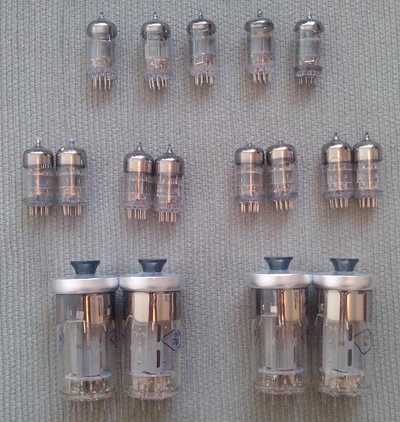

The sound seems to already have won in detail, but I also exchanged tubes today so it is premature to reach conclusions.
I replaced the FU50 by GU50, but two tubes I bought do not seem to be good.
Cheking de bias, in one tube voltages jumped randomly to eventually rise to more than 10V, this resulted in some smoke out of the tube soket ... the other tube also showed random voltages and ended up with a purple color... so I bought four tubes and two went to the trash.
The other two tubes, showed a bias of 0.4, much lower than that of FU50, maybe the GU50 and FU50 are not exactly alike?
In the end I got the GU50 + 6N3-DR + Hytron audio 5814A runing in the amp whit a bias of 0.55,
but I will try also with 0.45.
Checking the bias, in one tube voltages jumped randomly to eventually rise to more than 10V, this resulted in some smoke out of the tube soket ... the other tube also showed random voltages and ended up with a purple color... so I bought four tubes and two went to the trash.
I think the GU50 tubes have some gas in them that needs to be gently burnt off into the getter. One of mine (I only tried 2) had a purple glow too (that's the gas) but I had the amp on the variac at about 1/2 voltage so it could not do damage. After about 5 minutes the gas was gone and the getter (the coating at the top) had been used (white around the edges). The bias changed during this time.
I did not found the sound of the FU50 and GU50 to be different so maybe the FU50s are fine anyway!
You may want to heat the GU50 tubes in the oven at 120 degrees C for an hour to activate the getter and de-gas them.. when you try them use a lower voltage (have you a variac?) to check. Remember you need some voltage to switch the HT on - via the relay on the power PCB.
All tubes also settle in - you need to tweak the bias until the tubes are stable again as they will drift for a while as the getters work etc.
