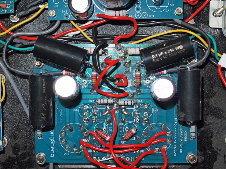

Today after work I made the changes to remove the 6N3p.
I lost almost two hours trying to figure out why i had sound only in one channel. :confused:
I was about to give up when I remembered to try another tube, at the end there was nothing wrong with the circuit I have sound again on both channels. :eek:
I do not quite understand why but it seems that the first tube was not good and only has one of the triodes working.
It's already too late to increase the volume but the sound seems ok, and the amplifier is much colder.
Still waiting for the box but I'm losing hope, it seems I'll have to make a new one.
As to the box, it would be much easier to work with wood, but maybe it's not a good idea to make the top panel out of wood because of the heat? any ideas?
Cheers

Hi!
I think you may have a bad tube socket, rather than a bad tube - have a close look at the socket at each connector - I had a tube not light up the filament because of that. It needed pushing back with a small screwdriver..
If you are thinking of a new box, a flat metal top on a wooden base is popular, with the existing front and back perhaps? I would think if you dismantled your box you could repair it well, with some wood and a hammer. Which bit of your case is damaged - is it just the top being bent?

Looking at your PCB I think you would be better off with point-to-point wiring. You will need to buy some (gold plated) valve bases and a metal punch - to punch the correct perfect round holes in the top plate. Then you screw in the valve bases with M3 nuts and bolts, together with tag strips to support components.
Point to point is then simply soldering from valve base pins to tag strip pins to follow the schematic we decide on :)
I'm going to replace the central driver panel on mine for a new one I think - for the new design which will be far easier with point to point.
Hi!
You were right the problem was in soket tube.
I will look better and see if I can repair the box, the problem is that not only is the top that is bent but also the sides.
I intend to do later point-to-point wiring, for now I'm just trying to make everything to sound right.

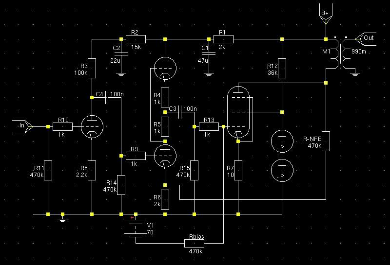

Hi All,
I'm just playing around with a new SRPP driven design for this - please see the attached picture.
The tube lineup is 6N3p, 6N6p, GU50.
The idea is to run the 6N3p at around 4mA, the 6N6p at 8mA and the GU50 at 55mA.
The feedback goes around two stages - no idea of levels, I hope to avoid a capacitor there too but it depends upon how it all works out. I'm aiming for about 9dB of feedback there, or at least between 6 and 9 to give a low impedance to the OPT.
G2 of the GU50 is driven from gas discharge at 5mA giving 150 + 108V
I did have a look at the 6N2p for the driver - but could not see how to get into the best bits of the curve with B+ at 430V.
The rail voltages go 430, 400, 350 approx down the line.

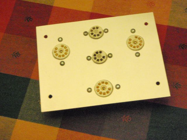

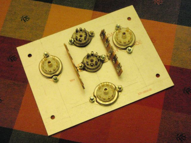

Started on my new driver board now.
The little plate in the middle has now been replicated in anodized alloy (from the cover of the HV section in a Tektronix 545b scope actually - are there no limits to this scope?) and I've used the neat Qmax punches to make some nice holes.
I may have to nibble the chassis a little to fit as the chassis hole is a lot narrower than the plate for some reason.
So the plan is for one input tube (dual triode) and two output tubes - allowing for playing with SRPP, Aikido, and of course strapped pentodes.
I think my last thought was a 6N2p input tube and two 6J51p driver pentodes. The little 7 pin sockets are for the OA2/OB2 gas VR tubes, giving just over 250V regulated to the GU50 screens to run them in pentode mode. Actually these came from the Tek' too..
So this board allows me now to develop the ideas in my post above and chop and change a bit as I have one tube per side on the driver.
More info as time allows, I have to bolt it in and wire up the filaments first with twisted pair, then see about operating points etc. I suspect I need more tagstrip too - maybe I'll hang a couple from the bolts that hold the plate in too.
