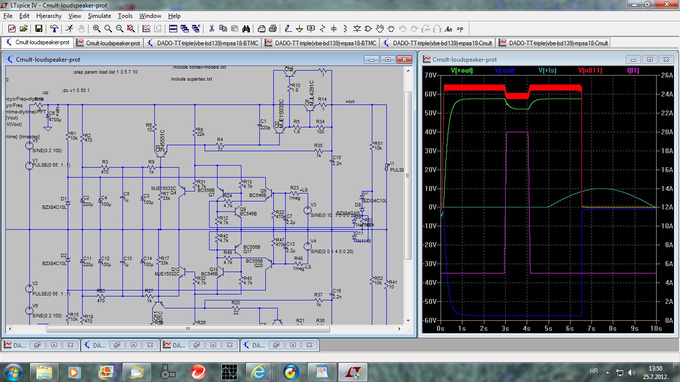

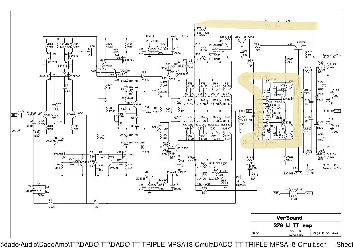

This is my OPS.
This is my OPS.

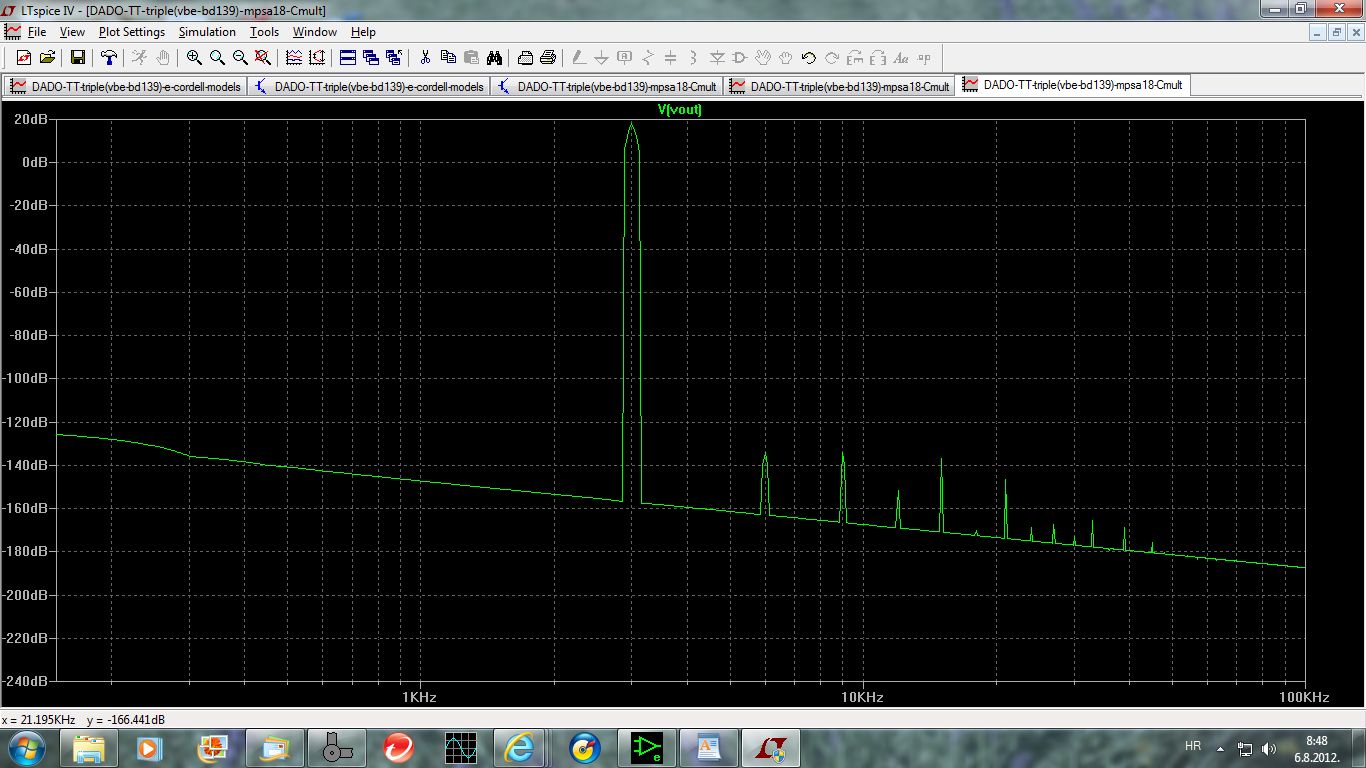

Could you post .asc file and then I can simulate and tell you more.
I will build this. Please give your opinion to optimize it. But I can not go to more complex than this, although it can give a little bit of performance rising. I am sorry for my bad English.

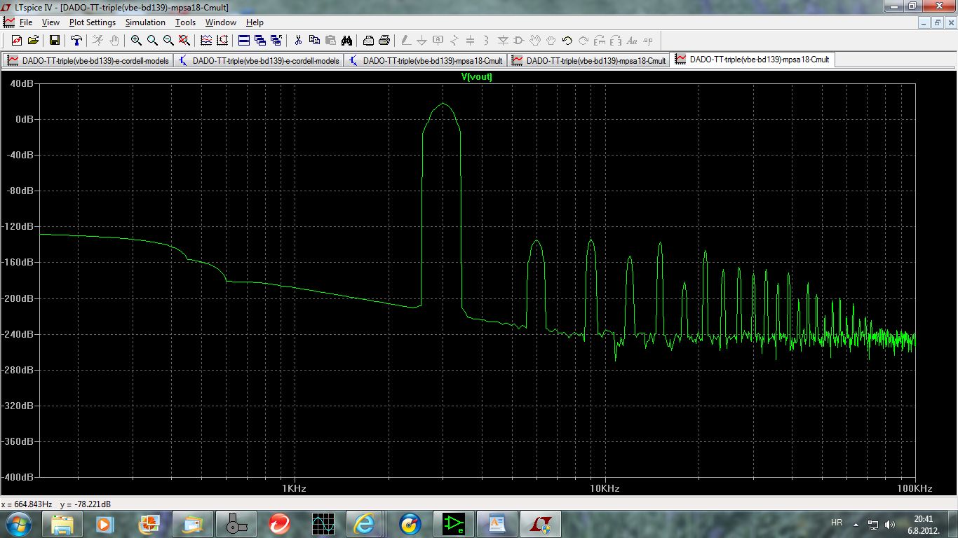

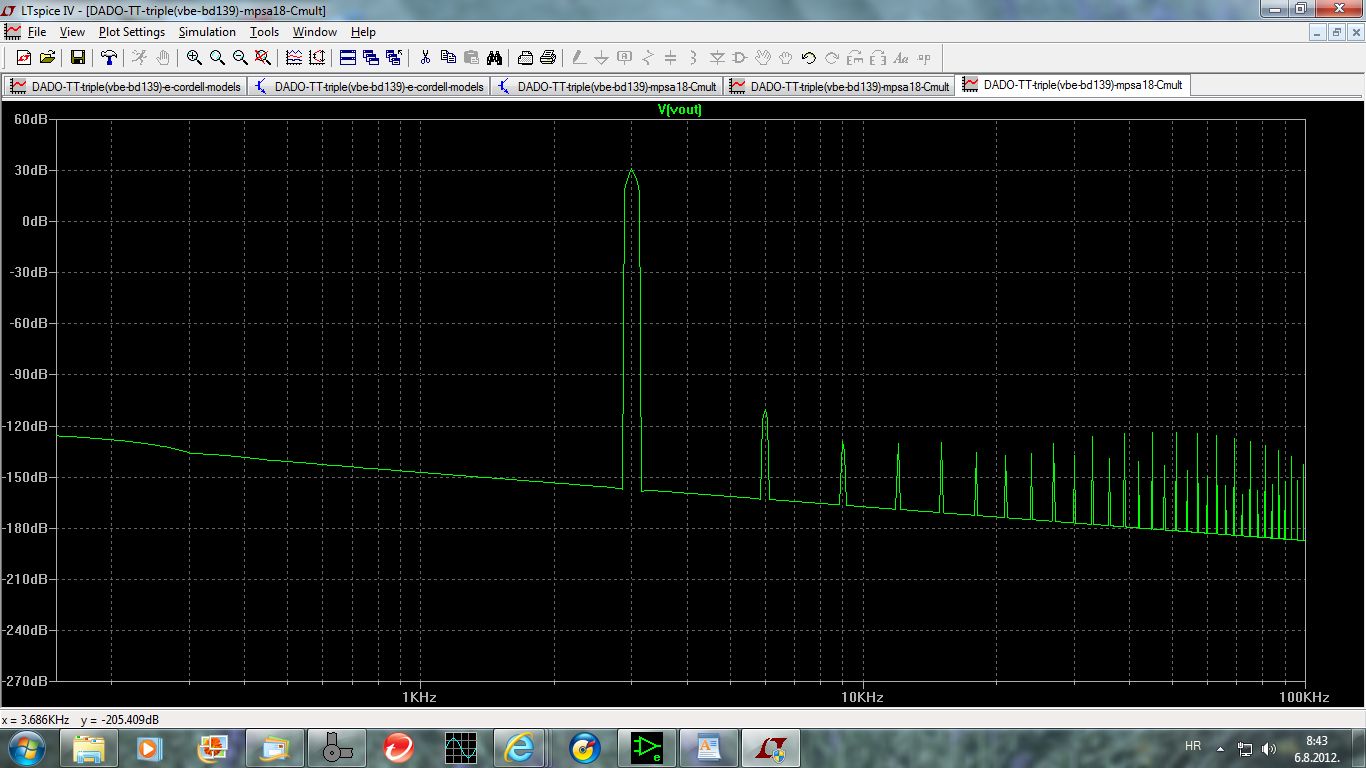

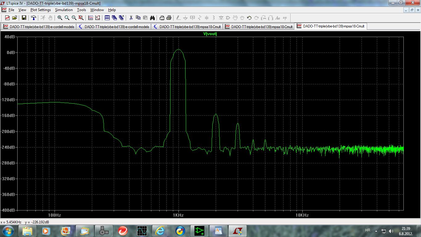

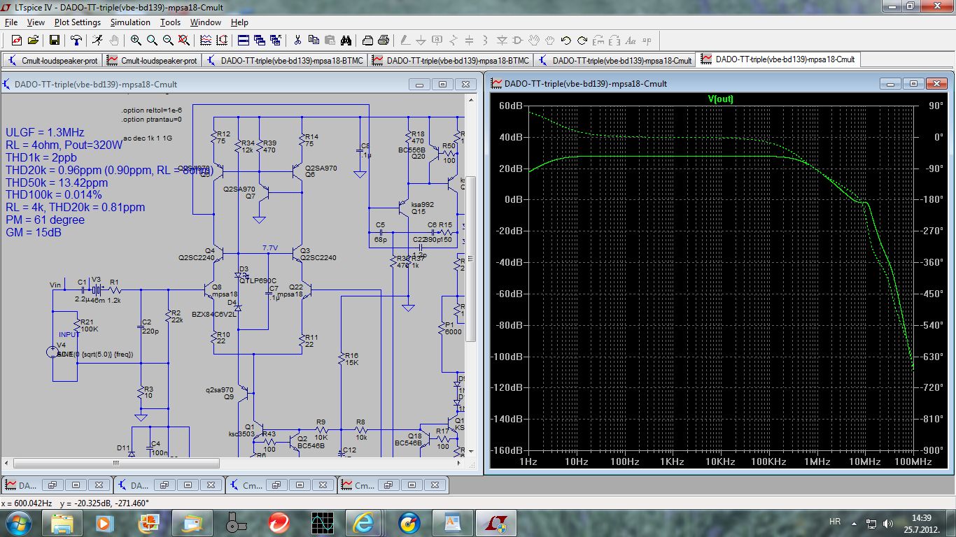

It looks quite stable with PM of 76 degree, and GM of 40 dB.
Just your Tian probe current source is up side down, I did that error before.
ps. If you want 200 W/8ohm you need to increase power supply voltage to +-70V.

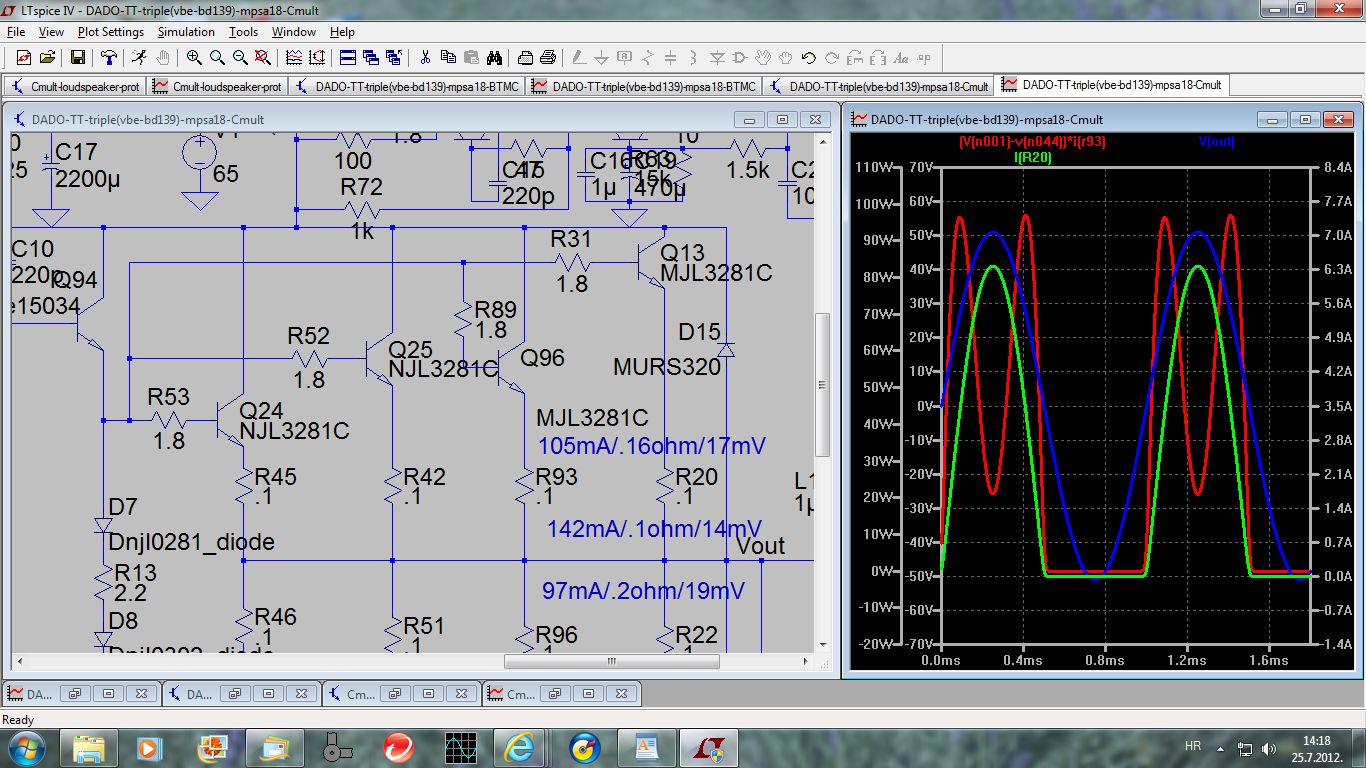

I suggest to run the drivers with more current not just 20 mA, I would run it at 50 mA min.

Yes, I will run it to minimize crossover distortion, or may be a little over bias.

I did not change your schematic, just reverse Ii current source(arrow up).

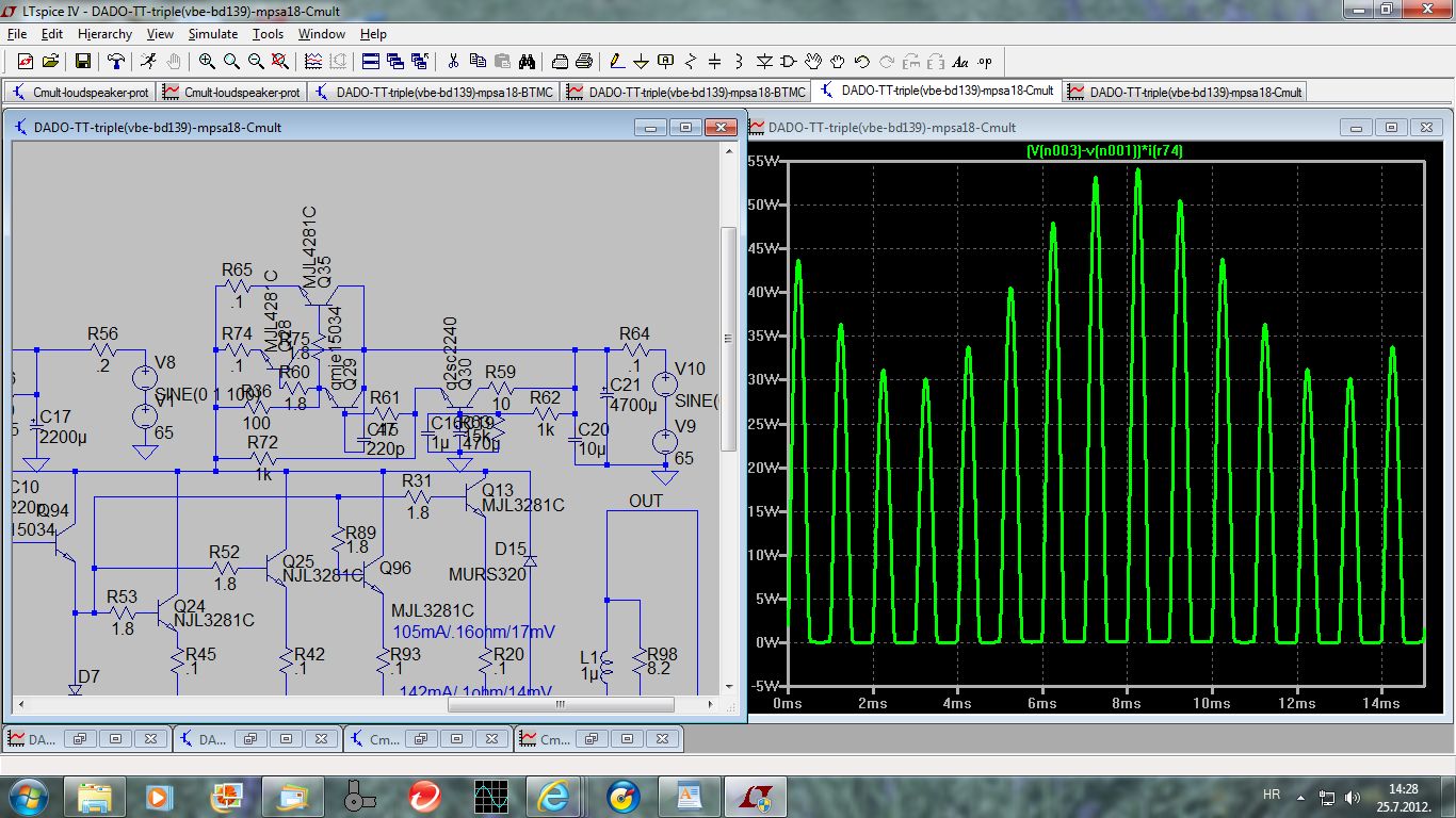

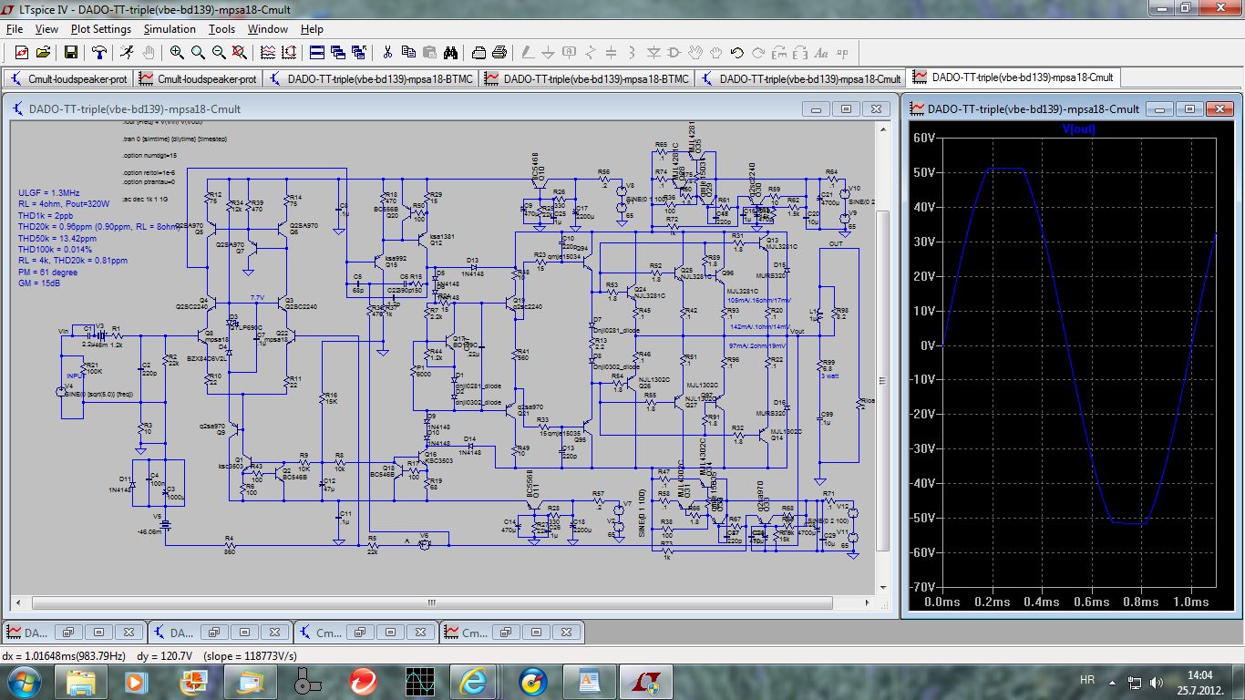

Why so high?.......... If you want 200 W/8ohm you need to increase power supply voltage to +-70V..............

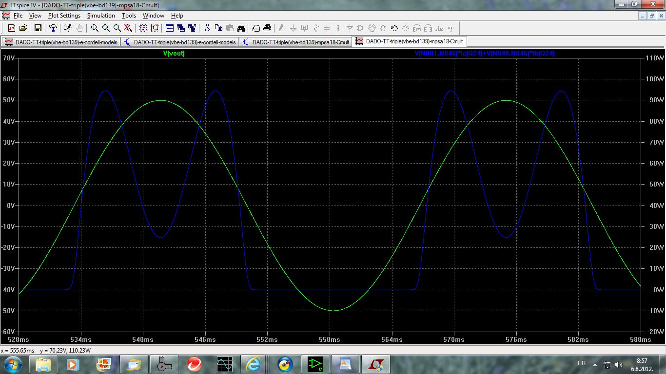

200W into 8ohms requires 56.6Vpk to the load.
I have reported just over 170W into 8r0 using unregulated (40,0,40Vac, mains transformer+rectifier+smoothing) PSU @ +-58.5Vdc.
I can't understand why you think you need another 11.5V on the supply to increase the output by just 4.3V (from 52.3Vpk to 56.6Vpk)
Why so high?
I you want to have relatively undistorted 200W/8 you need +-60V at that power, so with no load it should be, let say, +-65V as it will sag under full load.
Maybe +-70 V is a bit to much, depends of the transformer used(VA).
I used 40+40Vac, 1kVA for a two channel 310W+310W into 4r0+4r0.I you want to have relatively undistorted 200W/8 you need +-60V at that power, so with no load it should be, let say, +-65V as it will sag under full load.
I suspect a 45+45Vac would get to at least 220W into 8r0.
42Vac or 43Vac would probably achieve the 200W target.
