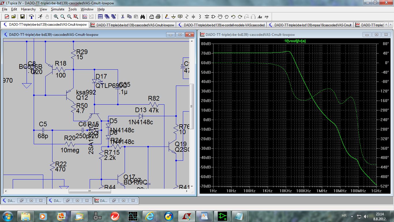

It is similar to Miller comp if TMC resistor was connected outside(directly to output) the probe. Here is screen shot with the resistor inside the probe.

I see that your amp has an open loop bandwidth of only +-200Hz.
I'm currently focussing a lot on this in my design. I'm breaking my head trying to reach an open loop bandwidth op +-10Khz without using resistive loading of the VAS.
Can someone tell me if this is really that necesarry, some people are telling high open loop BW is important. But, most Solid State amps have rather small open loop BW.

Open loop high bandwidth, low gain, already low distortion with little feedback gives the best result.

This is with the VAS local feedback, no resistive loading of the VAS needed, if you like that more. THD20k is the same as before, but higher at lower frequences.

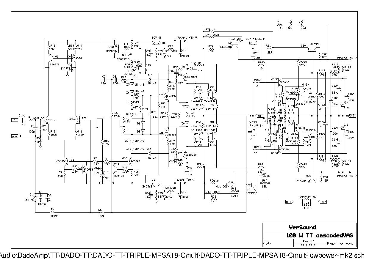

Here is the schematic of the low power TT amp with cascoded VAS.
It will be very nice if some of PCB experts(alex mm?) try to make the PCB for this amp. I think it is very simple amp with excellent data, and I am not so good in the PCB design. More powerful version could be a challenge to make the PCB.
Important is to have the drivers and Vbe multiplier on the same small separate heat sink(cca 5W dissipation for low power and 8W for high power).

Dado care to post the spice file ?? Id like to have a closer look with my models. The figures you obtain are very good and Im a little surprised that this design and using TMC can have such figures. The concept is not new, Pioneer used it in the late 80 and Sony has been using the concept for the past 15 years and still do in their latest models but just more refined, neither used TMC though. Figures obtained by Sony with bipolars usually around .003 20hz to 20 Khz.

Here it is.

To summarize what are fortes of those two amps. Nothing new just proven circuit put together to get stable good sounding amp. Quite easy obtainable components. Very high Negative Feedback is used.
High power version:
Transconductance stage - Cascoded LTP with floating bias and Current Mirror
The tail current was set to 11.5 mA to get good Slew Rate and very low noise LTP transistors used
Transimpedance stage - Enhanced Cascode with TMC
Voltage amp(OPS) - Triple EF for high input impedance
Low power version:
Transconductance stage - Simple LTP with Current Mirror
Power Supply is as important as the amp it self. Separate Capacitance multipliers for the Input Stage and Output Stage should be situated very close to the amp circuitry on the same Printed Circuit Board. In both amp Backer Clamp was used to prevent OPS saturation.
Any comments or suggestion is very welcome.
