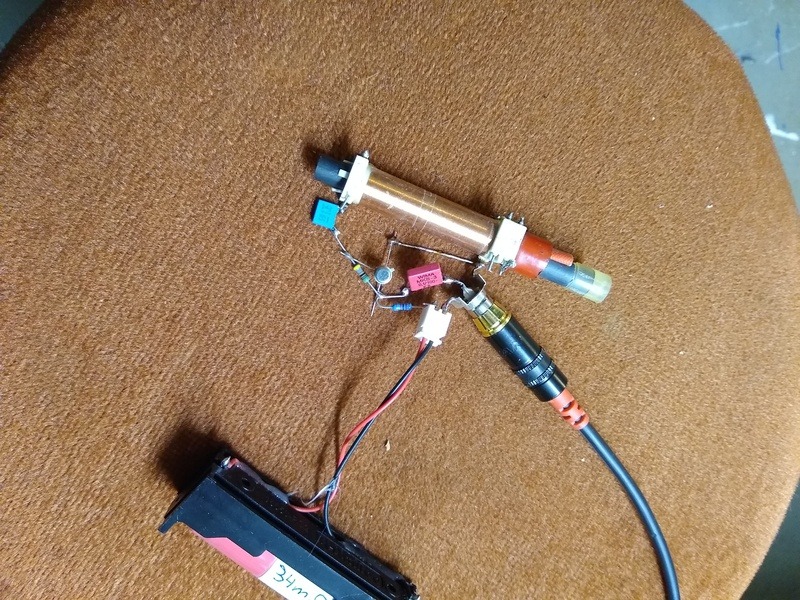

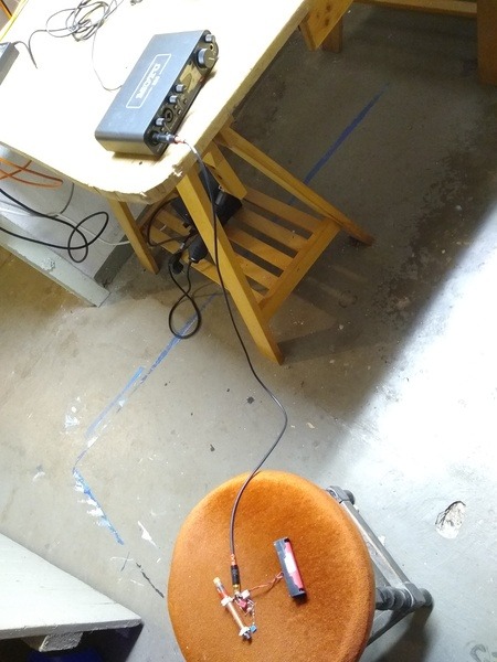

Yes its impressive, all the VLF signals are there.Ferrite coil, pre-amp feeding line-in of usb-soundcard Motu M4 with 192kHz sample rate. Connected to laptop with REW. And that's all. S/N is better than anything I tested before.
Have you tried simulating some capacitance (coming from the windings) in parallel with L5?
I am not familiar with SDR, but I begin to like the waterfall diagram. What is the sw you use, and is it available for Linux?
No, but as the linked article states, with the coil shorted inter-winding and other capacitances are without effect.Yes its impressive, all the VLF signals are there.
Yes of course looking into the Base of Q1 - not much voltage change there, so just the 26R for wire resistance so no Q no resonance just a flat response right up to 1MHz.No, but as the linked article states, with the coil shorted inter-winding and other capacitances are without effect.

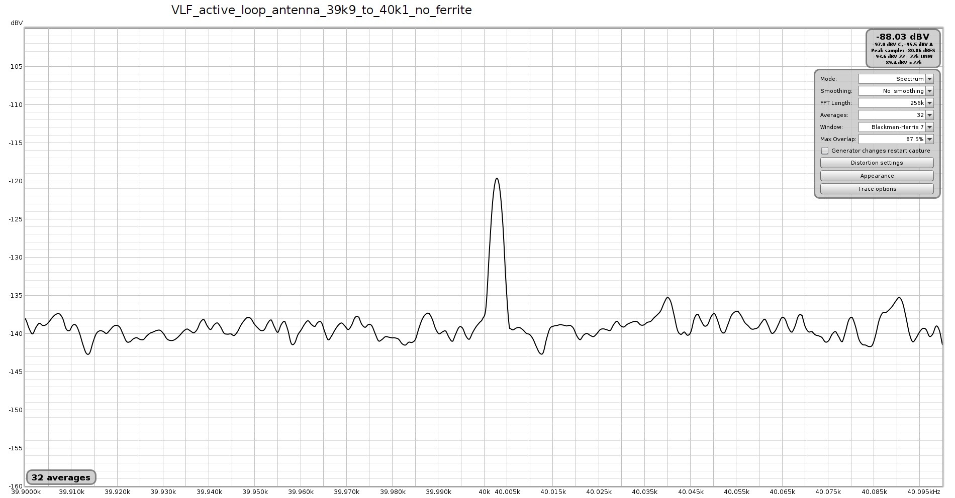

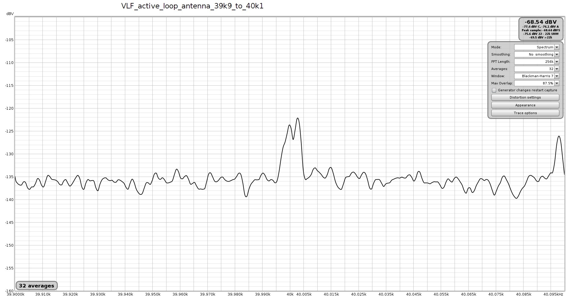

Looking for the Japanese time station, I did measurement in the range 39.9~40.1khz.
The first one with my standard test setup.
The second one with ferrite rod removed.
so what can we se?
There is a local carrier quite close to 40kHz, hiding the faint 40kHz-Signal.
Without the ferrite rod noise level drops about 5dB -
not very much, so there is room to improve noise of the circuit.
With some fantasy the 40kHz signal can be discovered...

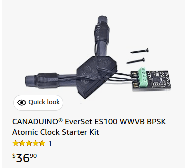

How you wind the tiny wire on that rod. Should I buy one of these Amazon clock antennas to play withMy secret sauce:
- EverSet ES100 Atomic Clock Receiver Starter Kit including the receiver module, a breakout board, 2 fine-tuned antennas and the 90 degrees antenna holder bracket.
- EverSet ES100 is the only receiver designed for the new WWVB BPSK modulated time clock signal from Fort Collins, Colorado.
- EverSet ES100 delivers an up to 100x better reception than the old-school AM receiver technology, known from wall clocks and wrist watches.
- For detailed information, datasheets and example code see UNIVERSAL-SOLDER.ca official website.

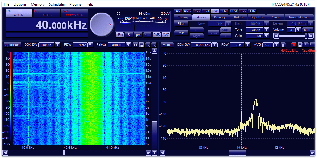

Most pics I posted are from my winradio's G31DDC. For specs, https://winradio.com/home/g31ddc.htmI am not familiar with SDR, but I begin to like the waterfall diagram. What is the sw you use, and is it available for Linux?
Still one of the best but for Linux it looks there isn't comparable software, only devpacks: https://www.linradio.com
SDRplay offers more, has better noise blanker and offers Linux soft even for ARM. https://www.sdrplay.com/sdrconnect/
However, no full spectrum display nor very low BW. OTOH more support in the form of plugins including latest DRM.
HDSR can operate with soundcard as input but alas no Linux support.

I think these two antennas are combined to allow operation without adjusting the direction of antennas by elimination of the the minimum.This kit has two antennas. Would they conflict?
