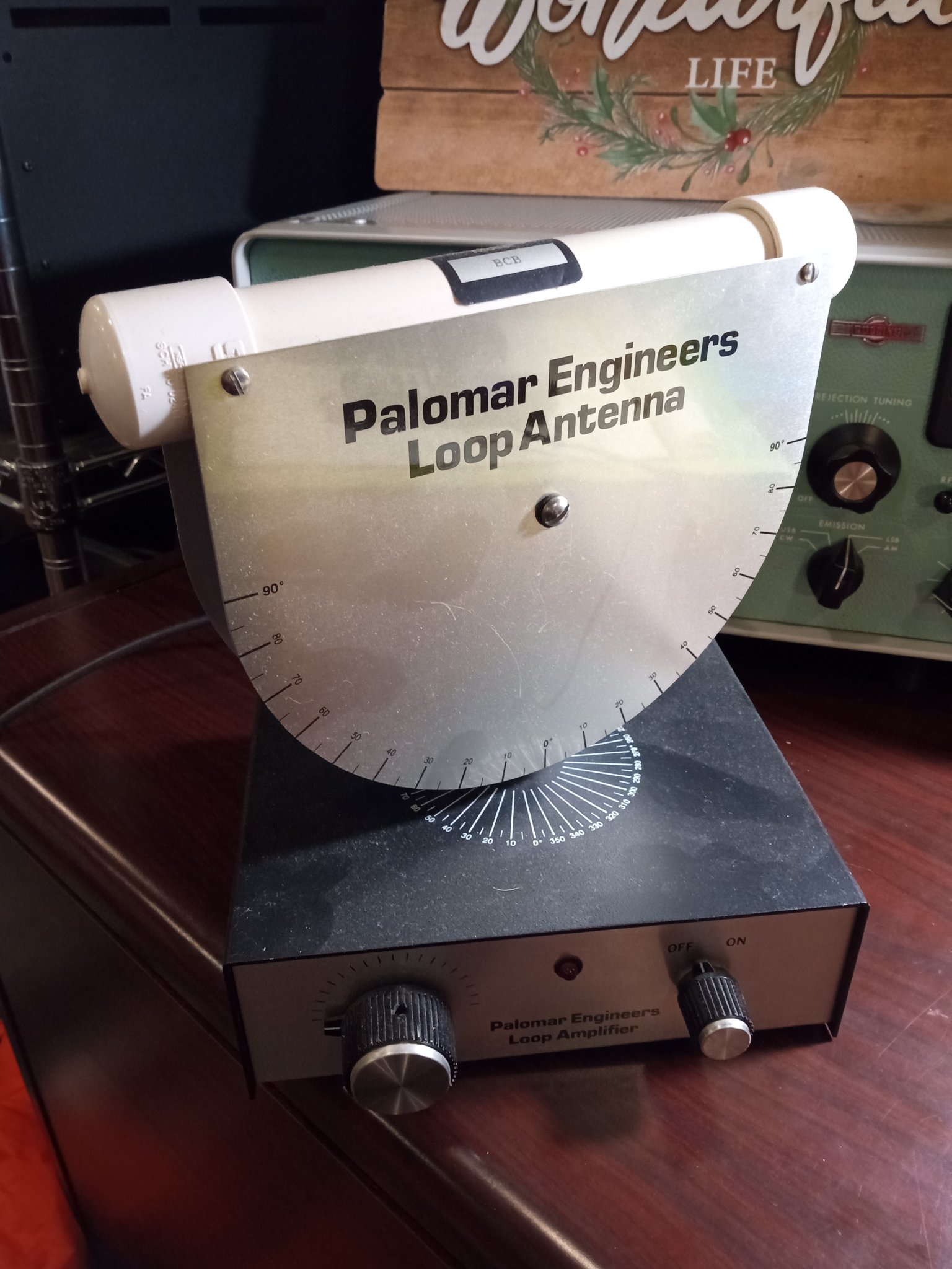

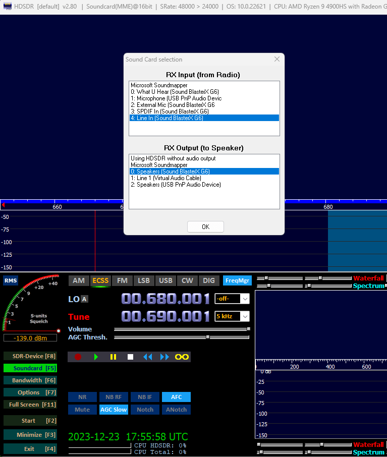

I already have this guy with a (USA) broadcast band loop. I wonder if it wouldn't be easier to just temporarily try to add some parallel capacitance to bring it down to VLF?
The Si5351 synthesizer in my VFO is specified to 8 KHz, my RF Amp and mixer are specified to DC, so unless there is a programming problem with the Si5351, in theory I already have a receiver in place to try to receive this, but not optimistic about coming up with an antenna.
Assuming I can get away with playing radio at the right time ...

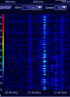

In the presence of pulse noise, filtering has the disadvantage of stretching a pulse, with the effect that it buries (part of) the wanted signal. So pulses have to be processed before filtering at the highest BW possible, and "close to clipping" opamps can do that rather well w/o additional hardware. Did you already connect the tuned ferrite coil to a mike input of the PC soundcard, and ran an FFT with sufficient resolution? When able to run an FFT, displaying it as waterfall, the SAQ morse can be decoded visually. It will look like this (15m ham band CW)
It's got a single stage bipolar amp in the loop base, but I don't know much about it. I bought this base and a couple of loops about twenty years ago, and can probably count on one hand the number of times I've used it.
It does work well on the MW band.

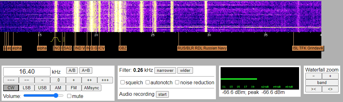

According to https://en.wikipedia.org/wiki/List_of_VLF-transmitters there are transmitters close to 17.2k and one of them is the Norwegian navy at 16.4k. with equal ERP as SAQ. It's possible the info is outdated but if so, the navy will produce the strongest signal. There are many others but here in Panama only 2 stations are adjacent to SAQ, the one to the left, JXN at 16.4k, to the right, INS at 18.2k. When wondering what the "straight lines" around NWC at 19.8k are, they are 60 Hz harmonics.

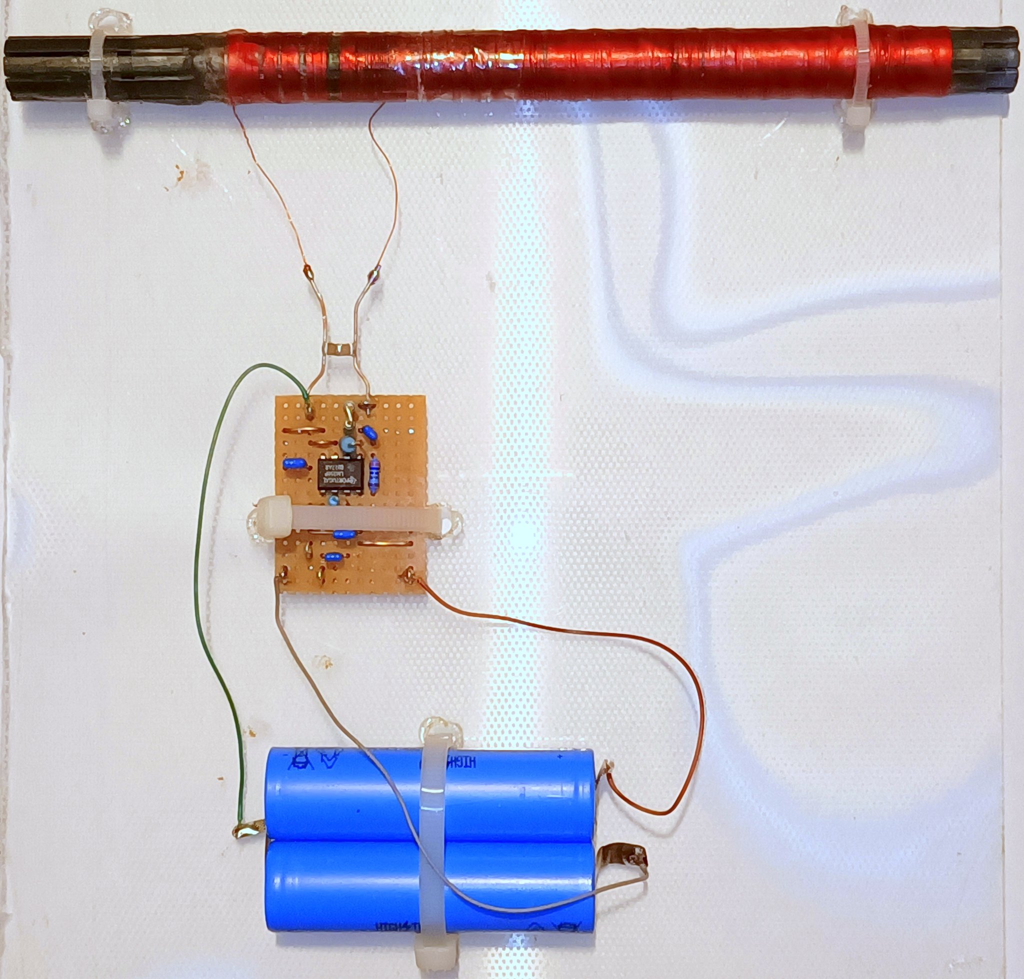

So I have built and partly tested a receiver as shown by the photo and the circuit diagram below. As you can see it is very simple, very basic. It peaks strongly at 17.2 kHz and picks up my test coil some distance away.
Unfortunately I don't think it has enough gain as is - ideally needing another tuned circuit and more gain, but I will connect a long wire and an earth to it tomorrow morning and see what happens. I did look for a better OpAmp but could only find some LM358's
