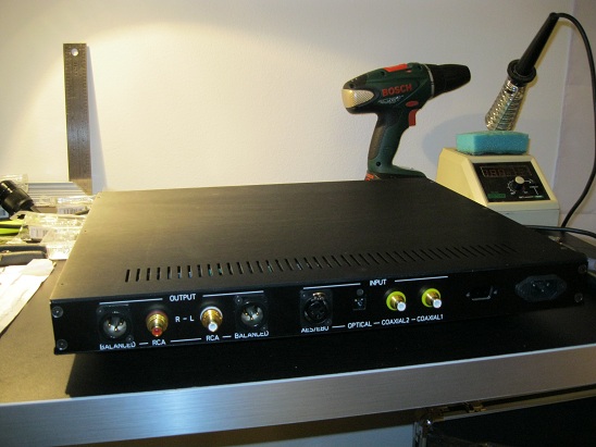

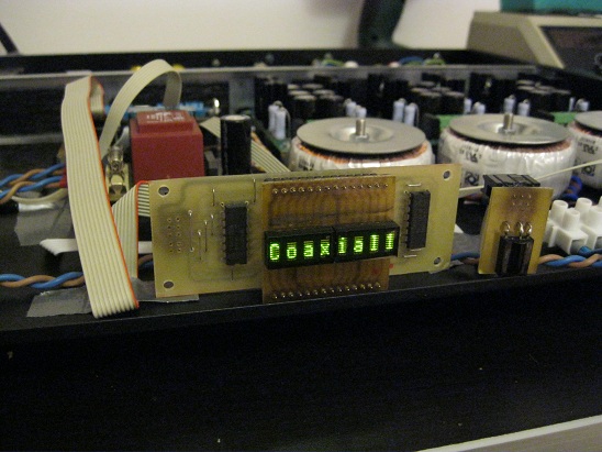

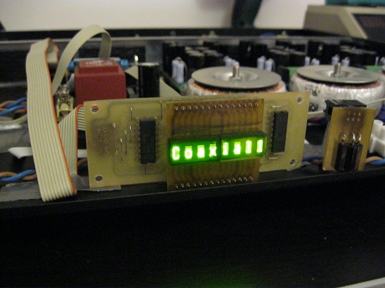

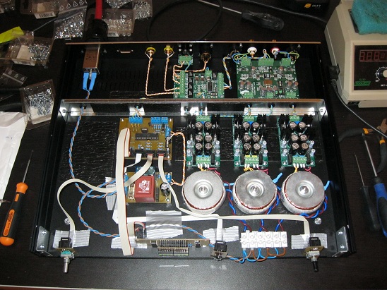

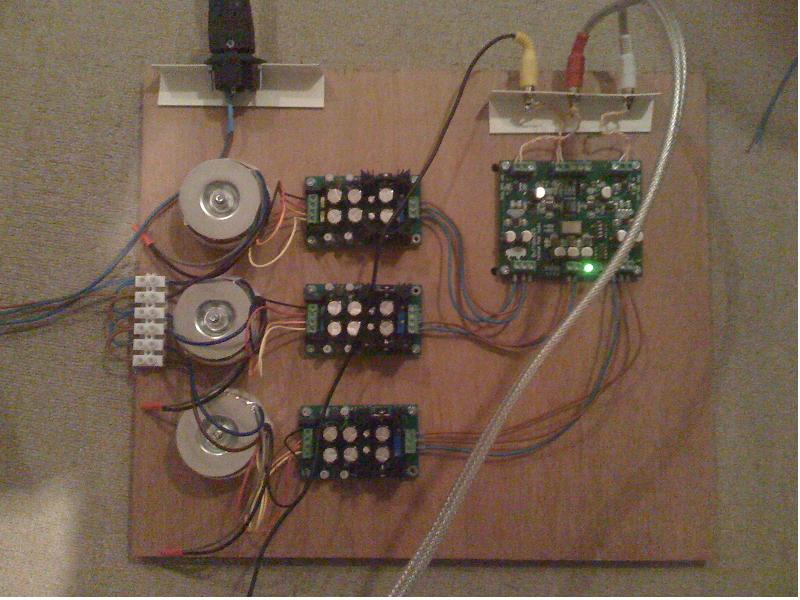

After using the buffalo32s on a very audiophile piece of plywood for a year and a half, I finally found some time to build a nice casing. See below for pictures. No front yet but that will be fixed shortly.
My brother designed a nice display. rotary encoder and IR-control for the input selection. When you turn the encoder, the display will light up to 100%. After 5 seconds the light intensity will lower to about 30%.
I still love this DAC, especially with my Squeezebox Touch. Perfect combination.

I have been using my Buffalo 32S for quite a while now. Still working great but I came up one digital (optical) input short. So I ordered an extra toslink module and a volumite. Today I have changed the (unused) AES/EBU input for a second toslink input. Works perfect after shorting R7 on the 4:1 MUX (as discribed in the manual).
Since I do not have any analog sources anymore, I wanted to try the volume control of the ESS9018. So I also added a Volumite. This is where I am having a problem. Seems to work fine but the DAC loses lock every 5-10 seconds for a very short while. Disconnected the Volumite and replaced the original firmware on the buffalo32s pcb and everything works fine again (but of course no volume control). Anybody any ideas what might be causing this strange behaviour?

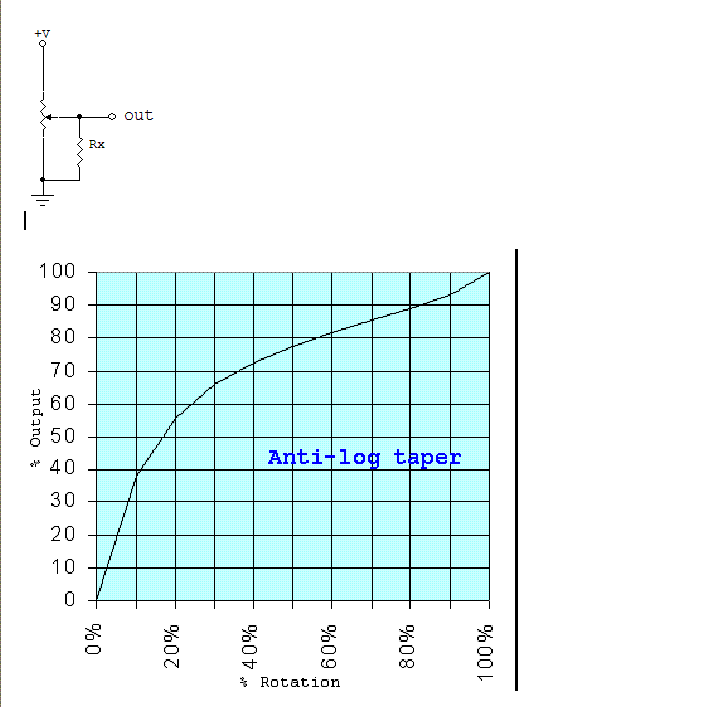

I received the firmware two days ago and installed the chip this evening. Lock-issues are gone. Perfect. But now there is one other thing with this firmware. When I turn the volumite to minimum I should hear nothing. But this is not the case. I still hear the music very quitely. Is there anyway to fix this?
Scanspeakman
Hi Russ,
Here's a solution to maintain full range. The circuit pictured below converts a linear taper so that it functions like anti-log pot. The value of Rx should be about 20% of the full pot value. I've tried it, it works great.
