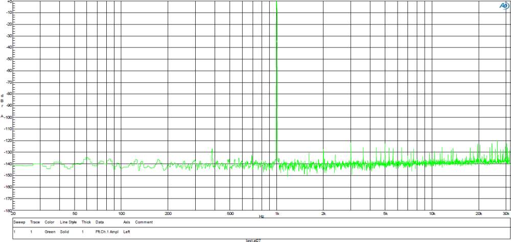

Buffalo32S Test Results
So, here it is folks. :)
I have for you the first measurements for Buffalo32S. :)
Naked board no case or any shielding.
I am very, very, pleased.
I could have achieved a bit better DNR if I used some more aggressive filtering, but the trade off would have been higher output impedance. All in all I am extremely happy. Especially since you can drive headphones etc directly from this DAC.
For instance the ESS demo board measures slightly better, but has a very high output impedance. That's the trade off. Now if you drive cables with a high impedance and have to add an additional stage to drive your headphones you will probably end up with for worse spec then if you went directly out of the Buffalo32S. :)
Anyway I am very very pleased. :hphones: 127db DNR is perfectly fine by me. :)
I enjoy listening to it much better than measuring it. :yes:

Ap Fft
Here is the FFT at 1khz 0db. :)
