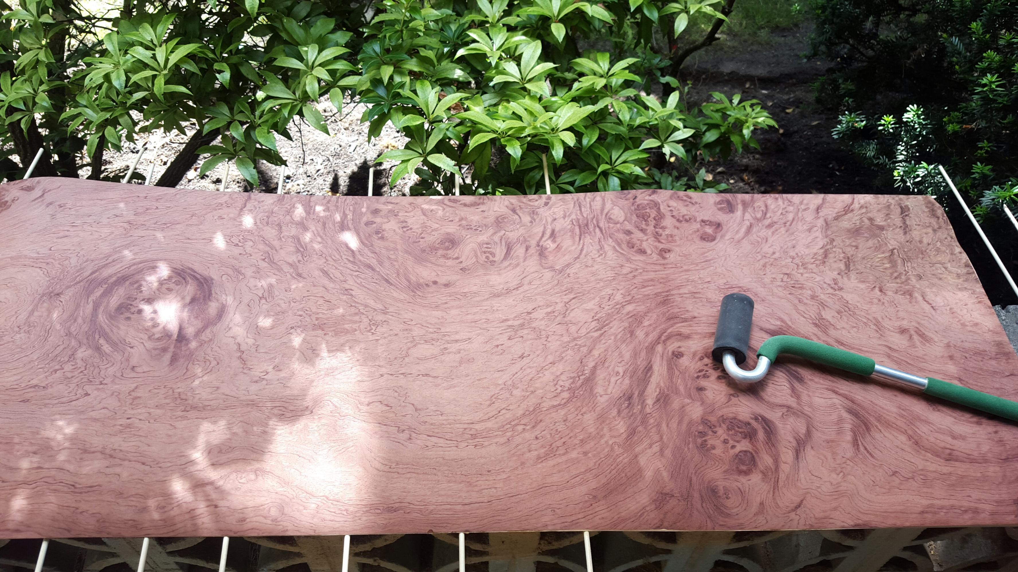

But I'm seeking advice on whether to stick with figured veneer for the top and sides of these 17.5"× 47.5" baffles, or contrast them with a straight grained hardwood, like on sale maple or red oak.
Keeping the drivers simple looking, just an Alpair 12P per side, possibly with a Fountek silver ribbon atop them, if my aging ears need them.

Gorgeous piece of veneer, but I tend to try for as much symmetry in figuring / patterns on larger cabinets - something that can be hard to achieve with the highly figured or burls, but much easier with quarter/rift cut, book-matched flat sliced, or even birdseye patterns. Some of the newer engineered (reconstituted) veneers are quite interesting for that - not inexpensive however .

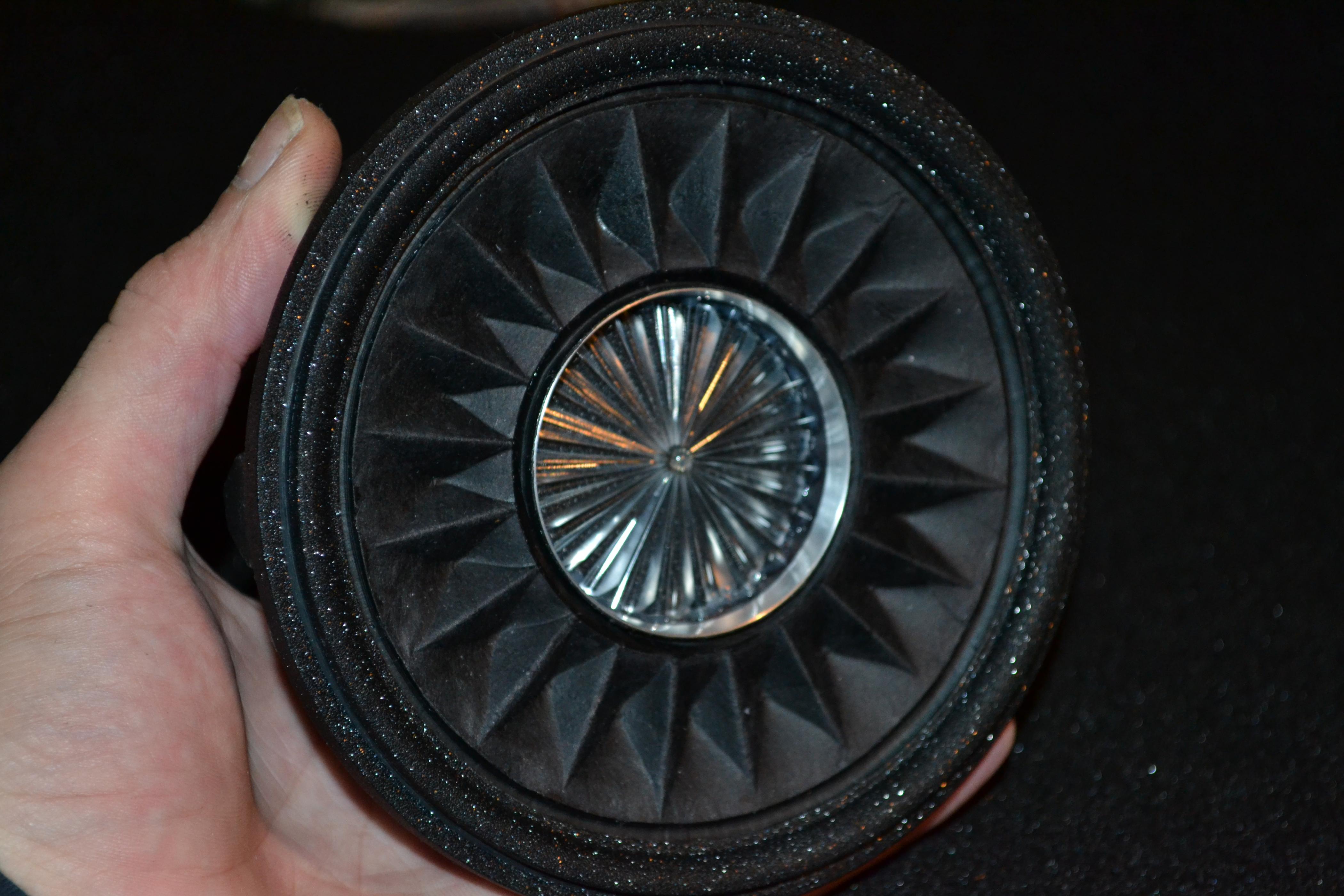

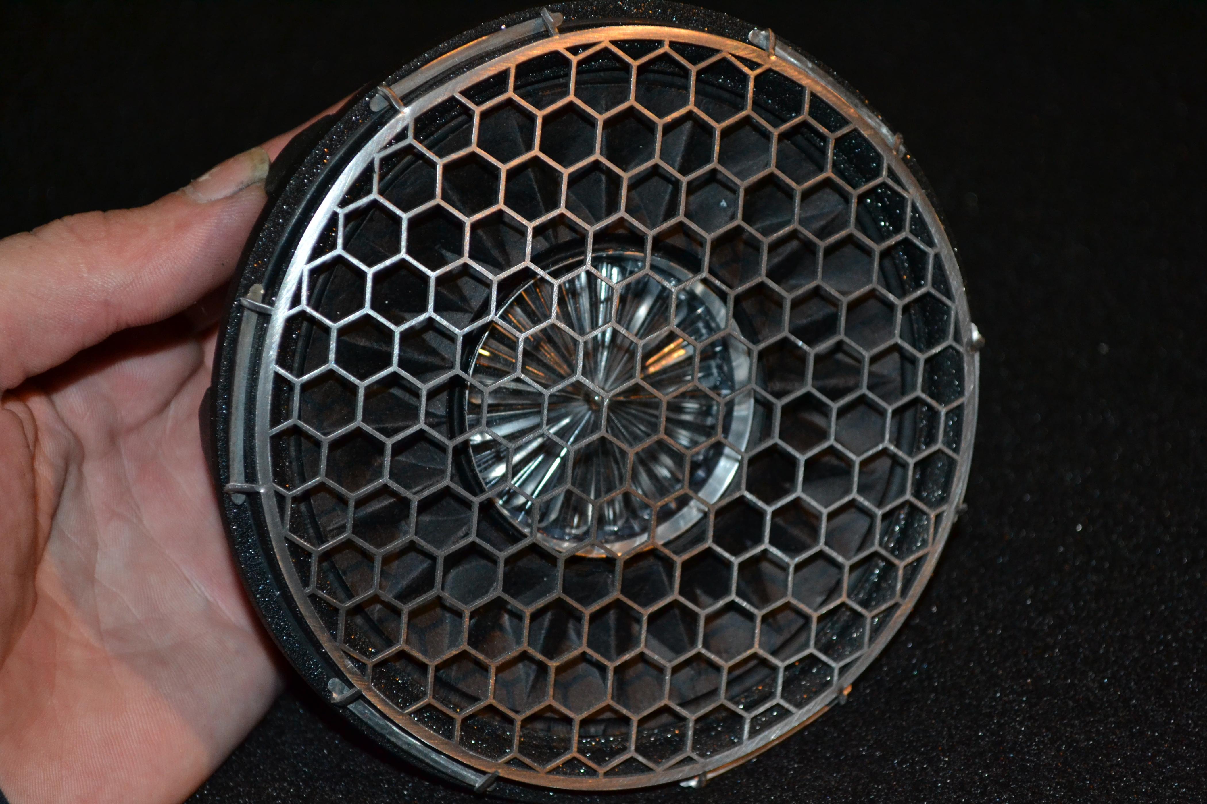

I have been thinking of trying to coaxial too. the car-audio coaxial often work as infinite baffles so that could be used in open baffle, the trouble is that most car audio drivers are rubbish, but there are exceptions.
This coaxial attracts me, PC 165F - Focal I think i'll give it a chance
sorry for my bad English

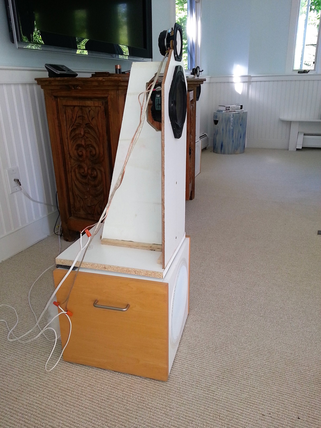

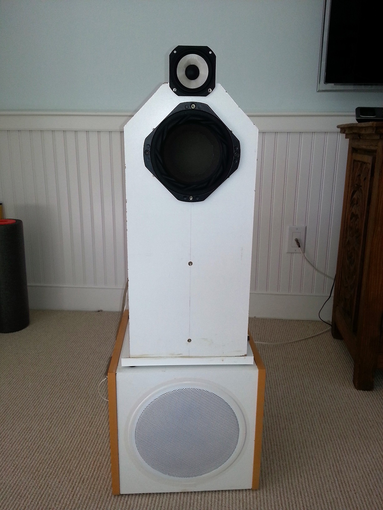

Less than ultimate open baffle
There are some beautifully executed projects in this thread.
This is not one of those!
Recently we were getting rid of a wooden file cabinet. Once it was disassembled I thought this is everything I need to make my next prototype.
The design concepts are based on the work of John K. The bass is a damped U-frame with 10 Inch peerless XLS woofer. The faux wood sides were the file drawer fronts, leaving the handles on makes them easy to move out from the wall.
The upper mid and tweeter are an 18sound 6nd430 and TG9 fullrange, 1KHz 4th order acoustic crossover via minisharc DSP
Sounds better than it looks.🙂
