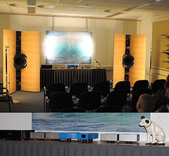

What do you guys think Those 15" could be deltalites and coax 18sound 15ncx1000.
Thing is Second order cardioid. Two dipoles back to back and the front one electronically delayed by the amount of their distance.
open wooden frame just to hang those speaker could be damping material inside and sideways.
Eats 4 active channels
Need opinions
I think it would be great! Don't expect high output, but done right you probably won't find a speaker that sounds more detailed in de lower mids and lows. You could substitute the coax for a mid and waveguide for smoother response and directivity.
And please delay the drivers on the back instead of those on the front. Also, the upper frequency limit is a bit below for which the distance between front and back driver corresponds to a half wavelength. Something to think about.
yes something to think about

I think impulse and step responses are not the right measurements to look at in deciding which driver to delay. The second order gradient is bandwidth limited at higher frequencies, but the impuls response has a very wide spectrum.
What you want is wide-band cancellation to the back. The only way to achieve that is by putting the rear driver in anti-phase with the front driver and delaying it so that from the rear perspective the drivers are time-aligned. The upper frequency limit is determined by the distance between the drivers. When the distance is a half wavelength, you get cancellation at the main frontal axis.
If you want to do meaningful impulse and step response measurements, first set a low-pass filter so that you don't get the frontal null. Then you'll get an entirely different result.
i dont know man, listened rear polarity - up to 50cm delay and it didnt sound as good as front delay impulse matched

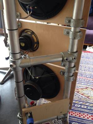

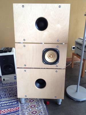

Hi Orlando,
did you make these?
how wide is the gap?
does it extend the lows?
how far?
they look like: I want to build these too!
Hi Tyimo,
It is certainly not the same area. This is a quite smart and (IMHO) good looking way to enlarge the distance between the back and the front of the unit. Result is a better bass performance.
