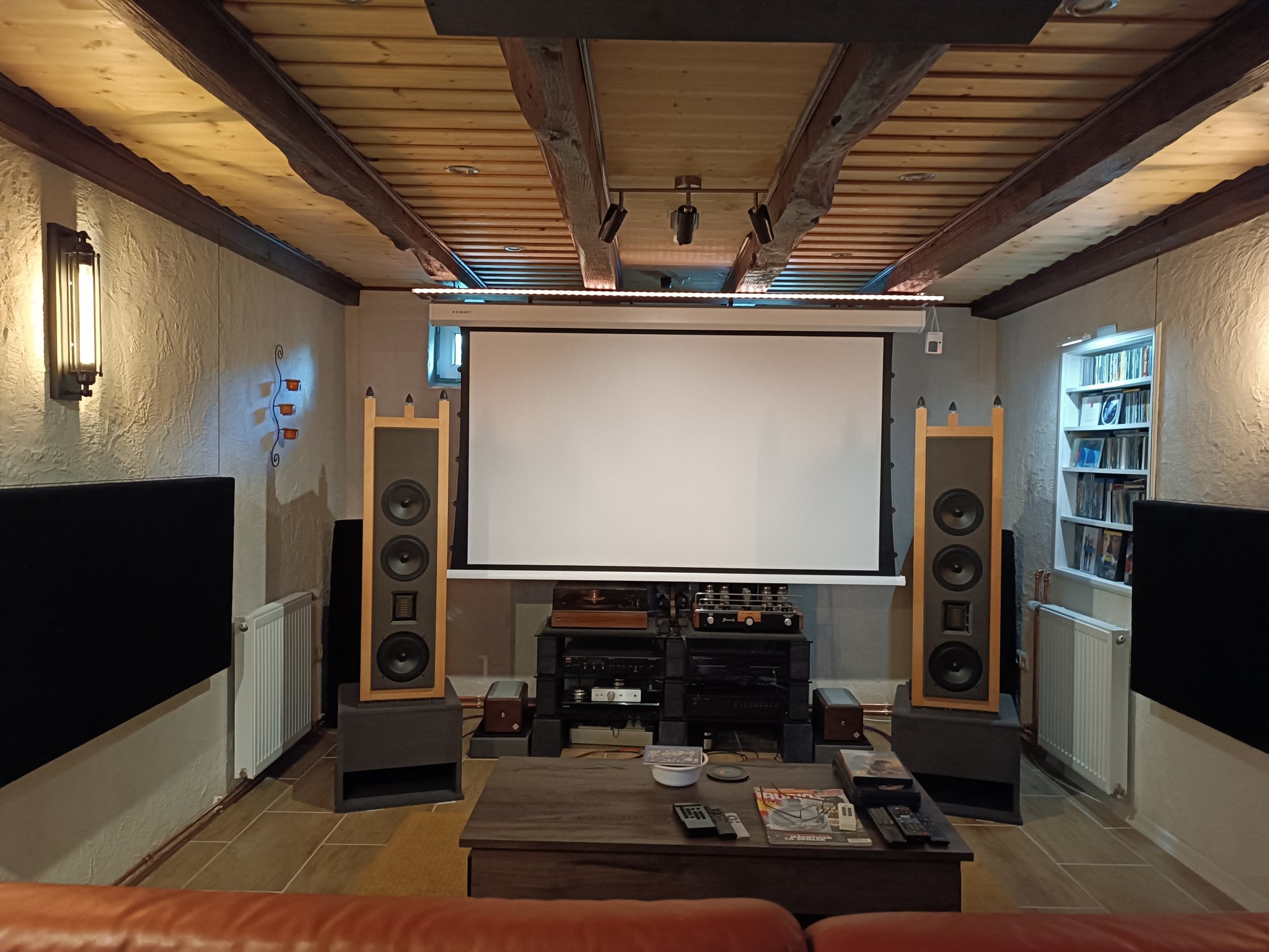

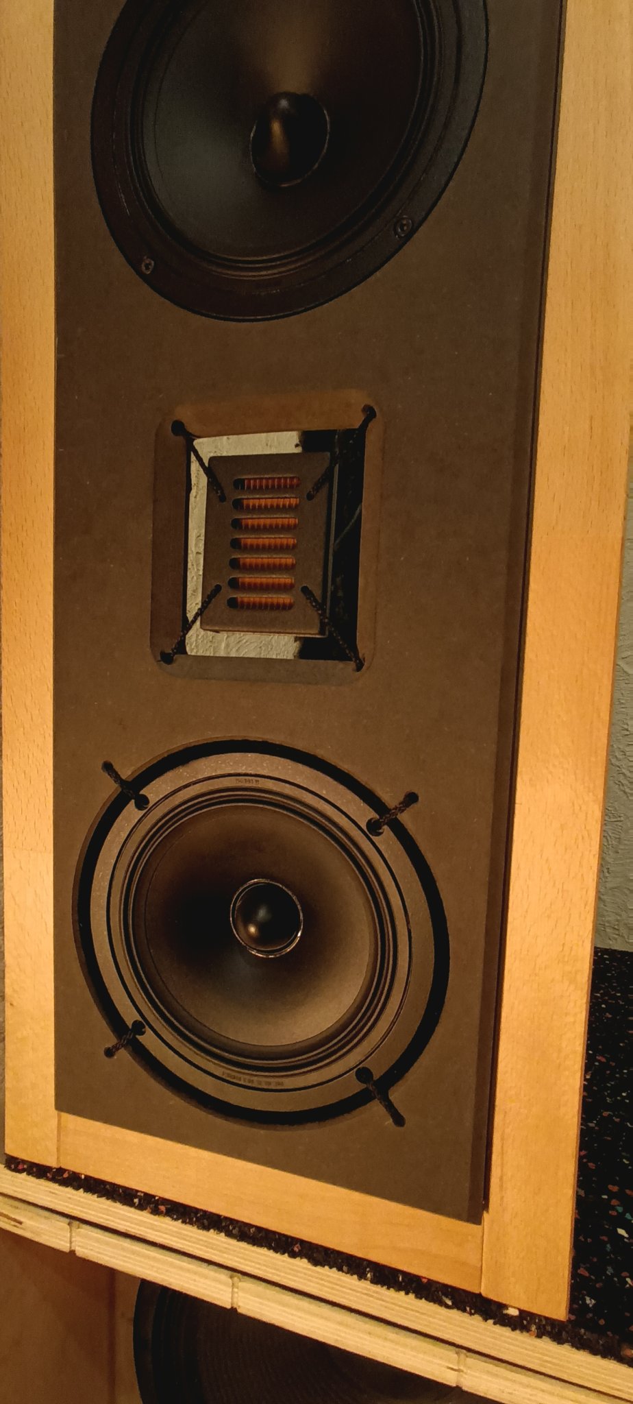

Series 3-way is live!

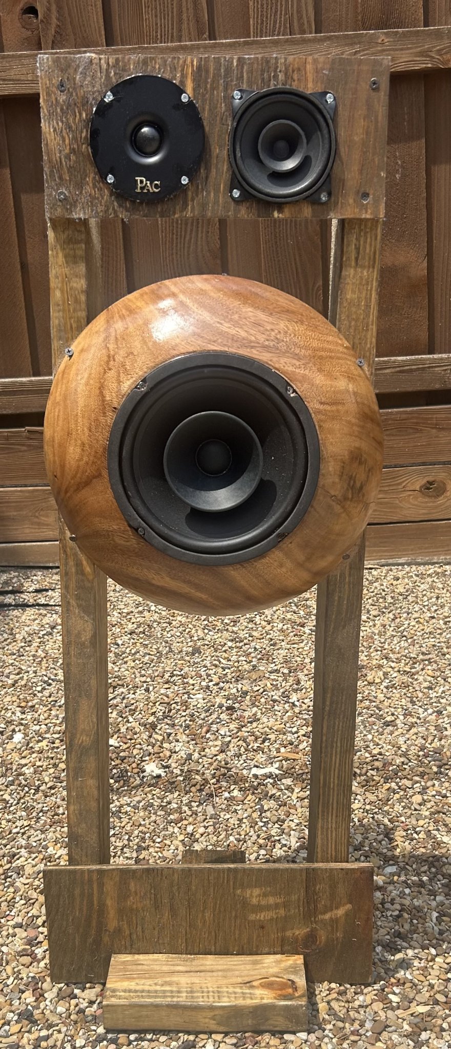

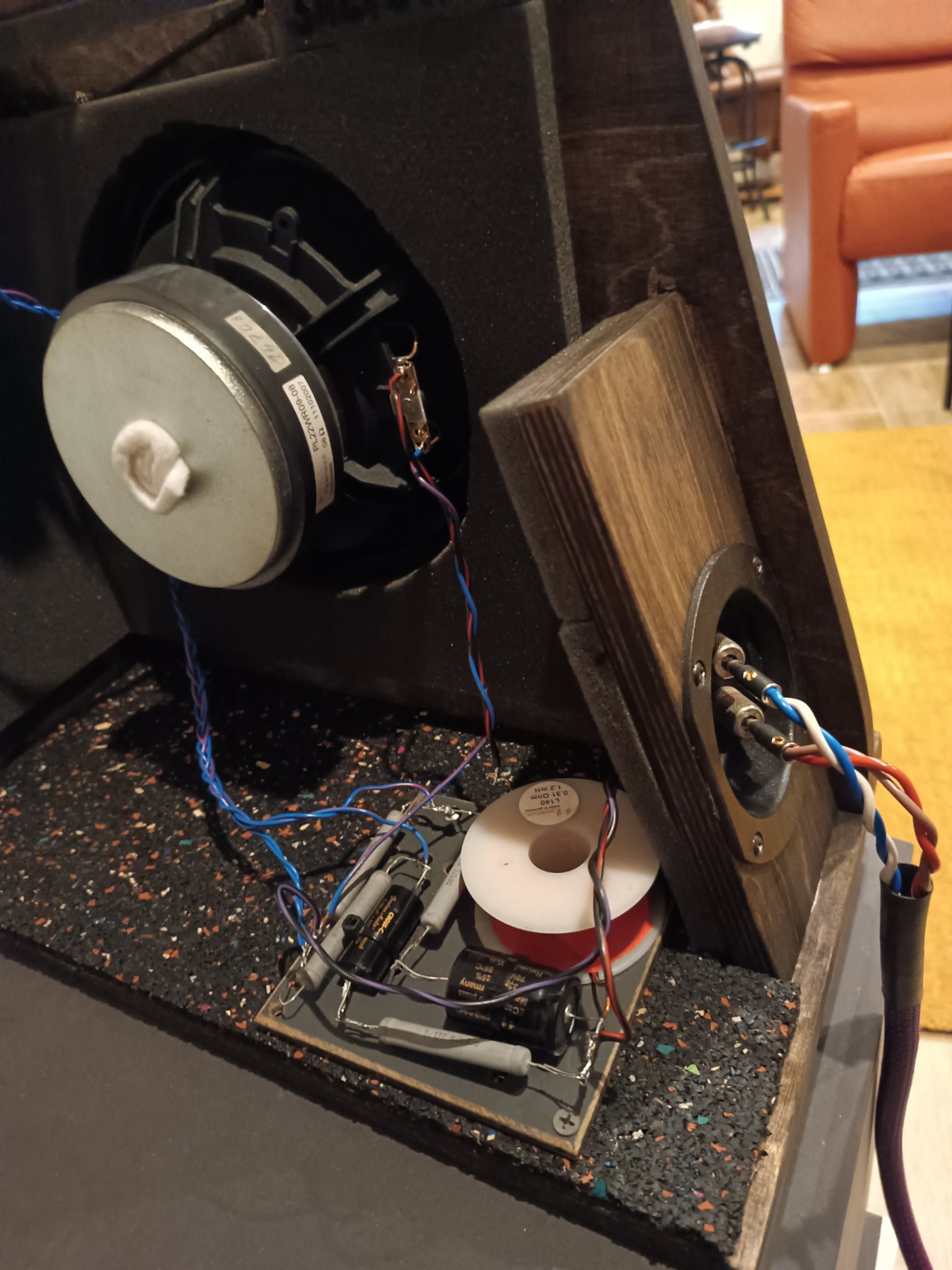

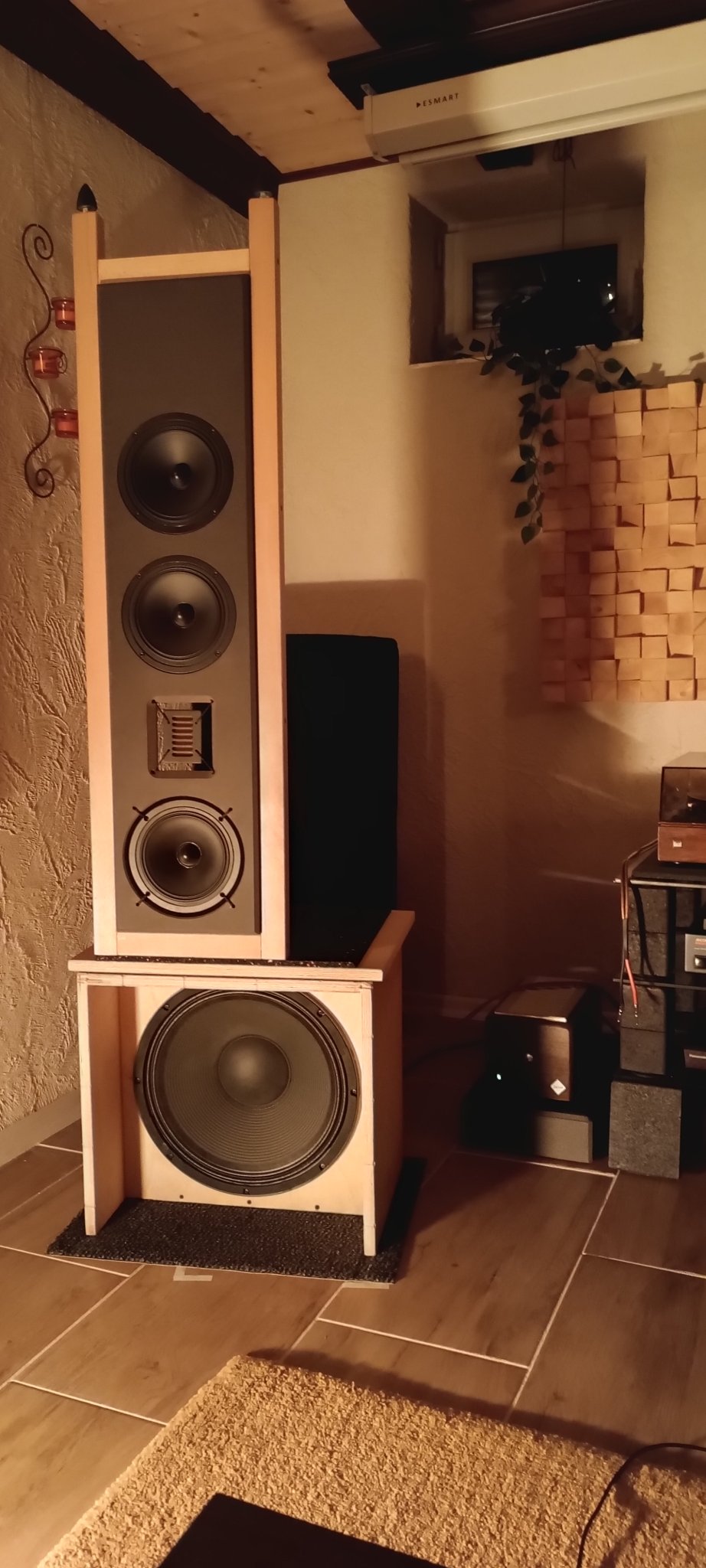

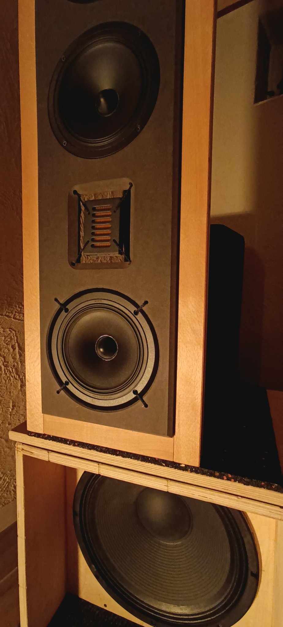

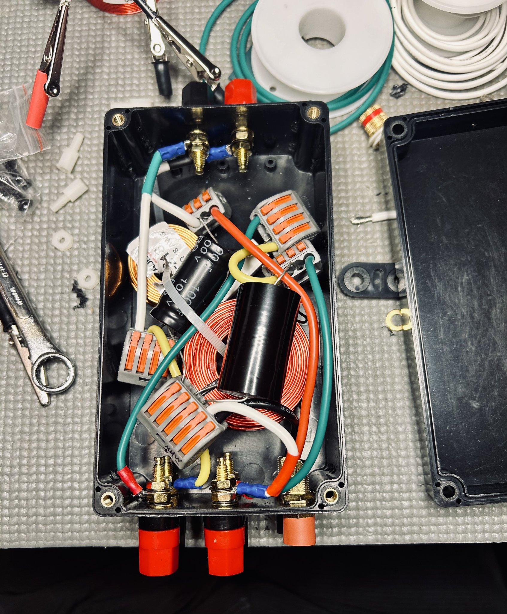

I put my test crossovers in enclosures and took measurements. Tweaked with DSP PEQ.

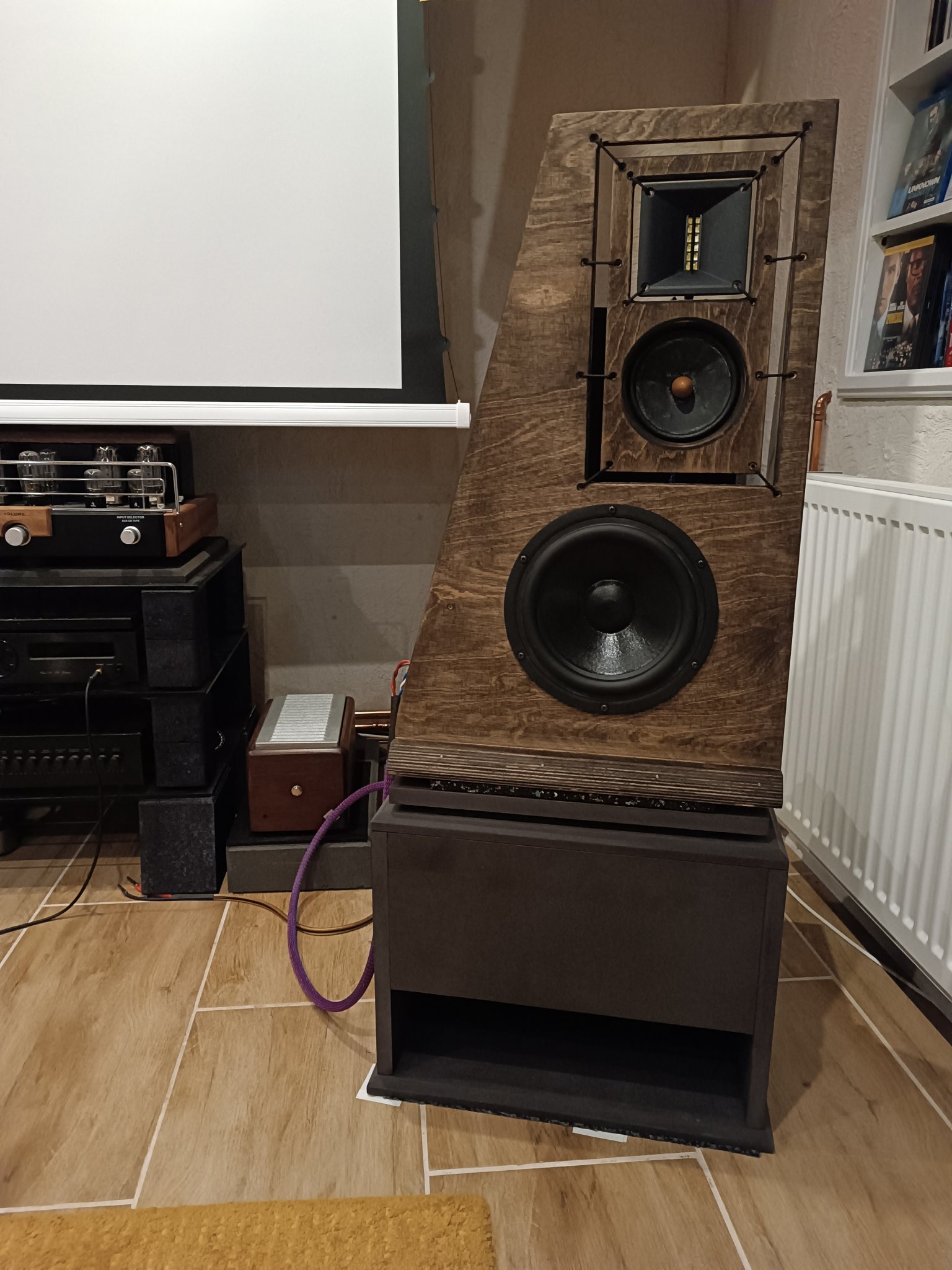

Previous post with picture of the baffle and drivers.
Other post showing how I was using 3-way active DSP until today.

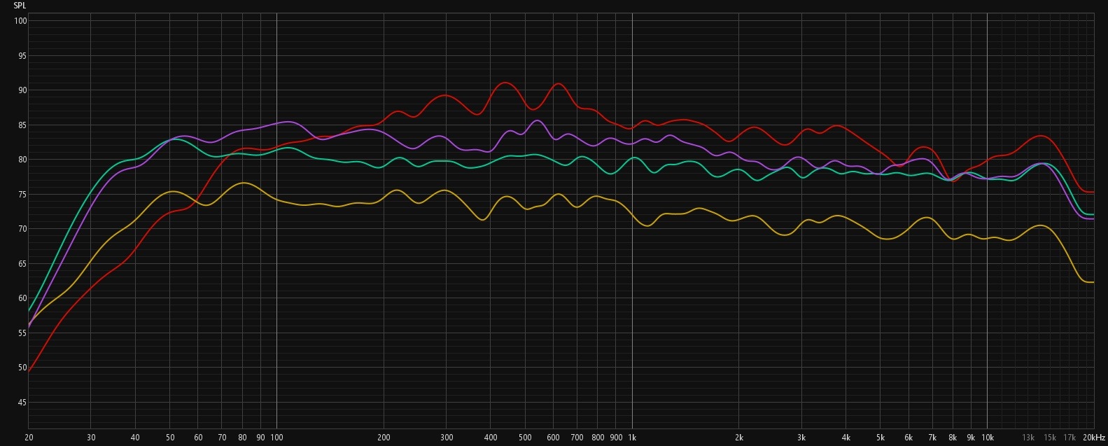

Measurement image shows:
), but the general approximation is valuable for me.

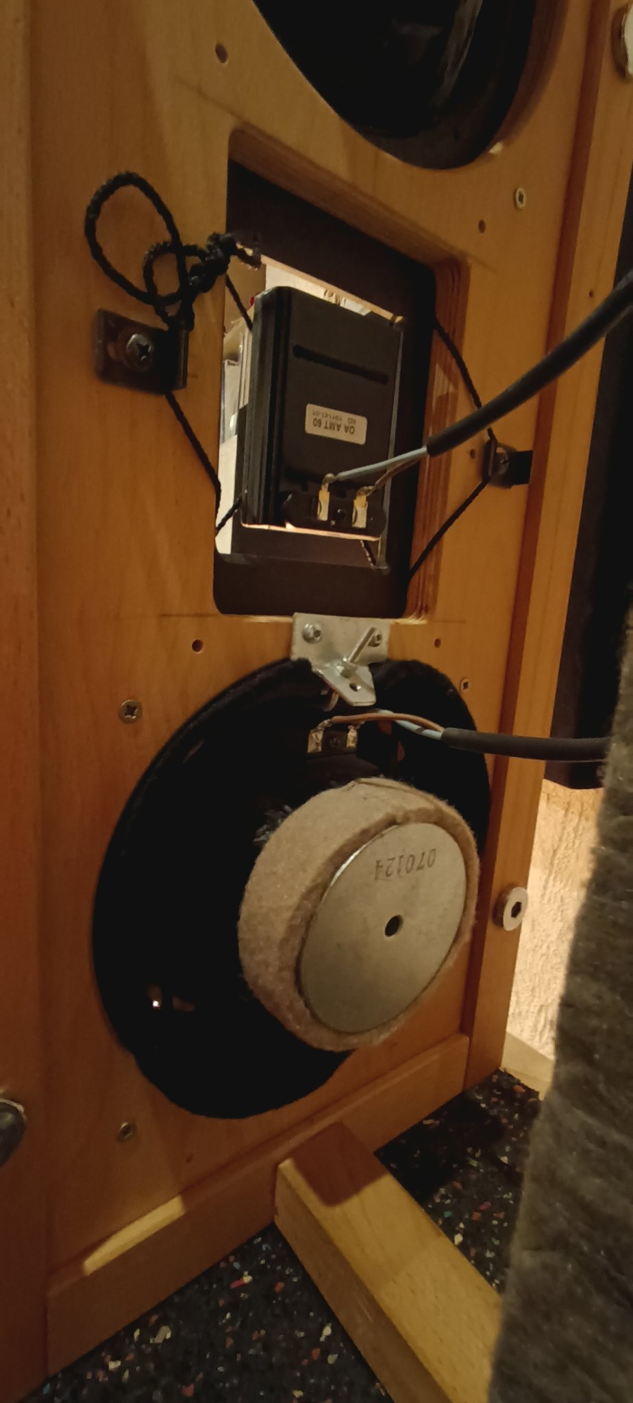

The active 3-way sounded really good and looks better +/- overall, but I’m happy to be able to easily switch out power amps again. AND bring my Iron Pre back from its slumber.![spin :spin: :spin:](https://files.diyaudio.com/forums/images/smilies/spin.gif)
Edit: I rotated the little coils in the boxes to be perpendicular to the big coils after an astute comment from @xrk971.
- Red - Before EQ w/ series crossover
- Gold - After EQ w/ series crossover
- Cyan - 3-way active DSP crossover
- Violet - EQ w/ former parallel crossover
- Measurements taken with MiniDSP umik and REW from the listening position (~2m), on-axis with the mid, psychoacoustic smoothing
![clown :clown: :clown:](https://files.diyaudio.com/forums/images/smilies/clown.gif)
