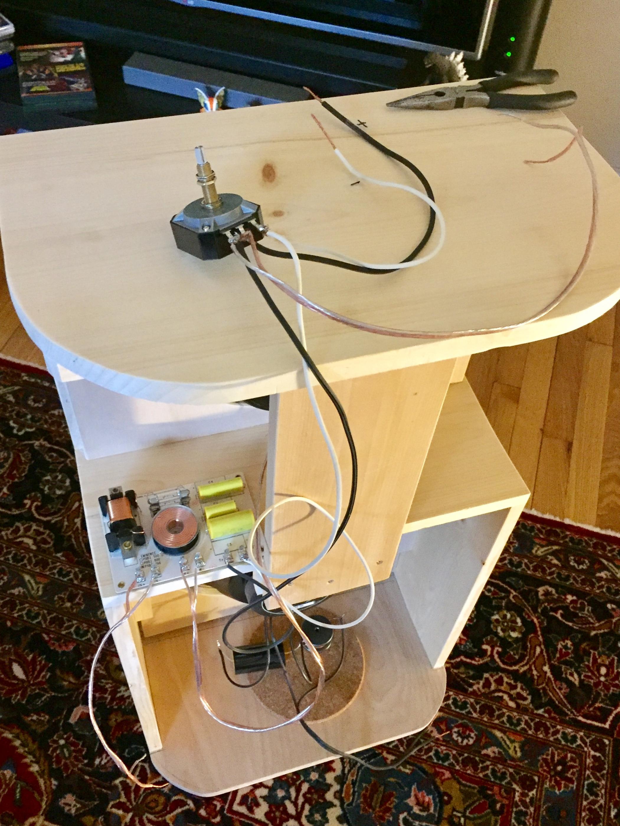

My Lil' Buddy on OB is coming along nicely. Alpha 15 below. I am experimenting with compression tweeters and horns. This is a pretty innexpensive option using a Pyle PSD442 and the aluminum Selenium horn. It sounds great crossed at 1600Hz. I like it just fine. I also have the B&C DE250 everyone loves... it's a great tweeter.

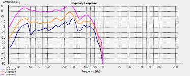

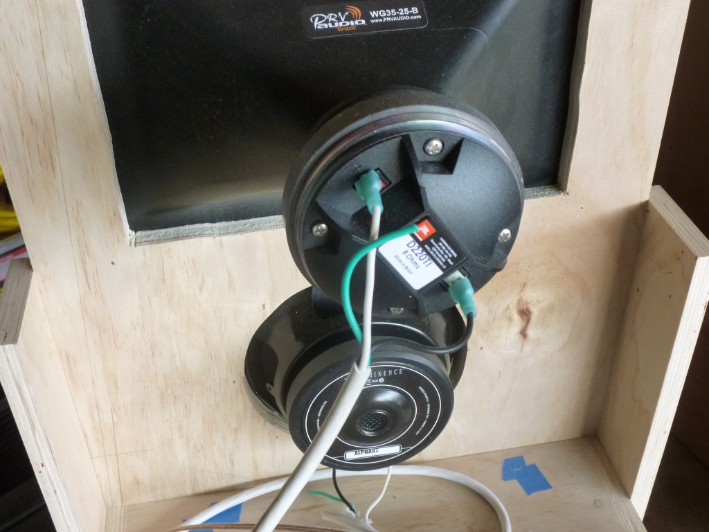

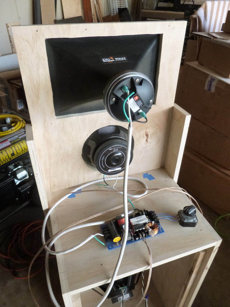

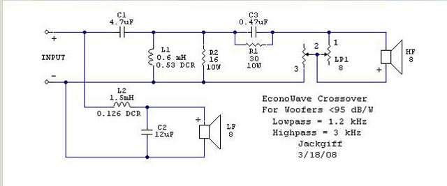

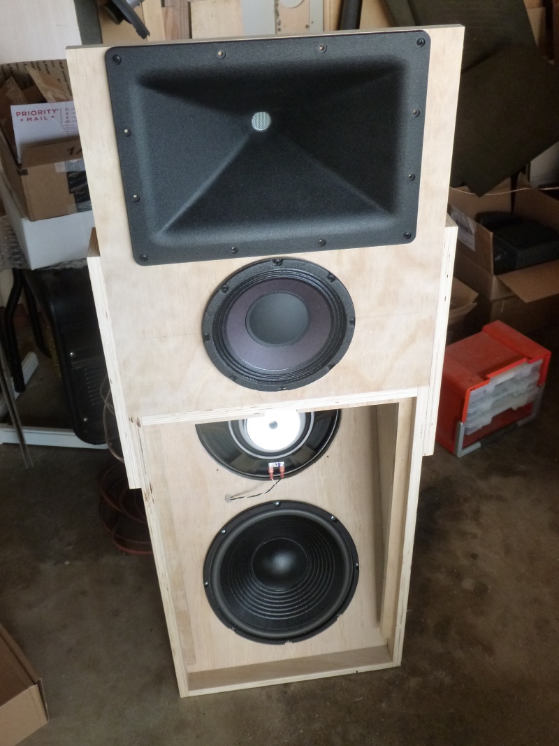

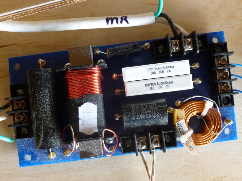

Here's my prototype OB using the Z-Frame (KaZba) that xrk971 was working on in another thread - although I didn't use the Karlson wings that he used. I thought it sounded better without them. So far I've only measured the woofers (attached).
Two GRS 12PF woofers
Eminence Alpha 8A
Selenium D220Ti tweeter
PRV Audio WG35-25-B waveguide (I also tried the Pyle PH612)
Zilch/Jackgiff Econowave x/o for the Alpha 8A and D220Ti

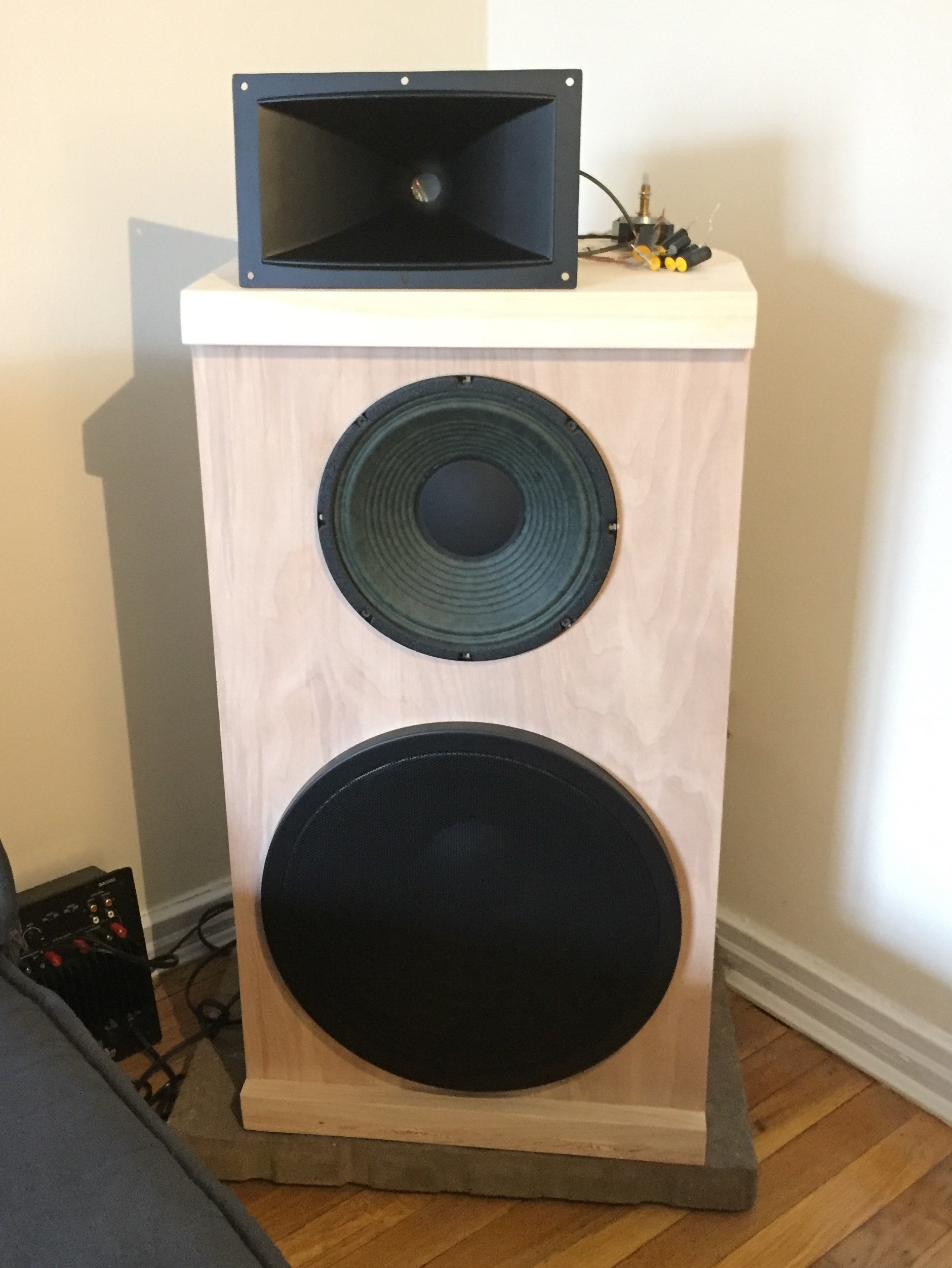

Kec, you and I are on a similar track. I took the easy way out by using a standard pre-built 1.6k crossover but the photo doesn't show the 6 capacitors connected to the L-pad to 'fix' the sound of the standard crossover. I have so many horn lenses including the PVR and the PH612 (which never seems to stay in my system long).
Here are measurements I made of various horns.
https://speakerprojects.wordpress.com/2016/12/30/waveguide-comparison/
How do you feel about the Eminence Alpha 8A? Every Eminence woofer I've tried (12lta, Beta 10A, Lil' Buddy and one of the 8" models available at PE (not the Alpha 8) always impress me... and I've been thru my share of Vifa, TB, Dynaudio, etc.
I'm beginning to think just about any decent woofer on open baffle sounds great as long as it has good support on top and bottom.
Joined 2002
I like the Alpha 8A. Pretty smooth.
I like the Alpha8A too. Always wanted to make a two way with their horn tweeter on an OB. The bare Alpha8A sounds nice but the Alpha 6A is better but looses out due to lack of low end on an OB.Eq is possible but not sure how that would sound besides restricting it's power capability. However both are very efficient and this may not matter much in actual use.
