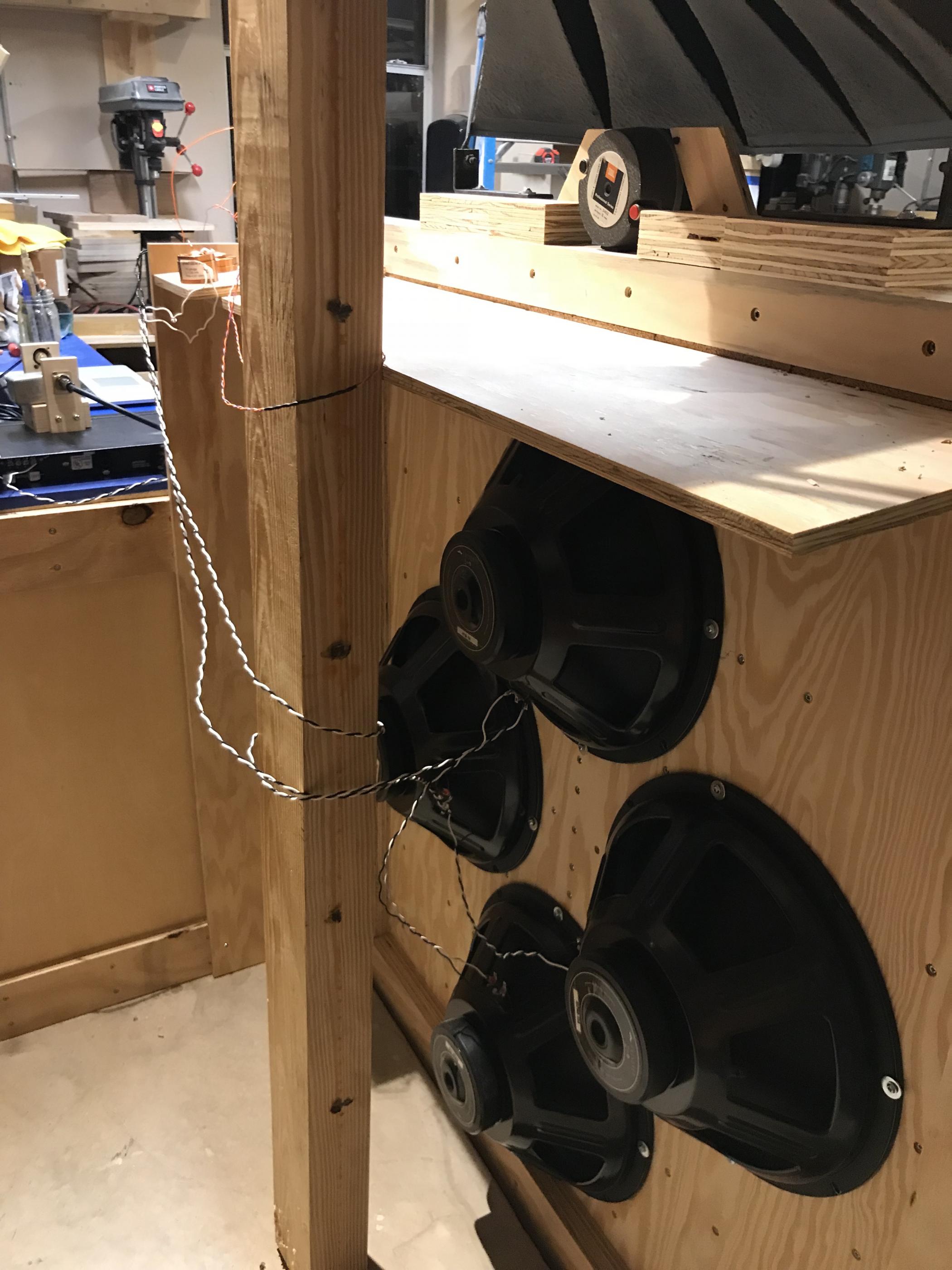

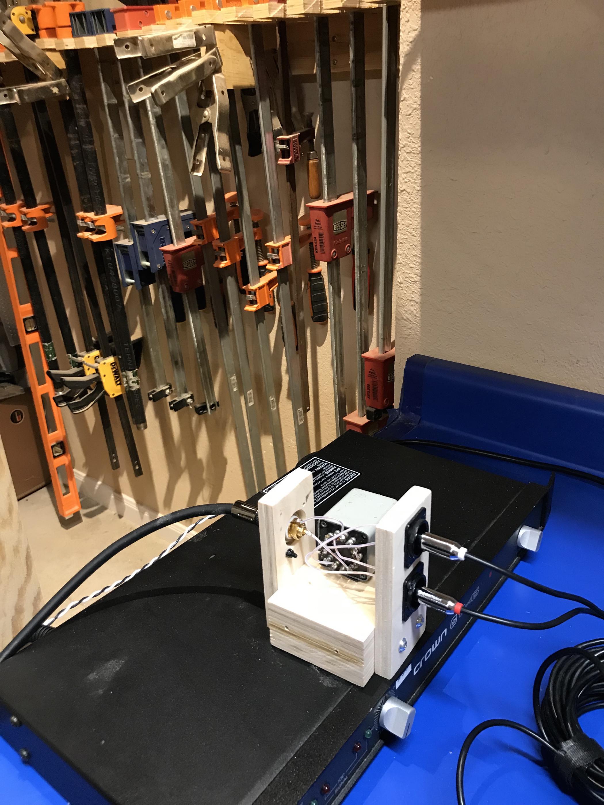

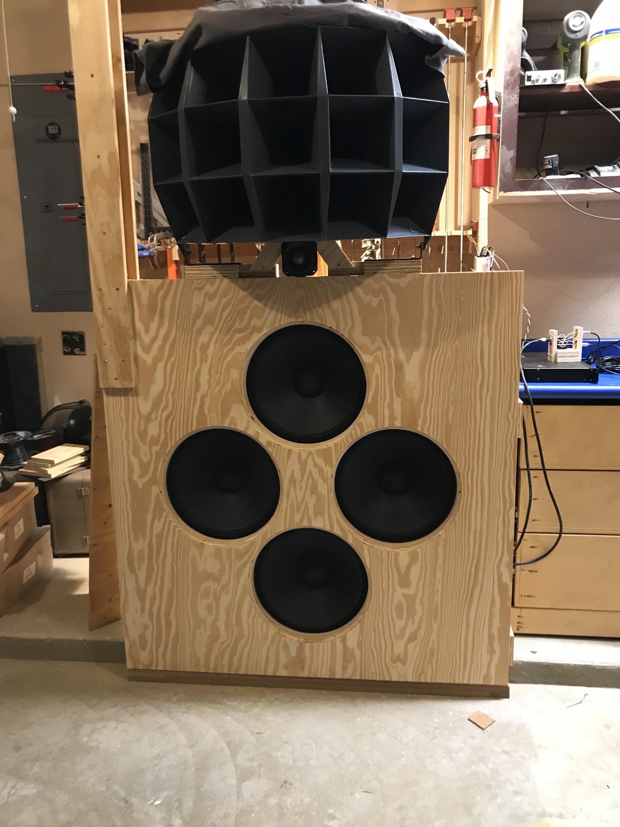

Recently I had the incredible luck of having an Altec 1505b and 288c fall into my lap for next to nothing.
The driver needed a new replacement diaphragm, so I ordered one from GPA, cleaned the compression driver, bug screen, etc. and put in the new diaphragm.
Always wanting a better system in my workshop I decided to build a mono rig there with the 1505b/288c covering ~500hz - ~8000hz, an alnico JBL 2402 handling ~8000hz and up, and 4 Alpha 15a's (series parallel) in a ~48"x48" baffle.
I am using a UTC A-20 to mix L and R signals from my iphone (streaming from Tidal) into a single mono signal. That's currently being fed into a Crown D-45 that's driving the rig. I plan to build a tube powered amp for the 1505 and 2402 combo and likely keep the crown for the open baffle.
The crossover is still being tweaked, hence all the wires, resistors(l-pads) and jumpers dangling all over the place.
I am very pleased with the sound, and frankly surprised how much I'm enjoying it. I may add side wings to the baffle, there is a small top 'wing' I added, mostly to mitigate dust falling down into the back of the 15a's.
The long beam going up on the left side of the baffle is a support that goes to the ceiling. I didn't want to put a support from the back of the baffle to the wall behind it as that would make it difficult for me to get back to my clamp storage 😀

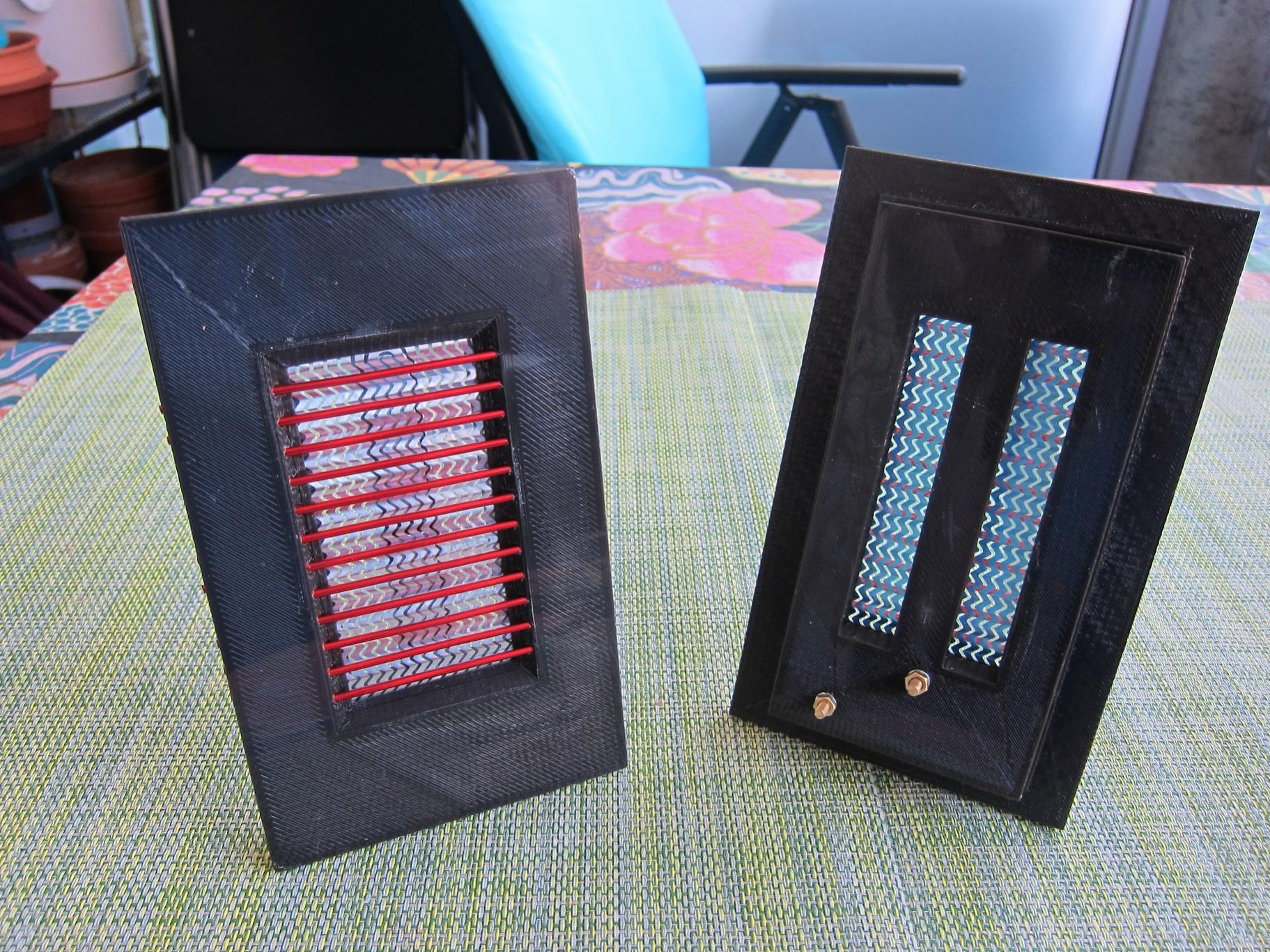

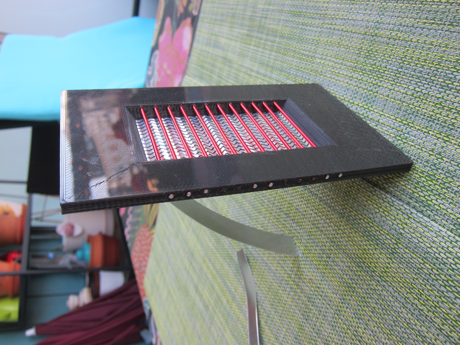

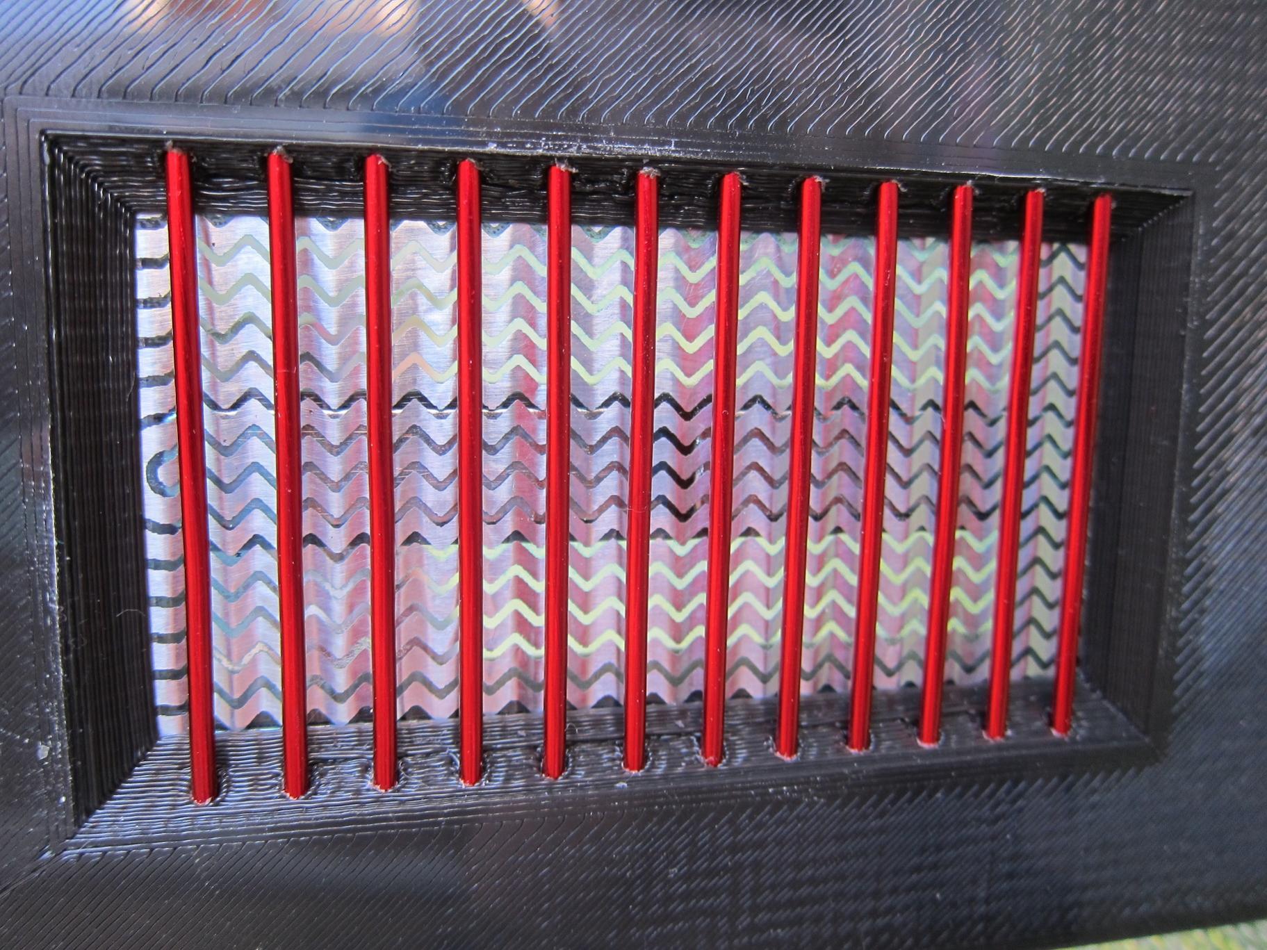

Here's some pictures of my new dipole tweeter. The membrane is made of 8 uM alu laminated to Mylar. Usable frequencies: 1,5 to 35 kHz.
It took me 3 years to come up with a method to produce perfect 5 ohm tracks!
The membrane is only attached at the short sides, which lowers the distorsion.
Cool possibility: Using the visible ends of the red protecting rods to indicate date of production in binary form!

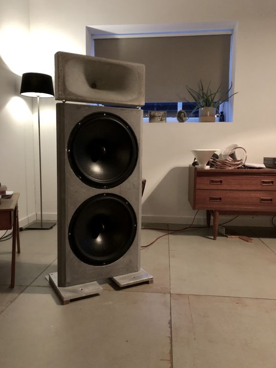

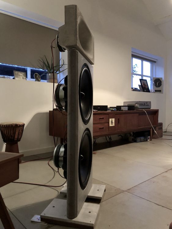

concrete open baffle
my first attempt making a open baffle
before this i owned the emerald physics cs2
never have build any speaker or open baffle before
so i am still learning and must have read al there is on open baffles on diyaudio forum .but still trying to wrap my head around it 🙂
for this one i just wanted to make something that could rattle the house but not the baffle 🙂 and looks cool also \at least i think it looks cool 😉
baffle and waveguide made out of concrete
drivers used are / ea dipole15/bms 4550 on a custom concrete seos 18 waveguide
active crossover and eq on computer
macbook logic audio and fabfilter pro q and rme ucf
my next one will be a 3 way by adding a midrange driver
work in progress.....😀

i used liquide silicone that i poured in the original waveguide
and before put some vasalin in the waveguide
and than i put the mould upside down and with wood made the outside contour
silicon does not stick on concrete so getting in out was easy
for the mounting of the driver i used a aluminium horn adapter cutted of the 1” screw pipe and put boulds in the 3 not used holes those are now fixed in the poured concrete
forgot to make pictures of the process 🙂
