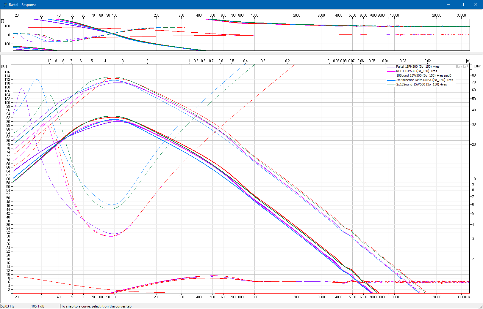

Here are some of the woofers I have simulated in my intended application (LR3 lowpass below 200hz). Some of them needed some impedance linearization. Still, the superiority of the 18W500 is quite obvious.
Yes, they are great! I've chosen them as midbass for my next OB. Don't see the time to start em.
The most amazing is to (re)discover all the "colours" of the mid-bass. The Alphas now seem to have a "one note bass" as someone has pointed before.
How can the 15pr400 work in open baffle with a qts around 0.32? Are you using active lf equalization?
I was sceptical in the beginning but I decided to give a try and I do not regret. Against all odds, it works fine. I also did some simulations with Basta! and the results encouraged the experiment.
Truly amazing the audible results, indeed.
Yes, a high QMS bass driver will give awesome midbass. And Midbass is where OB shine already.
Personally, I have never liked the Alphas. They are cheap and go low, but do nothing "best".
If you want the best LF OB driver, get the Dipole15/Dipole18 or OB15/OB18 from Acoustic Elegance. If you cannot afford them, use closed subs or several H frames of cheap 18" woofers. But with their poor Xmax the Alpha15A cannot really do much.

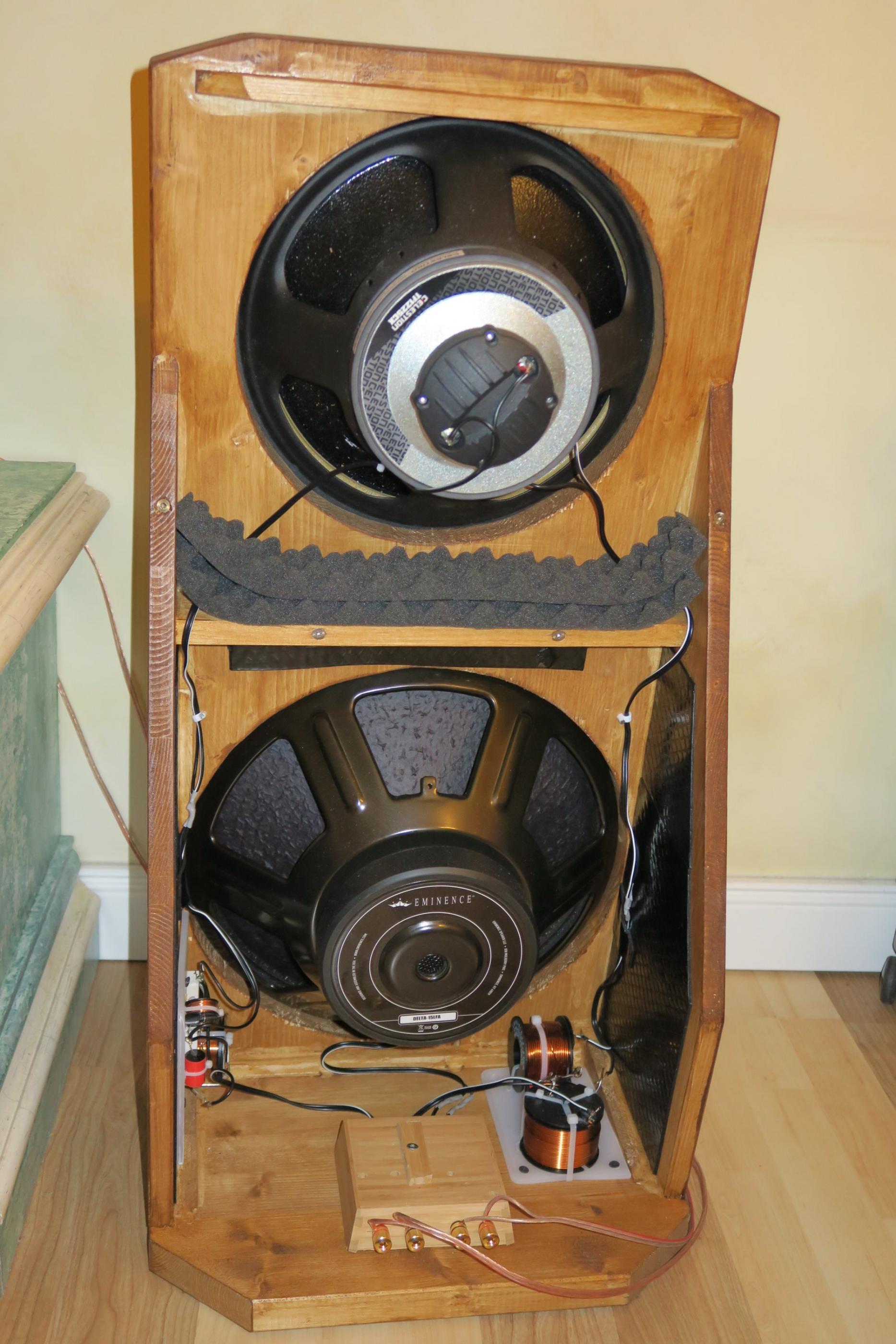

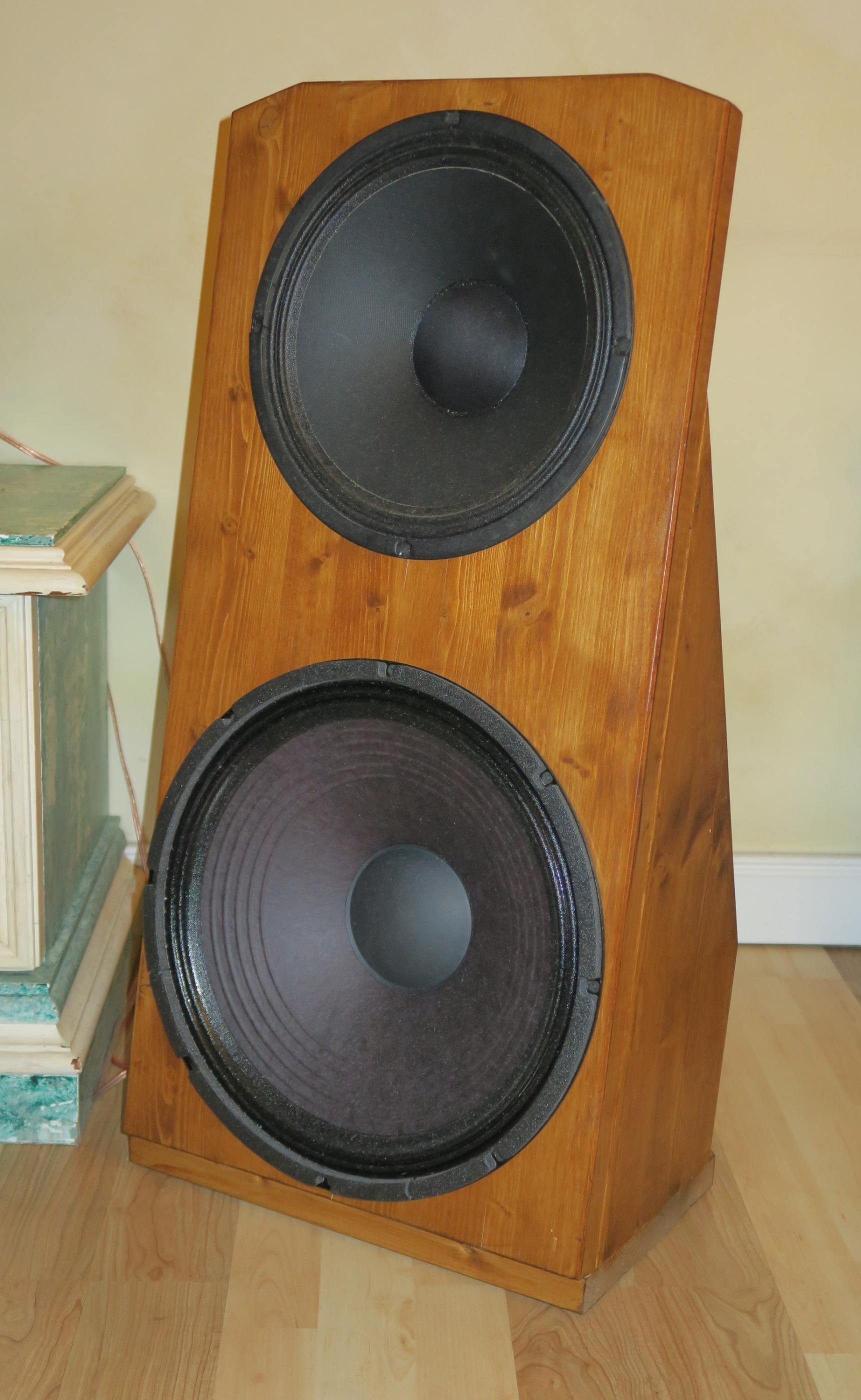

The first open baffle speakers for me. Front panel: 80x40cm (31" x 16").
Drivers: Celestion TF1225CX, Eminence Delta 15LFA.
Xo is a hybrid: between woofer and coaxial done with minidsp 2x4HD, coaxial crossed to compression driver passively. The passive xo is actually designed by German magazine Klang&Ton, K+T Celeste was their design.
Xo frequencies, woofer to coax: 250Hz, coax to CD: 1900Hz.

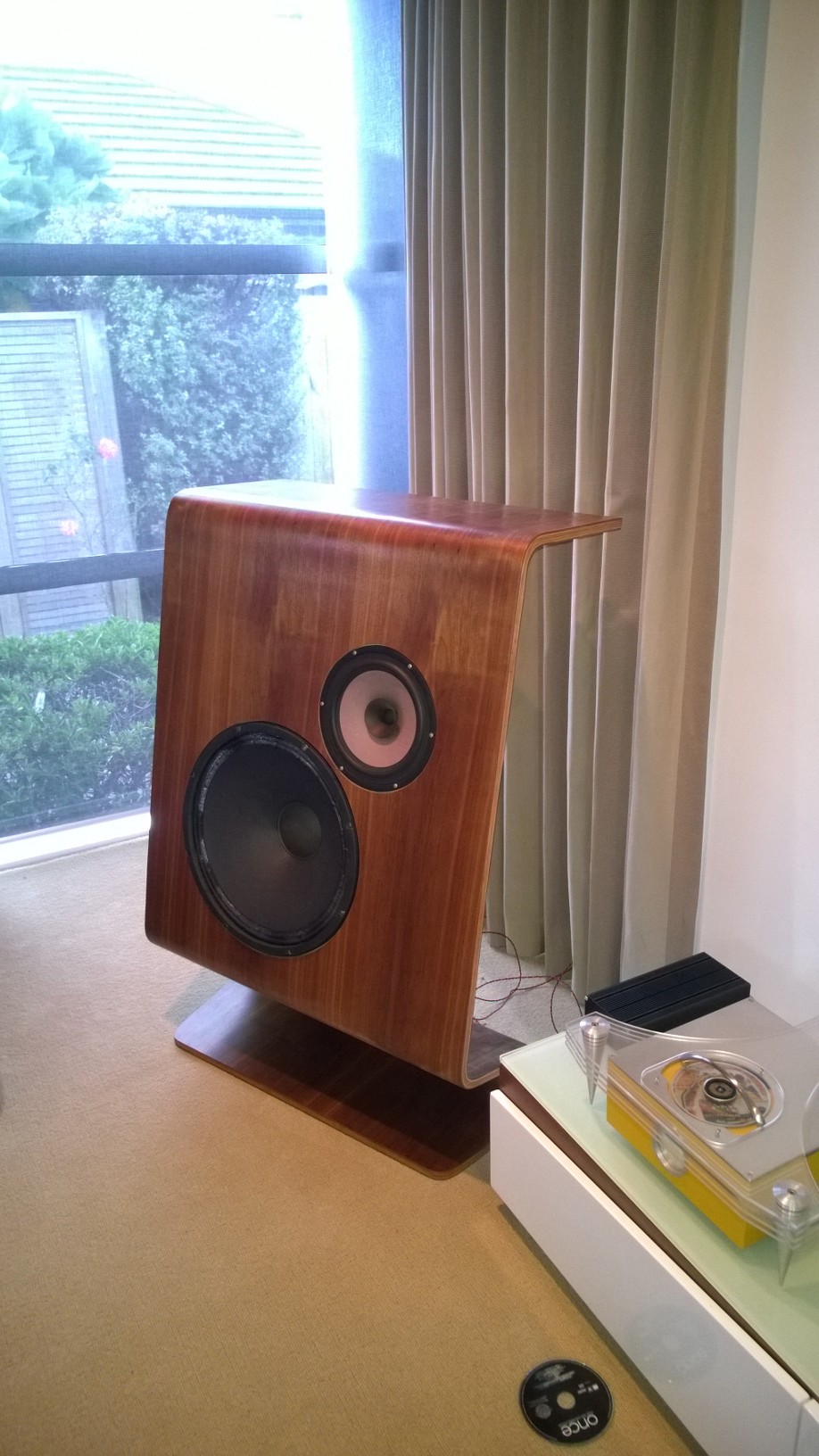

Looks like an Eames coffee table.Hi mikey_audiogeek,
Are those your speakers? If so, how did you make the baffles?
Simon
Could be room from clockwork orange 2Looks like an Eames coffee table.
Brilliant!
Dam. That's a superb looking design. Downright elegant. Is that a Kiwi original?
But how rigid is it? It looks like it would have high resonance in the Z plane to play its own tune. Better stick an accelerometer on it.
Thanks!
