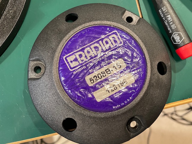

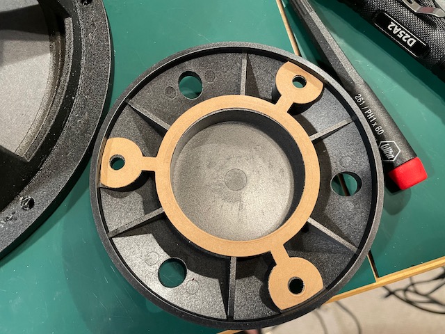

Alright, so I dragged the Radian 5208's out of storage... apparently, they're the older "B" rev, not "C", which tells you something about how long I've had them squirreled away... :shhh:
Wanted to get a look at the compression domes to see what size and material they were, and was surprised to find when I opened them up that the compression chamber has no damping material in it. Now, Radian surely knows what they're doing, but still, I'm thinking it might be a good idea to mod these with some kind of damping material to help squelch any chamber resonances before I set about measuring the speakers and fiddling with EQ stuff.
The other rather disappointing thing I noticed is that whatever material Radian used to cover the rear label, it is some kind of soft clear polymer, and it has taken a set while in storage, picking up all the wrinkles of the plastic bag it was wrapped in! Not too thrilled about what that has done to the aesthetics, but at least it shouldn't affect the performance, and if I'm lucky, maybe they'll relax back to a smooth flat surface over time. :sigh:

So the question is: what to put in the compression chamber, if anything, for damping? Some adhesive-backed felt, perhaps?
Has anyone tried this, and did it make a worthwhile difference?
I use adhesive-backed felt with RCF940. A very simple tweak. However, the experiment was not clean, at the same time I done the papier-mache cover for membrane. Together, these two tweaks worked well in my opinion, the top became cleaner and softer, without any artifacts in the measurements. My friend also noted the effect (he had an RCF950 and he knows the sound well).
